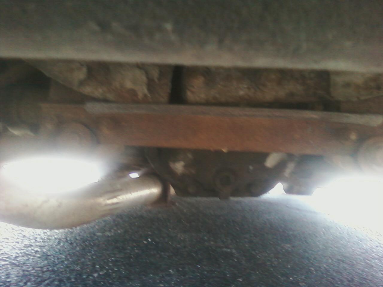

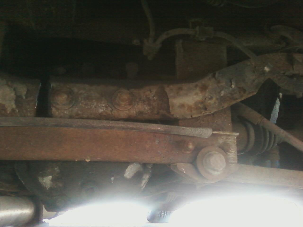

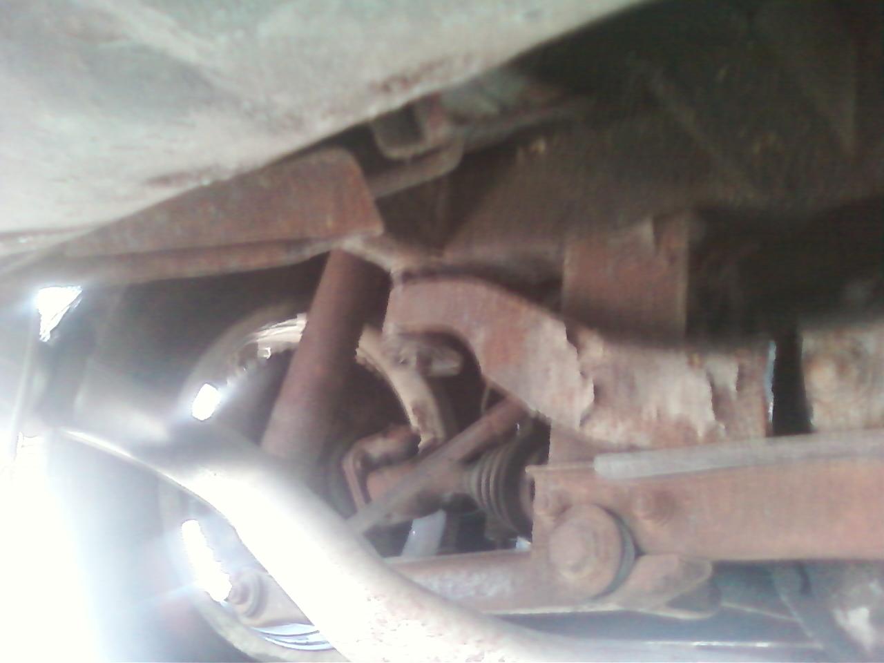

March 29, 201312 yr Author comment_419088 These pictures aren't very good, but you can see the break on the driver's side. It's pretty rusty. Unfortunately, there is a lot of rust in other places, so this may be the beginning of the end or a lot of replacements. Thanks, Jeff J. Link to comment https://www.classiczcars.com/forums/topic/46133-rear-suspension-bar-broken/#findComment-419088 Share on other sites More sharing options...
March 29, 201312 yr comment_419090 It's a spring (steel). It could have been abused before your ownership, causing stress cracks. IMO, this didn't happen from rust. The pictures suggest lots of surface rust on larger, substantial components, which means that rubber pieces are toast and fasteners will be a bitch to remove. This will very likely be a six-pack of PB Blaster, a torch, wire brush and the acceptance that you'll be facing a "while I'm at it..."70-78 DATSUN 240Z 260Z 280Z REAR DIFFERENTIAL MOUNT MUSTACHE BAR ""OEM PARTS"" on eBay! Edited March 29, 201312 yr by Willoughby Z Link to comment https://www.classiczcars.com/forums/topic/46133-rear-suspension-bar-broken/#findComment-419090 Share on other sites More sharing options...
