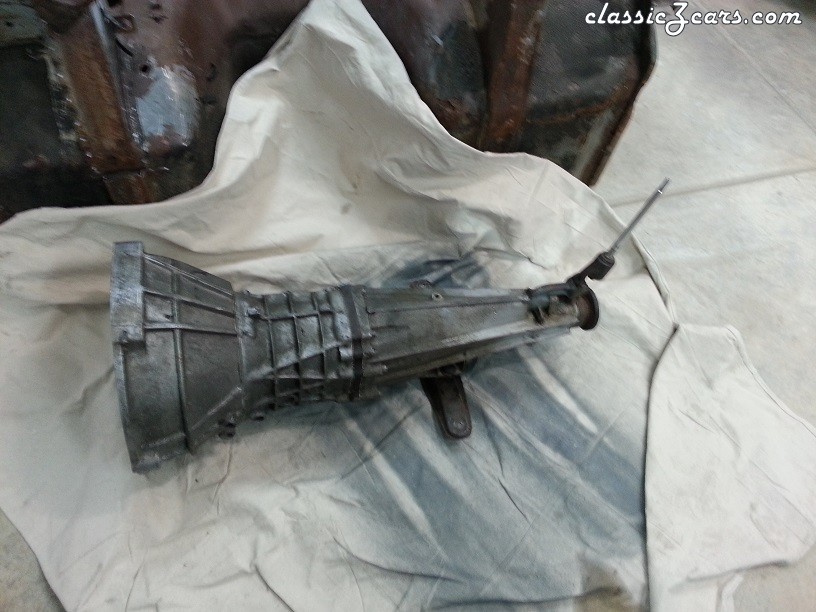

April 7, 201311 yr Author comment_419756 Thanks for the tip, I'll try hitting borini63 up with a PM.So the tranny came out of a 240Z, not sure if its a Roadster box or an actual JDM Fairlady/Skyline 5 speed. No way to tell that I know of. But its ready to go in, if I could only find that darn yoke. Thanks again! Link to comment https://www.classiczcars.com/forums/topic/46194-fs5c71a-front-driveshaft-yoke-needed/#findComment-419756 Share on other sites More sharing options...

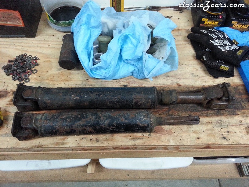

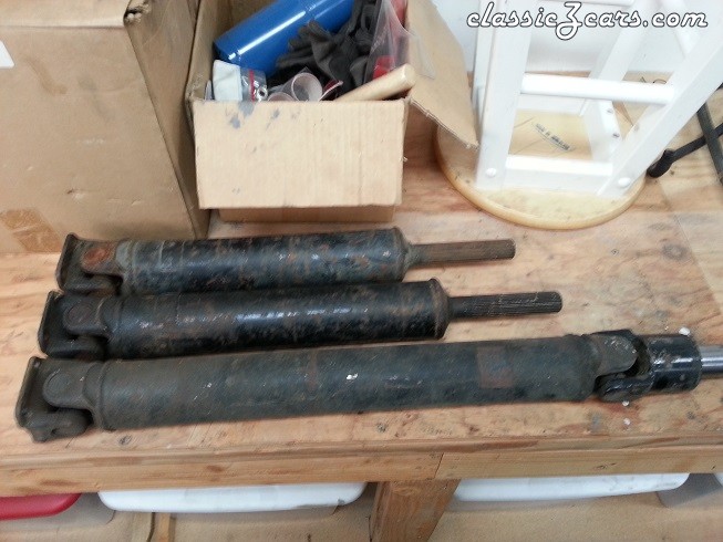

April 7, 201311 yr Author comment_419800 Yeah, this is the one in Union City. Here's a couple pics to clarify the driveshaft yoke part I need. On my bench are three drive shafts, the two that came with the trans and the original from my 71'. Notice the forward half of the 5 speed shafts are missing. I was looking into the possibility of getting the front half of a 4x4 truck shaft but it appears to be a different design with larger splines. Link to comment https://www.classiczcars.com/forums/topic/46194-fs5c71a-front-driveshaft-yoke-needed/#findComment-419800 Share on other sites More sharing options...

April 7, 201311 yr comment_419803 Are you sure that the original one from your 71 won't work? Odds are fair that it might. You might have to remove the dust cover.When you said "yoke" I thought that you meant just the piece that slips on to the trans shaft and has the u-joint in it. Some people call it the slip yoke. You're asking for the whole front half of a two piece drive shaft. I don't think that they exist for a 240Z.Someone out here has the answer. Link to comment https://www.classiczcars.com/forums/topic/46194-fs5c71a-front-driveshaft-yoke-needed/#findComment-419803 Share on other sites More sharing options...

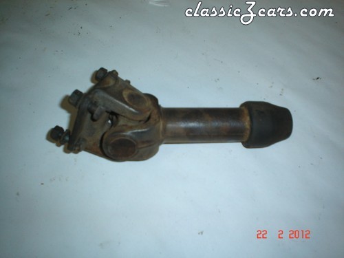

April 7, 201311 yr Author comment_419832 Yeah, didn't know what to call it. Its not really the yoke more like the front section of the driveshaft. Here is a pic I snagged off ebay of the part I need. Link to comment https://www.classiczcars.com/forums/topic/46194-fs5c71a-front-driveshaft-yoke-needed/#findComment-419832 Share on other sites More sharing options...
May 7, 201311 yr Author comment_422716 Got my front driveshaft yoke! For everyone's reference the front yoke from a 2000 Roadster driveshaft fist the early 240Z 5 speed driveshaft just fine. They appear to be the same part. Link to comment https://www.classiczcars.com/forums/topic/46194-fs5c71a-front-driveshaft-yoke-needed/#findComment-422716 Share on other sites More sharing options...
