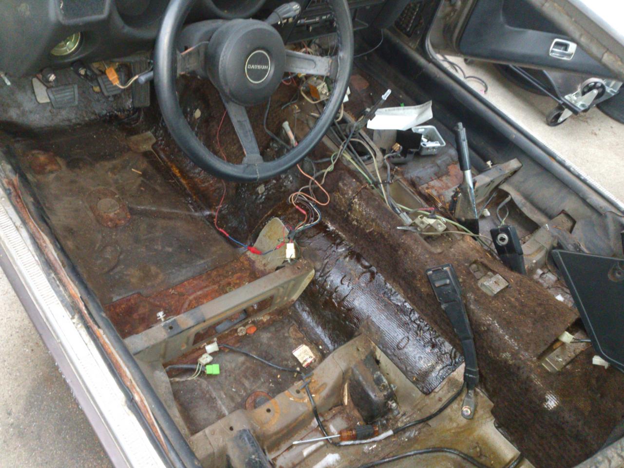

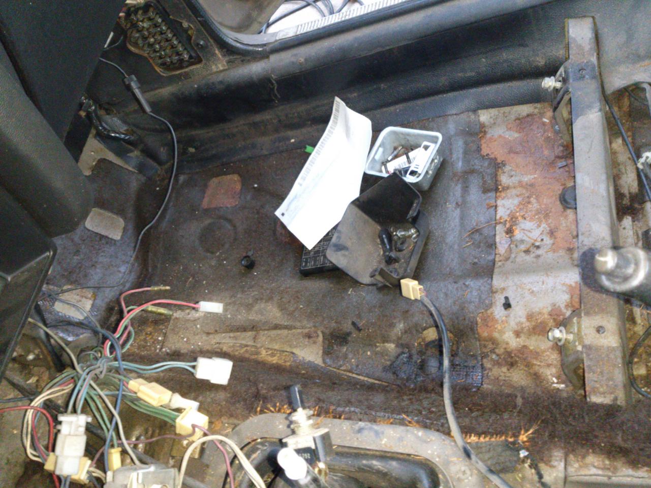

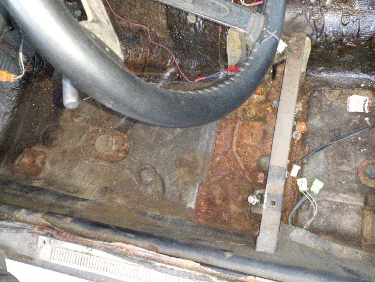

ok took seats out and unplugged connectors under driver and passenger seat.
Also went with multi-meter and checked starter for good connections from positive cable and ground cable (both checked out good.)
Double checked Fuse box all fuses good .
unplugged and plugged back in connectors on passenger side.
also unplugged seat belt connectors.
Battery hooked up to charger on starting mode.
Tried cranking and still no deal still zero volts going to spade on starter.

By the way, the scary part of your pictures is seeing the splicing in there. I wonder what the PO was doing.

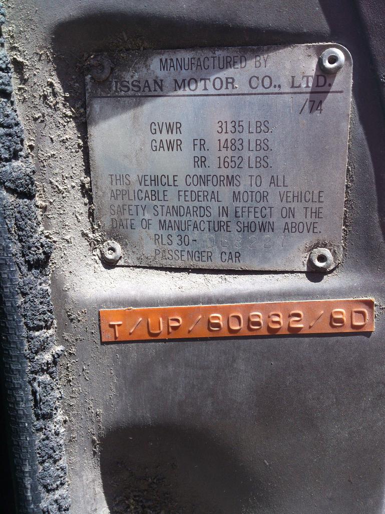

Also, it looks from your fusebox that you have a late 260Z. If you don't mind sharing, what is the build date on the VIN tag in the door jamb?
I have found that Nissan moved some components around between the early and late 260Zs. If people don't know you have a late car, they may tell you to look in the wrong place for certain components.
thanks for the info ill get a picture of the tag on the door .
I really have no idea what the po was doing to the car when i got to that mess i was really worried that something could have been messed up which would need alot more time to trace and find. my reaction was just *WTF is this*

Yep, you have an 11/74 build date. This is important for you to know. For example your gas tank is more like a 75 gas tank than a 73. That means you have to look for parts such as the sender, filler, vent hoses, etc. that will work for a 75.
