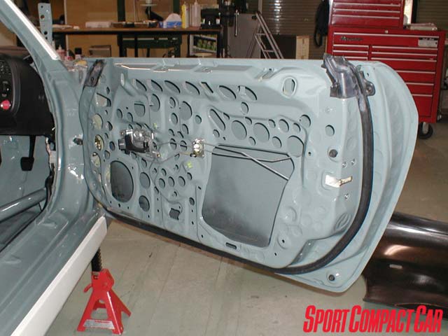

Stock interior door pulls had numerous 1/8 inch holes drilled on early race cars.
