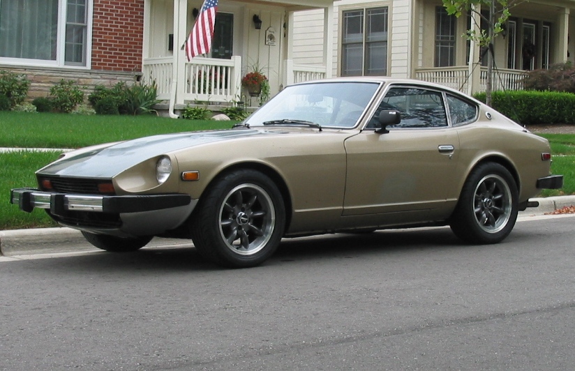

The picture below is my former car in its new home in Norway. It has the Rotas mentioned here with 205/55-16 Pirellis.
I have never seen that air dam before. Does it bolt onto the stock lower valance panels, or does it replace the stocklower valance panels.
On first glance it looks like you have plenty of room up there.
It's not my car anymore, and it had different wheels on it when I sold it. But Terje does run center caps, according to all the pictures he has posted.
I can't see the clearance from the picture angles you posted, but it looks encouraging. I also agree, that's an attractive but unusual air dam. I'd try 225/50 on that one, I think. 215/50 will look a little short and open up the fender gap.

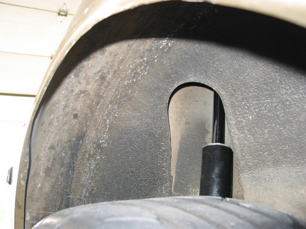

I run 225/50R16 on 16x7 zero offset Panasports and mine rubbed on all four corners. You are likely OK in the front if you go with +4 as Arne suggested, but in my case, even +4 would not have helped the rear rub. I tried to roll and when that didn't do it, I trimmed the flange by about 10mm.

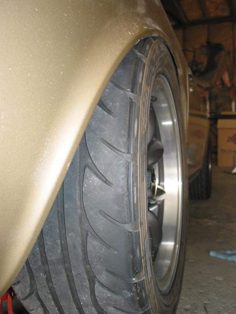

The first pic shows my clearance test with the spring removed. After trimming, the tire just clears the lip. The second pic shows the trimmed lip.
