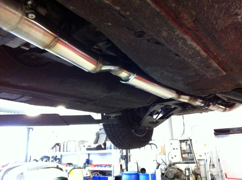

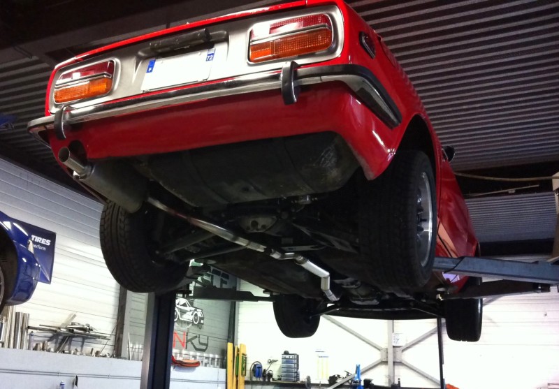

April 23, 201311 yr comment_421332 I had the MSA "turbo" exhaust with Dynamax muffler. The car was loud, ground clearance was bad (it could be due to poor installation - every pipe was welded to the other instead of being connected. I've redone the entire exhaust and I've installed a homemade glasspack in the transmission tunnel. Car is still very loud at WOT but much quieter on cruise & idle. Link to comment https://www.classiczcars.com/forums/topic/46267-shhhh-the-police-like-it-quiet/?&page=2#findComment-421332 Share on other sites More sharing options...
