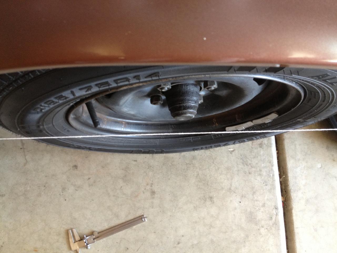

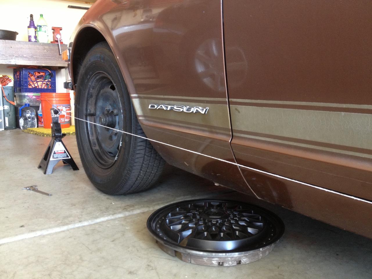

April 17, 201311 yr comment_420817 I just adjusted my toe-in this past weekend via the 'string' method. I ended up using the 2mm-5mm toe-in setting. Link to comment https://www.classiczcars.com/forums/topic/46288-toe-in/#findComment-420817 Share on other sites More sharing options...
