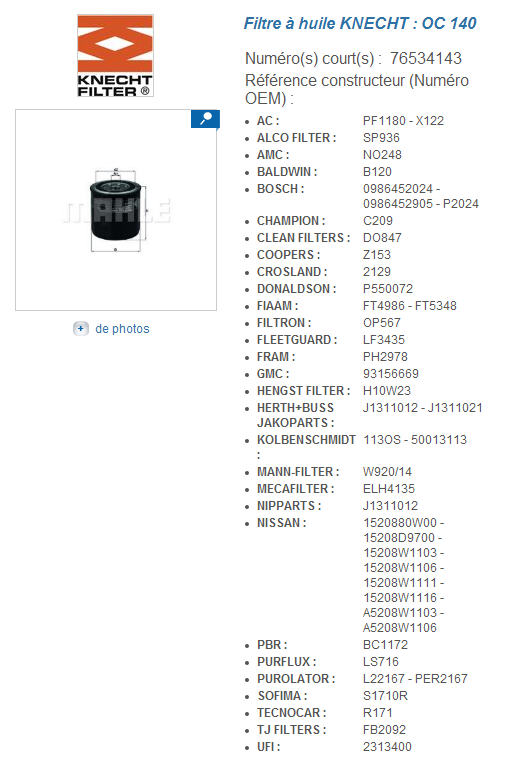

Last one, for oil filter, don't go to Nissan, go to any automotive parts store. You can also go online, get one reference and get the entire list of compatible products. Here's what I have when I look for 280zx filters. I like Mann Filter.

Thanks for the info, I'm pretty clear on wiring up the side lights, headlights and indicators, its getting rid of the day running lights that need thought. I'll have a go at the weekend. The point I was making about the oil filter, (oil filter given as an example, it's not something I need) is that local automotive stores here don't stock anything or even have any part numbers to any Z car (other than 300ZX). Maybe France is different. Having not had the car long, I still need to learn what's mechanical parts are interchangeable between the early and later Z cars.

Ok, I did not understand for oil filter.
Basically, in France, we either share spare parts, order on MSA or other webshops (rockauto mostly). We have deal with them as a club.

Thanks for the information with the filter number, I've noted it for the future.
