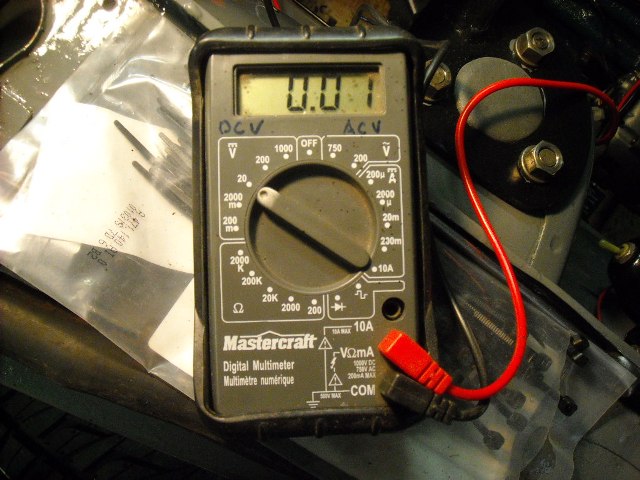

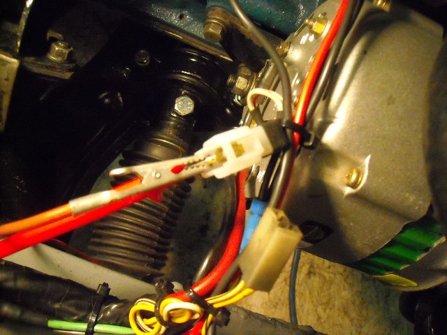

April 23, 201311 yr Author comment_421407 All, just tested voltage at the T connector alternator side, upper terminal of the T the yellow wire 0.00 v with ignition key on or off. Lower terminal of the T connector, alternator side the white w/black strip wire reads 0.01 v with ignition key on or off. This doesn't look good, the alternator is brand new Bosch unit from MSA. The power wire to the alternator still reads 12.66 v. Link to comment https://www.classiczcars.com/forums/topic/46324-engine-will-only-run-above-4000-rpm-carbs-or-timing/?&page=3#findComment-421407 Share on other sites More sharing options...
April 23, 201311 yr comment_421409 You want to test the other side, female, on the harness side. You have your clip on the alternator side. Link to comment https://www.classiczcars.com/forums/topic/46324-engine-will-only-run-above-4000-rpm-carbs-or-timing/?&page=3#findComment-421409 Share on other sites More sharing options...
April 24, 201311 yr Author comment_421415 You want to test the other side, female, on the harness side. You have your clip on the alternator side.Boy, it's nice you guys are so patient with me!Wiring harness side, ignition key off, white w/blk strip wire 0.00vWiring harness side, ignition key off, yellow wire 12.70vWiring harness side, ignition key on, white w/blk strip wire 12.00Wiring harness side, ignition key on, yellow wire 12.60v Edited April 24, 201311 yr by grannyknot Link to comment https://www.classiczcars.com/forums/topic/46324-engine-will-only-run-above-4000-rpm-carbs-or-timing/?&page=3#findComment-421415 Share on other sites More sharing options...
