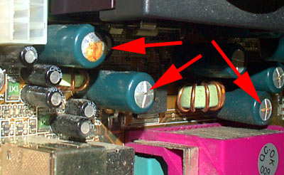

April 26, 201311 yr comment_421650 I just had those crappy caps with electrolyte from china show up in a friend's PC that he bought 4 years ago....I thought that game ended 10 years ago. Look for bulging tops and brown leaking. Just had some glass chipping in the cupboard when storing food storage containers on top of each other...also made in China. The crap coming out of that country is destroying confidence and is probably killing people....what if a cap in your distributor was the cause and it went out when passing a tractor trailer in a tight spot. Link to comment https://www.classiczcars.com/forums/topic/46328-first-time-ever-my-car-just-died/?&page=2#findComment-421650 Share on other sites More sharing options...

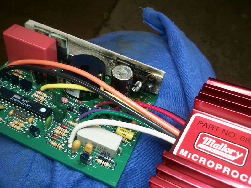

April 26, 201311 yr Author comment_421654 Update. In 12 minutes I had the new ignition module installed. It was kind of Mallory to put that piece of crap on top where it can be easily serviced. Well the car fired right up immediately and settled to a smooth idle like nothing ever happened. I also installed the Mallory protection box inline with it, and started the car again just to be sure. Yup still works. NO warnings on if the ignition module protector box needs protecting yet! Cone dodger, the new Cayman is positively georgous. It truely looks like nothing else (except the Boxster of course). The back end treatment really made the car absolutely perfect. It looks and reminds me of the Porsches of old. I will make a prediction here. I think Porsche is going to move the 911 up to a GT type of car soon, and the Cayman will be its new hot shoe. Link to comment https://www.classiczcars.com/forums/topic/46328-first-time-ever-my-car-just-died/?&page=2#findComment-421654 Share on other sites More sharing options...
April 27, 201311 yr comment_421683 Purchased the same Mallory Unilite on recommendation & module went bad In < 6 Mo driving. My understanding is that a significant portion of these distributers are now Manufactured in China & after inspecting the inards of my Mallory I can well believe that. Luckily(?) my module decided to go bad during the process of re-curving (I was swopping springs) - since discovered the modules are notoriously susceptible to eos/esd type issues. As i was planing more work on the Dizzy (= more handling of the unit) , I decided to go down the re-conditioned 280ZX route & purchased a recurved unit from a shop in ORE recommended by the guy's at Ztherapy. Find I can run with more advance (w/o pinging) than the Mallory stock setup - 19 idle, 36 total v previous 8 idle 28 total. Link to comment https://www.classiczcars.com/forums/topic/46328-first-time-ever-my-car-just-died/?&page=2#findComment-421683 Share on other sites More sharing options...
April 27, 201311 yr Author comment_421686 Well the beauty of the Mallory is you can recurve it at home with a simple recurve kit. It is infinitely variable. That is if you can keep it working.MSD needs to step up and make a better system.Or we can all just step up our game and go to a crank trigger and call it a day. Link to comment https://www.classiczcars.com/forums/topic/46328-first-time-ever-my-car-just-died/?&page=2#findComment-421686 Share on other sites More sharing options...
