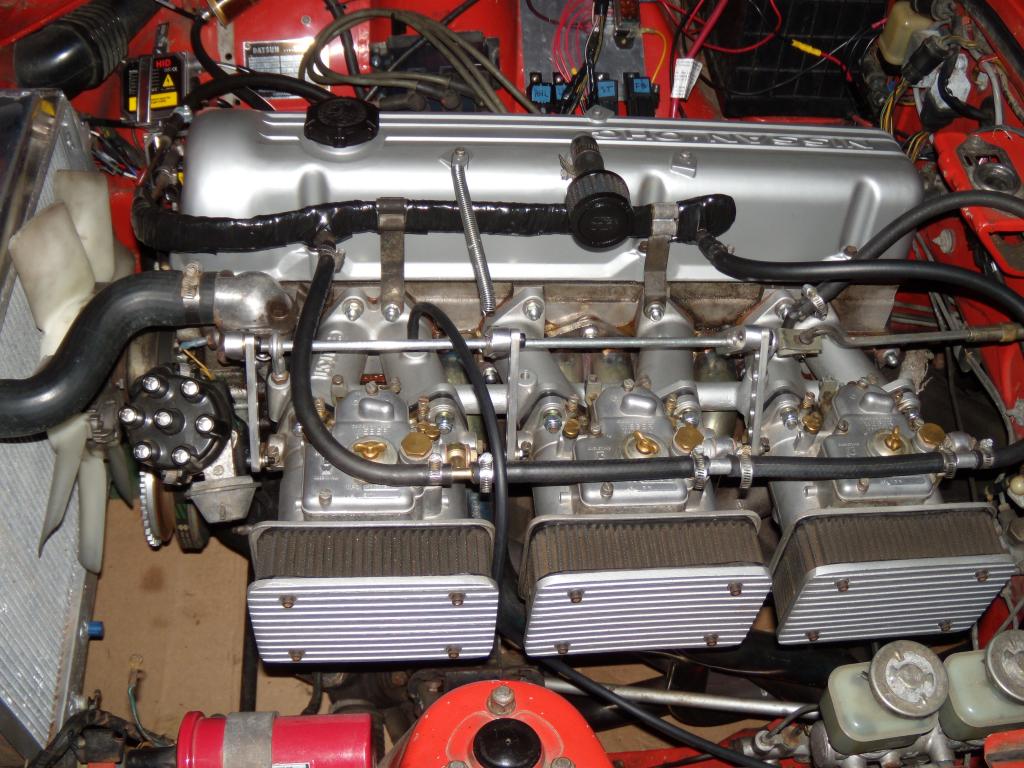

April 30, 201312 yr Author comment_421977 Leon, can you post pics of your setupTo me a crank trigger would be the bees knees Link to comment https://www.classiczcars.com/forums/topic/46328-first-time-ever-my-car-just-died/?&page=4#findComment-421977 Share on other sites More sharing options...

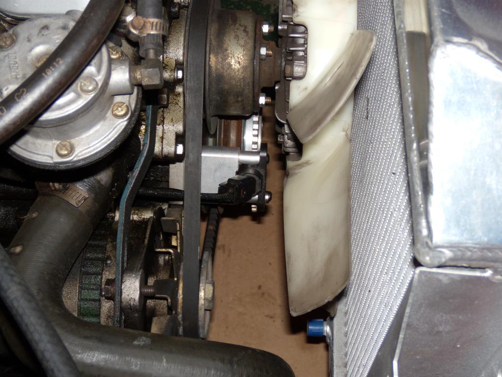

April 30, 201312 yr comment_422047 Zedyone_kenobi said: Leon, can you post pics of your setupTo me a crank trigger would be the bees knees You know, I don't think I've taken any good ones, just progress pics. I'll take some tonight. For now, here's a progress pic showing the syncronization of the trigger wheel to the engine (sensor offset). Link to comment https://www.classiczcars.com/forums/topic/46328-first-time-ever-my-car-just-died/?&page=4#findComment-422047 Share on other sites More sharing options...

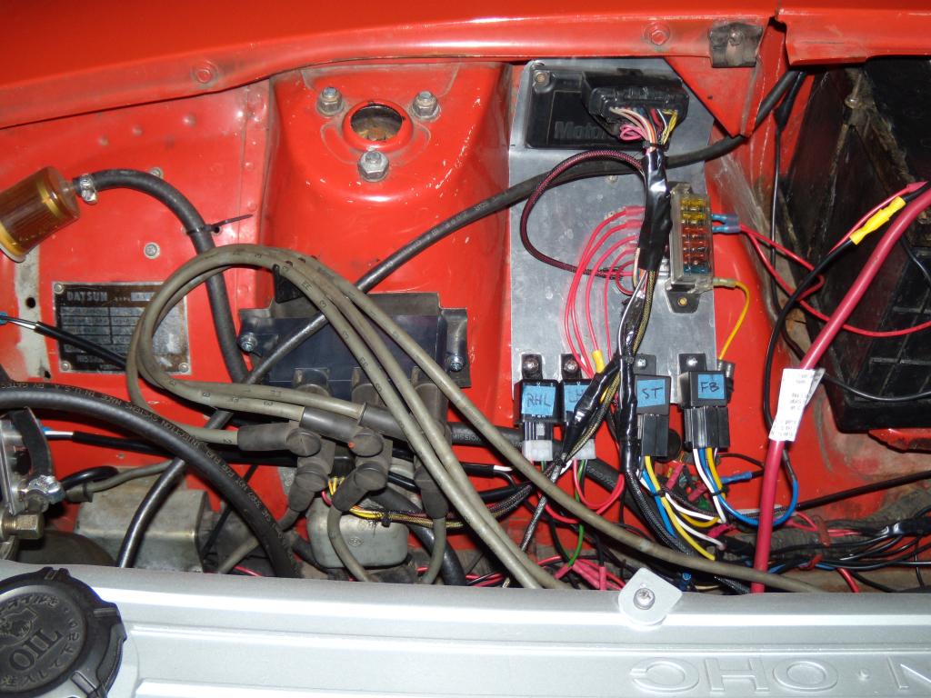

May 13, 201312 yr comment_423323 You know you want to Zedy... Still haven't cleaned up my wiring... Link to comment https://www.classiczcars.com/forums/topic/46328-first-time-ever-my-car-just-died/?&page=4#findComment-423323 Share on other sites More sharing options...
