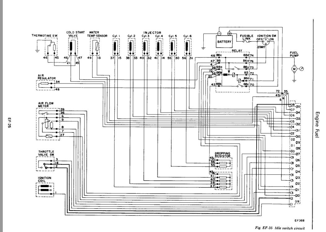

You can disconnect the fuel pump, have a friend crank the engine and see what the voltage is at the wires going to the pump. You can also actuate the AFM to see if the contacts are closing (Pins 39 and 36) to keep fuel pump relay energized.

I would test the fuel pump contact switch like SteveJ said first, moving the AFM flap, while the key is On. That will show you if the fuel pump contact switch is allowing the pump to get power when you let go of the key while Start'ing.

These two things seem odd. The first is just wrong, the AFM vane opening should not make the injectors click. If the injectors are clicking when you open the AFM vane something weird is going on with your wiring. I don't know where 77Datz ever read that that was normal. It's not.

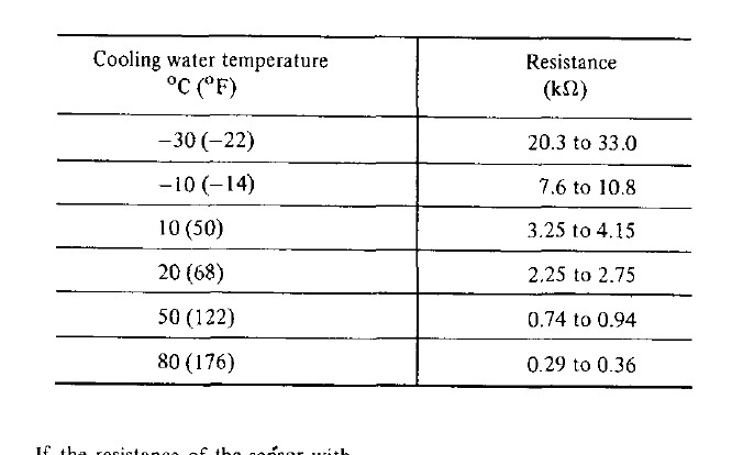

And the second thing is odd since there is no FSM test for power at the coolant temperature sensor, although it may get power from the ECU when the key is On. I don't know why anyone would do that test, the test is to measure resistance from the ECU connector. What was the voltage reading and how did you measure it?
So, the AFM causing the injectors to click is odd. But, the main reason for the engine to start the die immediately, is because the fuel pump contact switch is not being made in the AFM. You can test that also with an ohm-meter by measuring resistance at those two pins at the ECU connector and moving the AFM vane.
