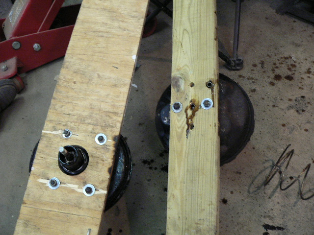

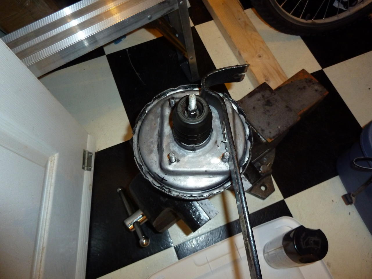

April 24, 201312 yr comment_421421 A board used like a lever while the front studs are bolted to another fixed board is best. I used a pry bar and vice. Link to comment https://www.classiczcars.com/forums/topic/46353-removing-brake-booster-back-plate/#findComment-421421 Share on other sites More sharing options...
