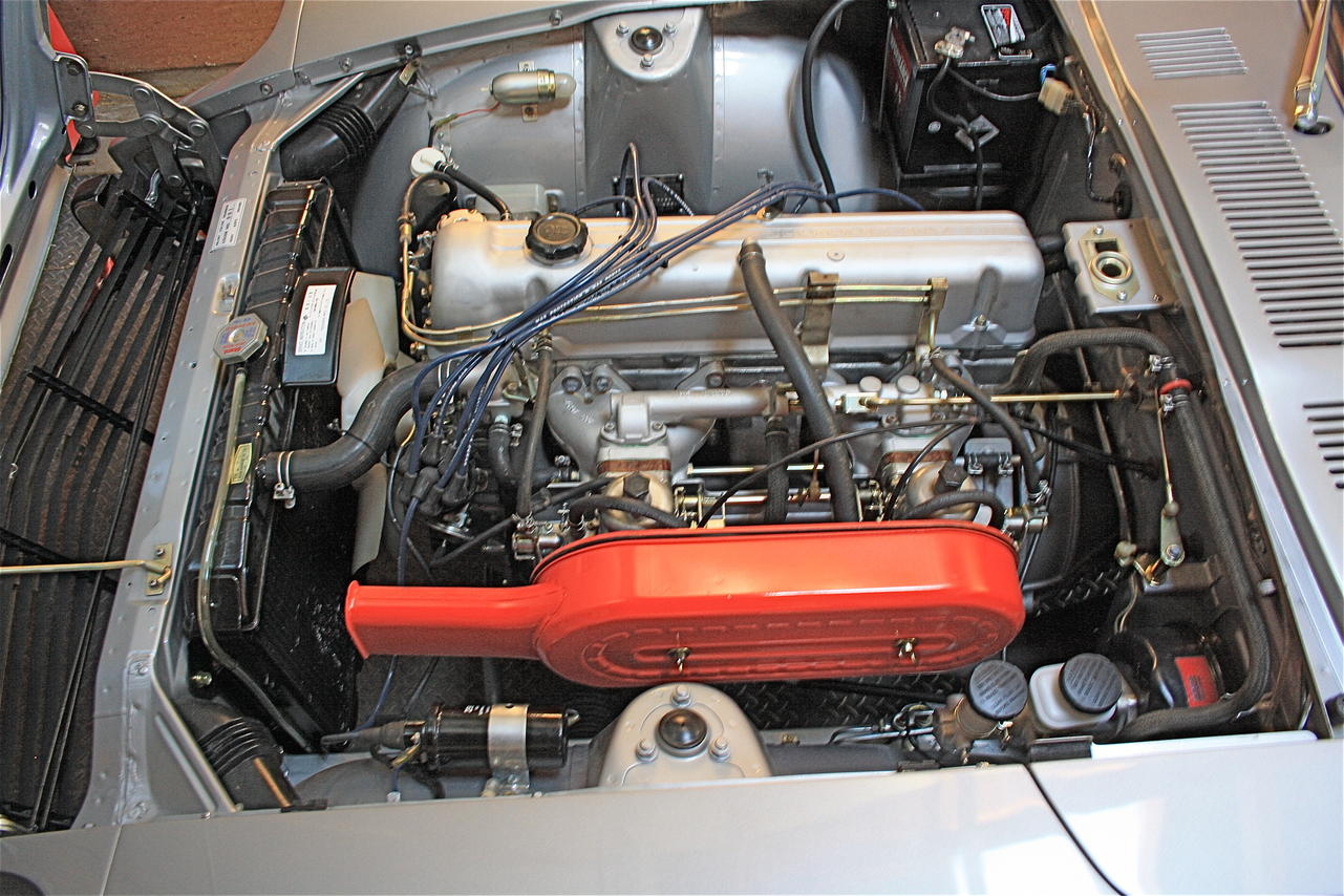

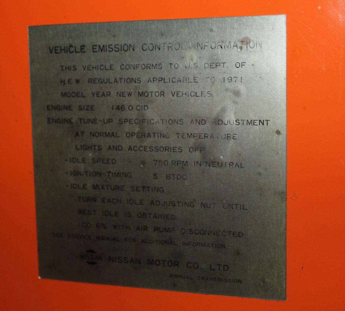

August 20, 201410 yr comment_453825 Dan, Not sure if you are still looking for info on this, but here is a picture of the original emissions sticker on my car, as we discussed earlier they are both Canadian non-emissions cars and very close in S/N. I am quite confident that this is the original sticker as the underside of the hood has never been repainted. It's strange that the sticker mentions an air pump but my car definitely didn't have one. HTH Mike Link to comment https://www.classiczcars.com/forums/topic/46386-correct-decals/#findComment-453825 Share on other sites More sharing options...
August 20, 201410 yr Author comment_453837 Mike: That is odd, I am sure there was never a underhood decal on mine. I do not think it ever had a repaint under the hood and I could not see any sign of glue or less faded paint in the sticker area before I had it painted. Dan Link to comment https://www.classiczcars.com/forums/topic/46386-correct-decals/#findComment-453837 Share on other sites More sharing options...

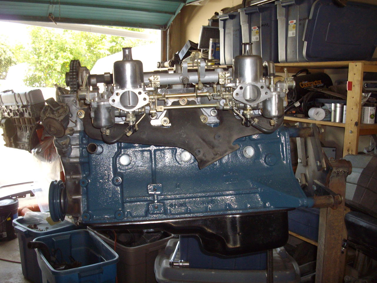

August 21, 201410 yr Author comment_453884 This is the best photo of the manifold I have. It has the flat spots for the air tube but no holes and as well the are casting holes for the heat riser but they are not tapped. As well,here is how it looks with no air cleaner decals Edited August 21, 201410 yr by 240dkw added photo Link to comment https://www.classiczcars.com/forums/topic/46386-correct-decals/#findComment-453884 Share on other sites More sharing options...

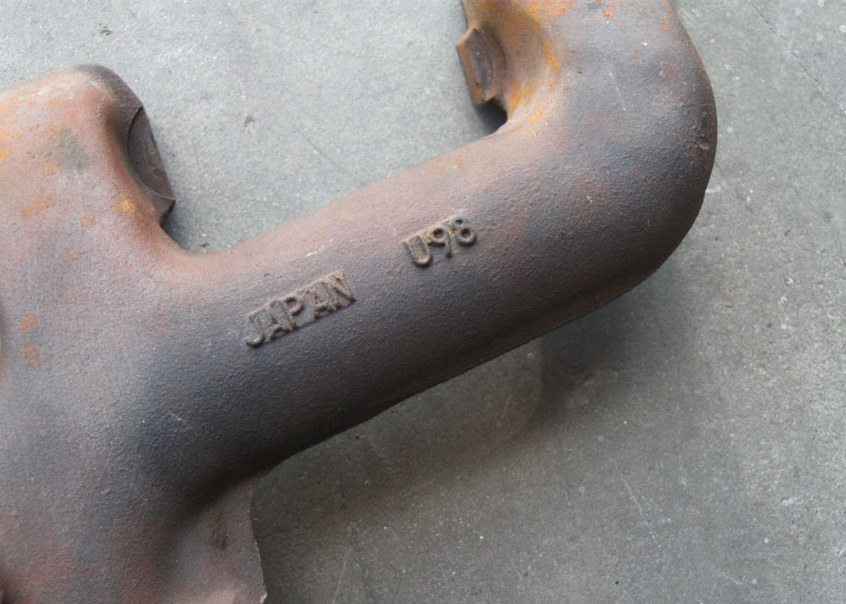

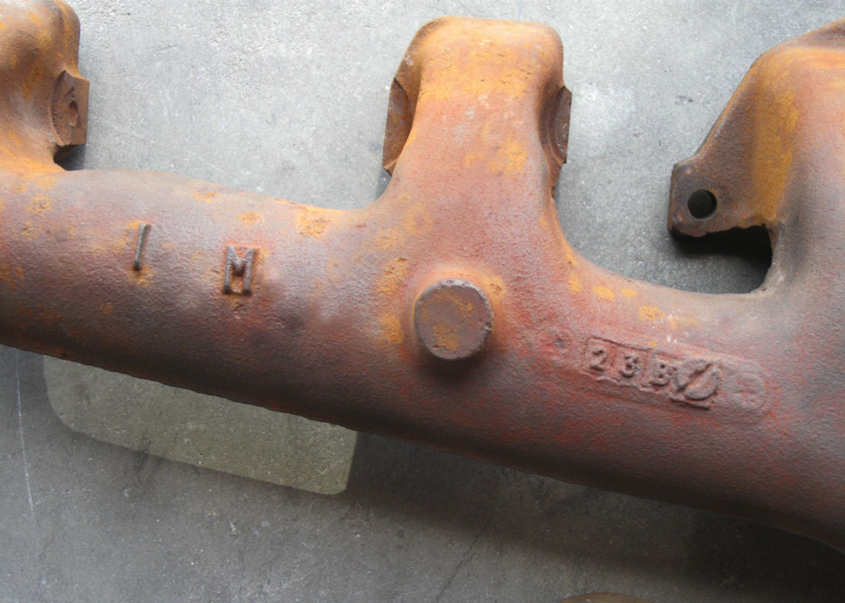

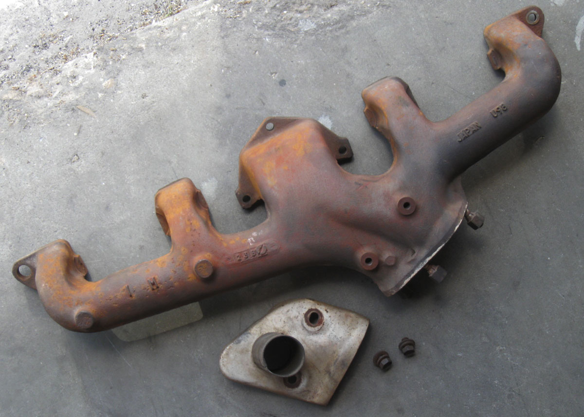

August 21, 201410 yr comment_453894 Hey 240dkw! Great picture of your "early" carburetors. I would bet that your air filter housing did not have any decals like mine. Here are pictures of the non-emission exhaust manifold. Link to comment https://www.classiczcars.com/forums/topic/46386-correct-decals/#findComment-453894 Share on other sites More sharing options...
