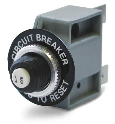

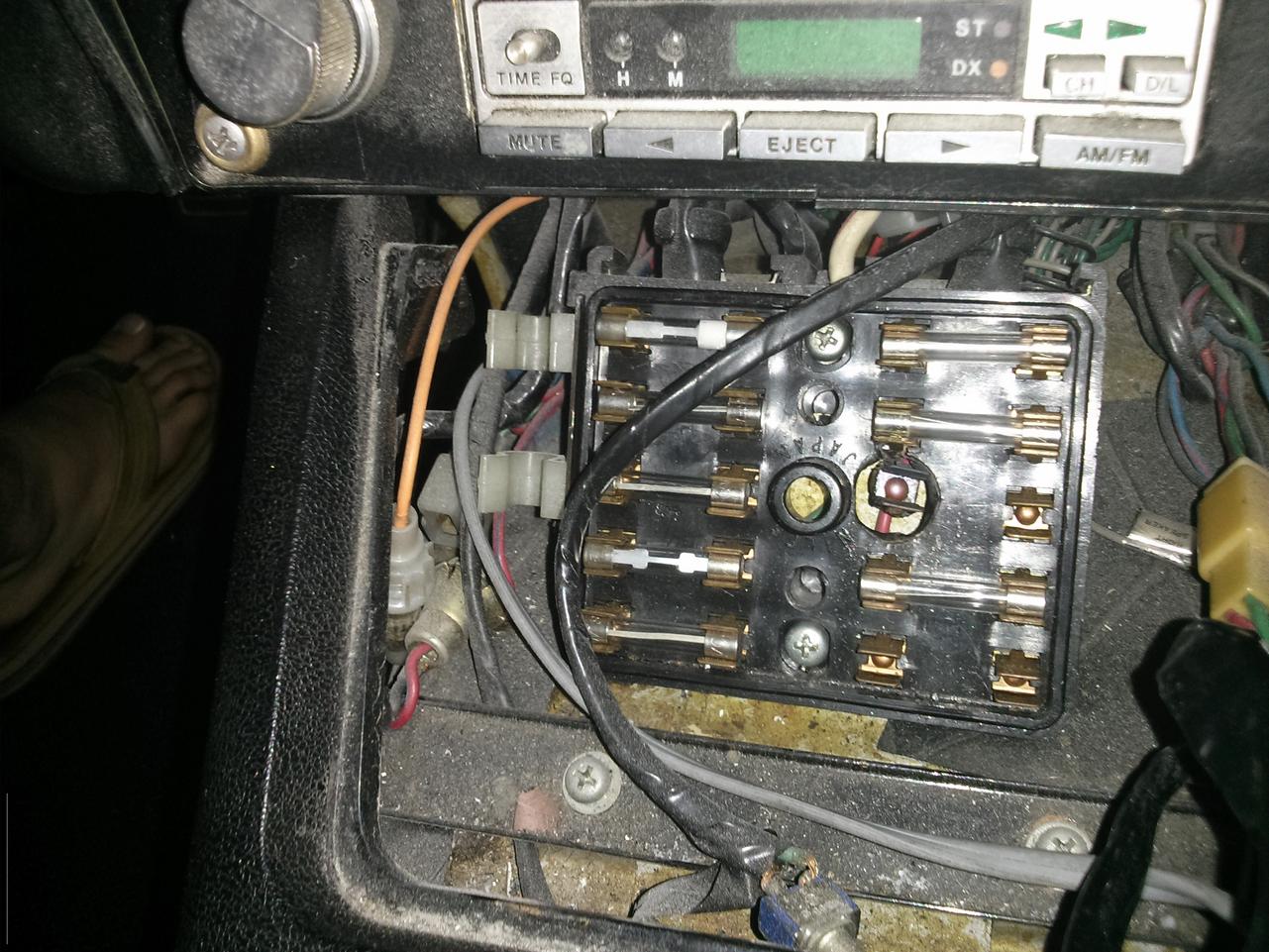

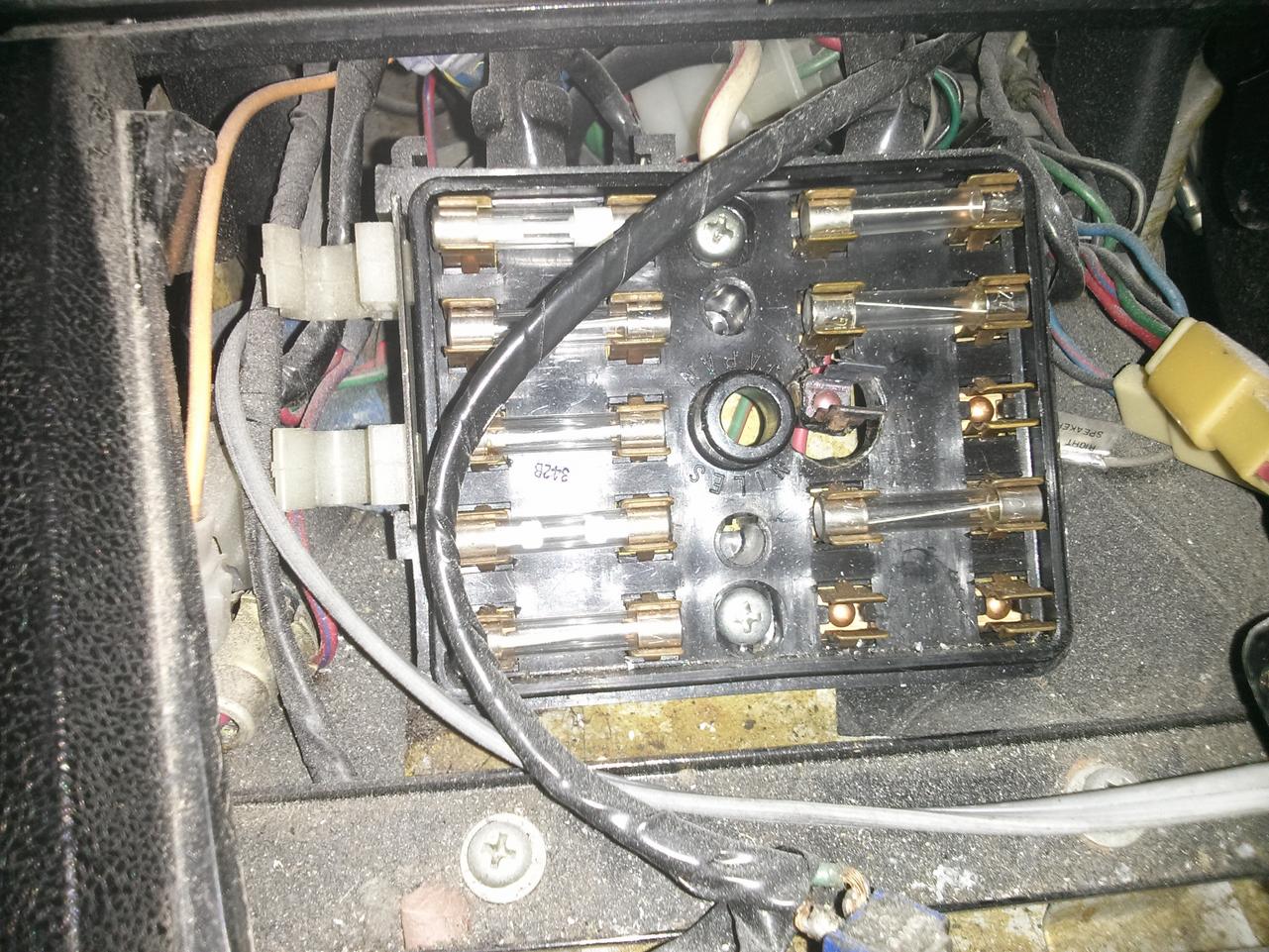

Posted April 30, 201312 yr comment_421974 So, I am having some problems with my turn signal fuse. It seems it somehow blew out and is now blowing out fuses all the time. It actually melted off the original fuse holder and is being a PIA to fix. I was thinking of just pulling the wires out and putting in a panel mounted Here's the breaker I'm thinking of wiring it to . . Link to page Do you think this would resolve the problem? Link to comment https://www.classiczcars.com/forums/topic/46410-fuse-problems/ Share on other sites More sharing options...
April 30, 201312 yr comment_421975 Fuses blow due to a current load in excess of the fuse rating. This is a problem with a something on the circuit drawing more current than it should, like a short circuit to ground or a series of corroded connections. No fuse upgrade will solve it, you have to find the cause of the problem. The fuse is just a safety valve. This is a very common fuse to get overheated. Start by thoroughly cleaning the fuse connection holders, then work backwards cleaning all bulb sockets on all lights that this fuse powers, and their associated connections. Bad connections = resistance = heat generation. Happy scrubbing. Link to comment https://www.classiczcars.com/forums/topic/46410-fuse-problems/#findComment-421975 Share on other sites More sharing options...
April 30, 201312 yr Author comment_421982 What should i use to scrub the pieces?I know that I bought some new bulbs from ebay, and on the bottom they only have 1 dot, where as the ones they replaced had 2 dots. Could this be the problem as well?Also, I figure it would be a good idea to replace the fuse with a breaker so as I test, I don't go through 20+ fuses :-) I could just press it back in to begin testing again. Could save me some $$ on fuses. It would also rule out the fuse connectors as the problem. Just my thinking . . . what do you think? Link to comment https://www.classiczcars.com/forums/topic/46410-fuse-problems/#findComment-421982 Share on other sites More sharing options...
April 30, 201312 yr comment_421984 What should i use to scrub the pieces?I know that I bought some new bulbs from ebay, and on the bottom they only have 1 dot, where as the ones they replaced had 2 dots. Could this be the problem as well?That doesn't help. You're crossing circuits by doing that. "1 dot" Type 1156 bulb"2 dot" Type 1157 bulb aka dual filamentDon't cross the streams.Also, I figure it would be a good idea to replace the fuse with a breaker so as I test, I don't go through 20+ fuses :-) I could just press it back in to begin testing again. Could save me some $$ on fuses. It would also rule out the fuse connectors as the problem. Just my thinking . . . what do you think?I think you should learn to use a multimeter and check the resistance in the circuit. You could have a short in circuit. Rule that out first. If you look on my blog, I have a post about electrical troubleshooting, including a link to a video on how to use a multimeter. Link to comment https://www.classiczcars.com/forums/topic/46410-fuse-problems/#findComment-421984 Share on other sites More sharing options...
