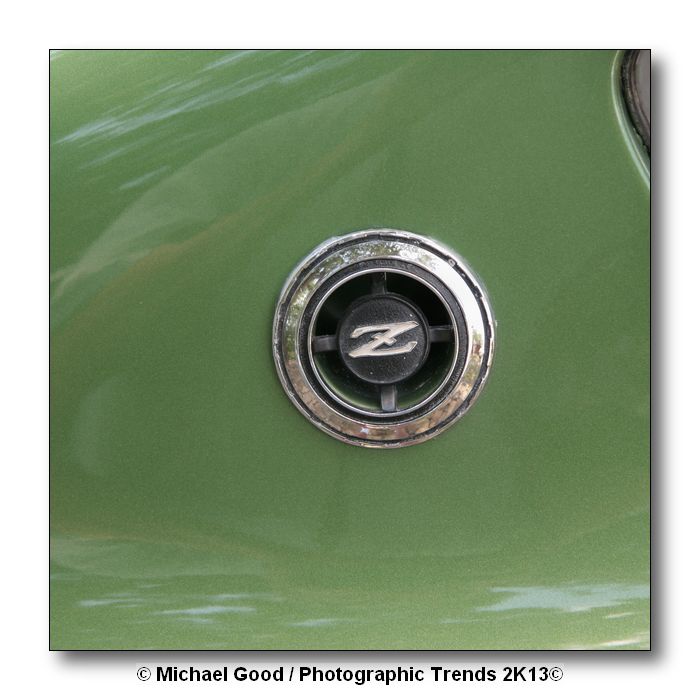

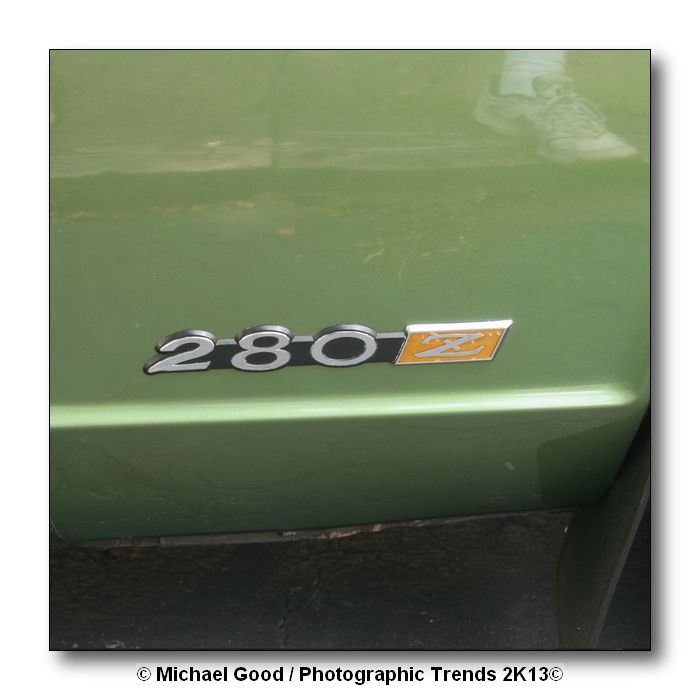

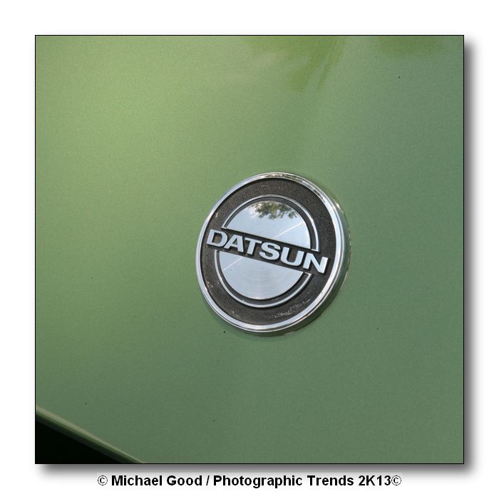

Here mine all original from a 11/75 - 1976 280Z.
The hood and the air vent are some kind of pot metal with chrome over them.
The side 280Z is plastic with chrome over it.
Hope this helps.

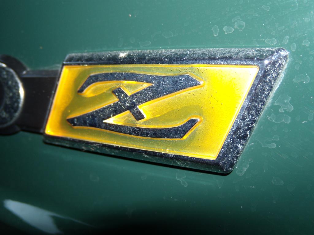

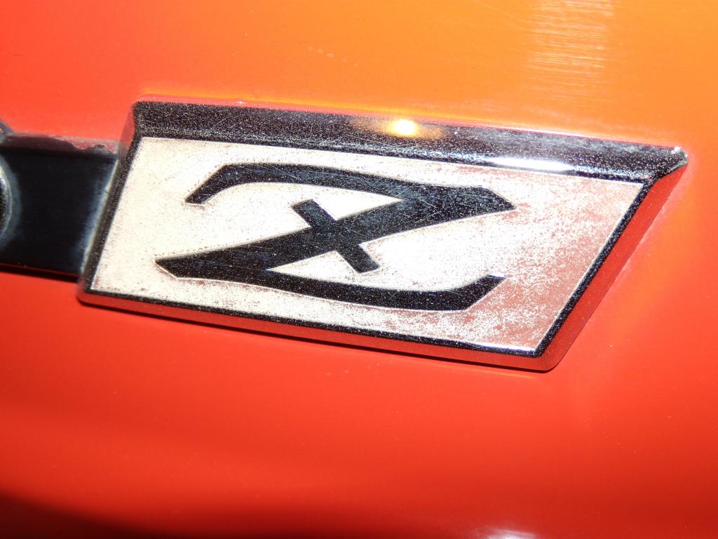

Mike, here are some pics. One is an old, worn emblem and the other is new. I should probably clean them...
Looks like it's injected into the part after the emblem itself has been made. I don't have any experience in making something like this though.
