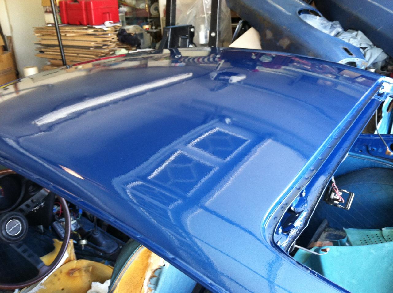

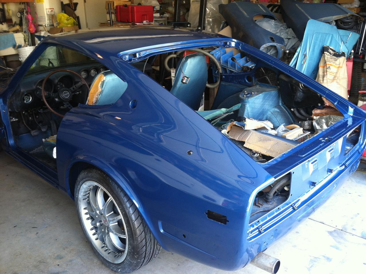

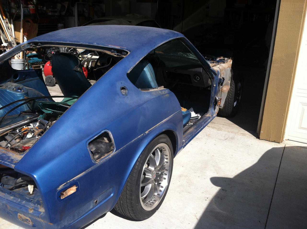

Posted May 1, 201311 yr comment_422173 Hi all, been working on the z for the last 3 months. Almost there. I need some advice on the weatherstrip kit. Any recommendation. Here are the pictures of before and after the paint job. Link to comment https://www.classiczcars.com/forums/topic/46432-1971-rebuild/ Share on other sites More sharing options...

May 2, 201311 yr comment_422253 always good to know there are s30's out there being brought back to life, especially earlier ones. Hows rust? btw, that paint job's looking great! Link to comment https://www.classiczcars.com/forums/topic/46432-1971-rebuild/#findComment-422253 Share on other sites More sharing options...

May 2, 201311 yr Author comment_422284 Taz, Do you have issues with the door rubbers not closing correctly from MSA. The windshield and hatch rubbers good fit?The car is 99% rust free, and only surface rust. Preparation took the longest and painting was fast. I used two epoxy primer sprays and sand between paint. Two color sprays, and 4 layers of polyurethane clear coat. Again sanding between coats. Once I'm done installing all the body parts, I will wet sand with 2000 grit sandpaper, then polish. Link to comment https://www.classiczcars.com/forums/topic/46432-1971-rebuild/#findComment-422284 Share on other sites More sharing options...
