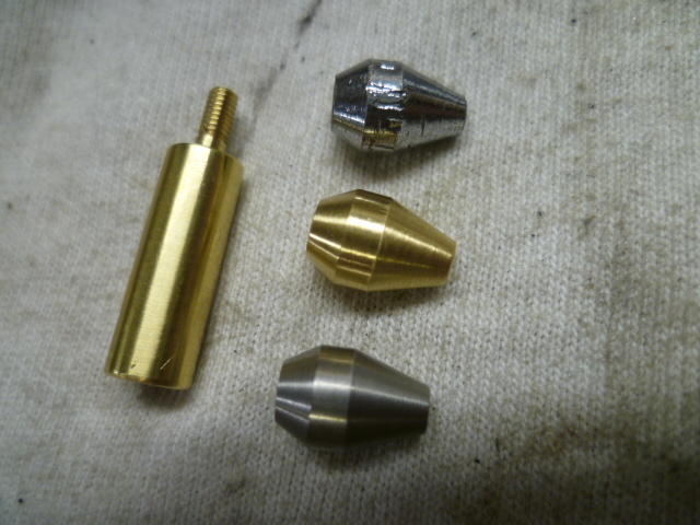

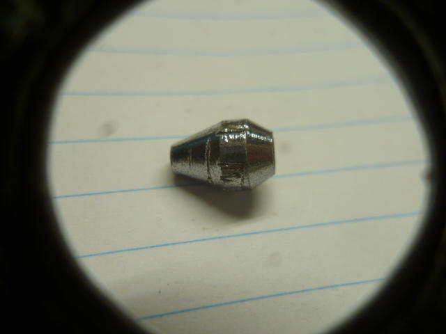

So @Zup, I got your chewed up (what used to be an) antenna tip  LOL   Perfect for my experiments.
The first thing I can tell you is that it's chrome plated brass, not stainless. And I expect this to be the case for those antennas on ebay. Why is that important? Couple reasons:
First, it means the prospect of buying something similar off ebay and taking a dremel to it isn't going to work unless you plan to send it out for new chrome plating afterwards.
Second, it means that the "color" is different than stainless. Now unless you think some judge at a concourse show is going to dock you points for having a stainless antenna tip instead of chrome plated........
With all that said, it was tropical storming today and I had some time in the shop. Here's some pics:
I had some other antenna here from a later year that I could mess with too:
I made two proof of concept tips. One brass, and one stainless:
The stainless would look better if I polished it. I didn't bother with that. Would still look different than chrome plating, but closer.

* The astute viewer might ask "Then how does it look like your brass tip is threaded onto the antenna in your pic???" The answer is... I drilled it out so it just slips over the threads. Proof of concept for outside shape only. I'm not really worried about tapping brass. The stainless concerns me more.
