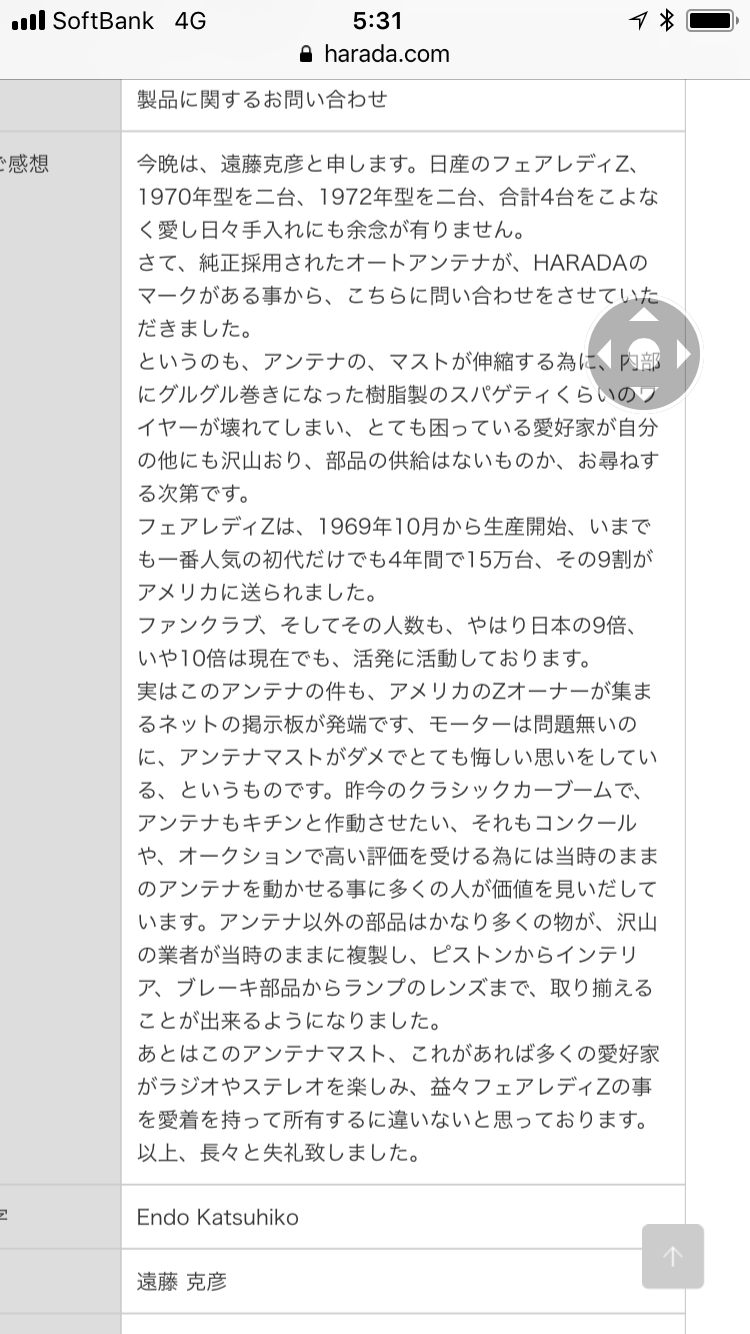

January 31, 20187 yr Popular Post comment_541293 Hi, I wrote a message to HARADA Ltd customers relationship, about a request of the antenna mast replacement. I do not know they will reply , I am waiting hearing from them. Kats Edited January 31, 20187 yr by kats Link to comment https://www.classiczcars.com/forums/topic/46443-antenna-rebuild-restore/?&page=5#findComment-541293 Share on other sites More sharing options...

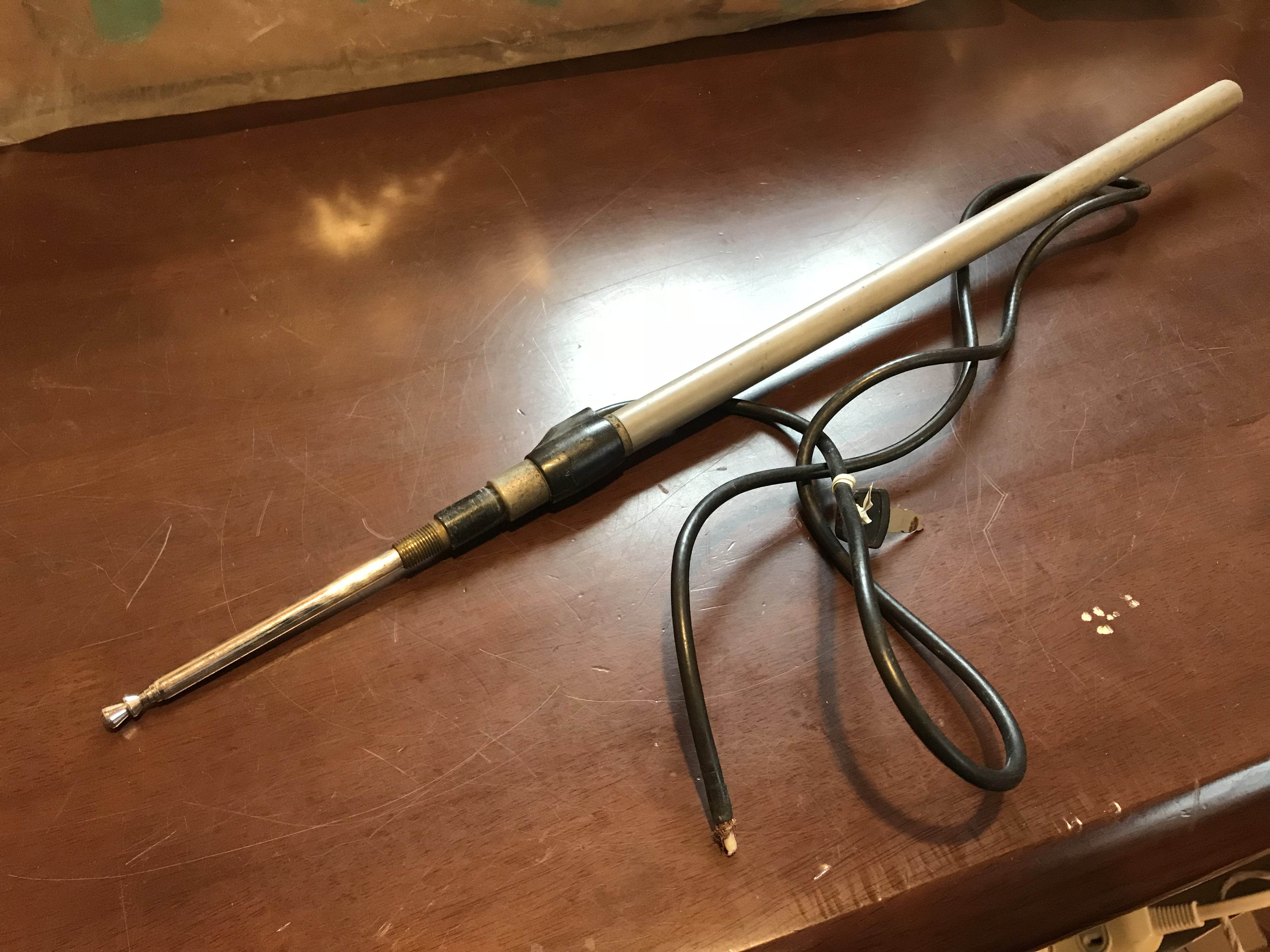

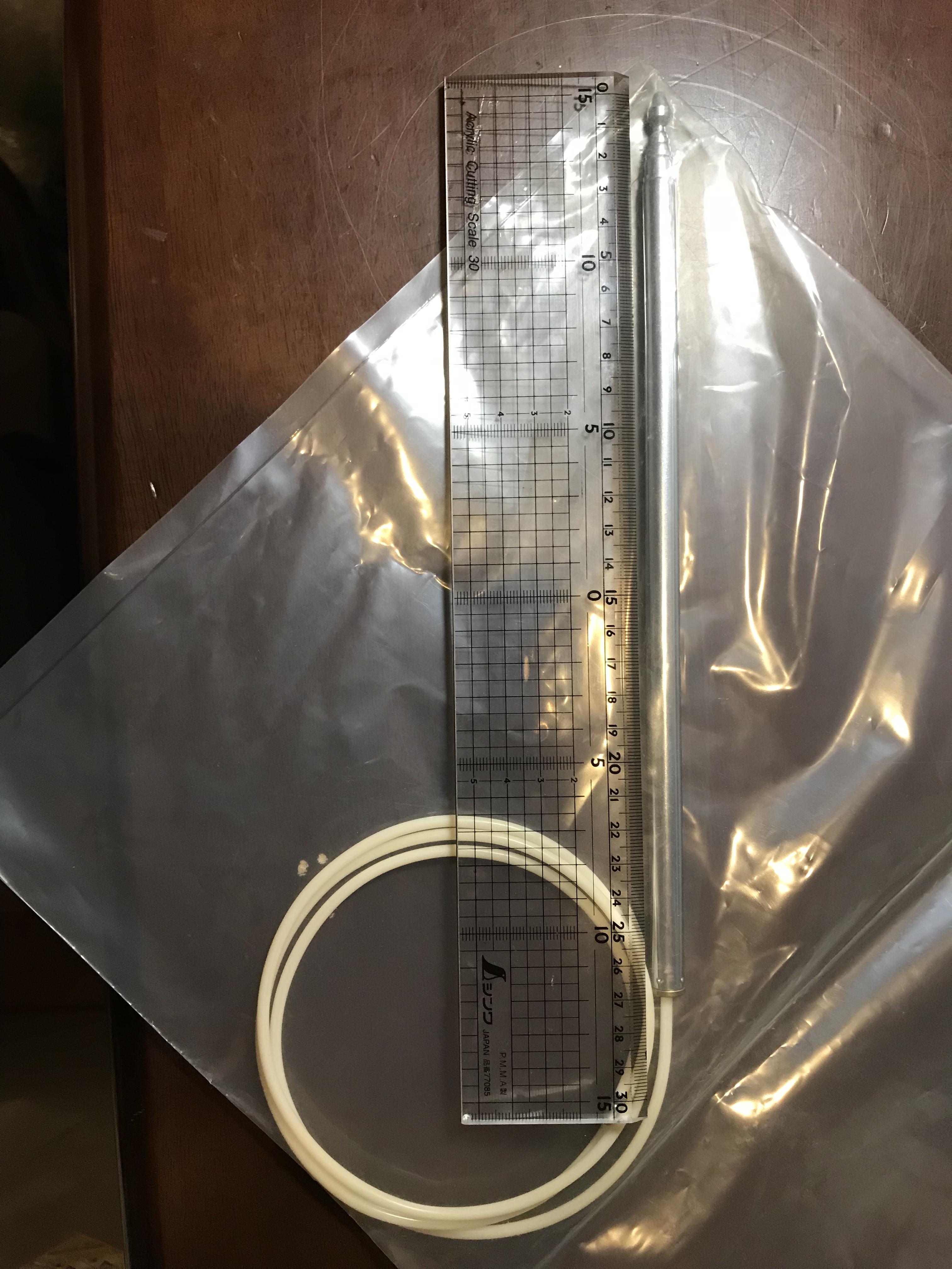

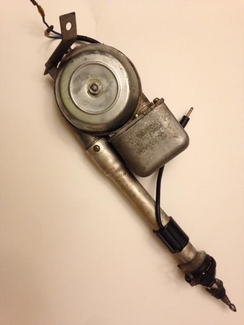

January 31, 20187 yr comment_541294 Here is my spare mast, I do not know it is HARADA or AFM one. The tip is pointing, looks exactly the same as original mast. We have a short and a long mast , my orange 240Z 12/71 has a short one while my Fairlady 240ZG 06/72 has a long one. How about yours ? Please see the pictures, Kats Link to comment https://www.classiczcars.com/forums/topic/46443-antenna-rebuild-restore/?&page=5#findComment-541294 Share on other sites More sharing options...
January 31, 20187 yr Author comment_541295 On 1/31/2018 at 11:38 PM, kats said: Hi, I wrote an message to HARADA Ltd customers relationship, about a request of the antenna mast replacement. I do not know they will reply , I am waiting hearing from them. Kats Thanks Kats. That would help out a lot of members. Link to comment https://www.classiczcars.com/forums/topic/46443-antenna-rebuild-restore/?&page=5#findComment-541295 Share on other sites More sharing options...
January 31, 20187 yr Author comment_541296 On 1/31/2018 at 11:45 PM, kats said: Here is my spare mast, I do not know it is HARADA or AFM one. The tip is pointing, looks exactly the same as original mast. We have a short and a long mast , my orange 240Z 12/71 has a short one while my Fairlady 240ZG 06/72 has a long one. How about yours ? Please see the pictures, Kats Kats, the one I am restoring is a long 5 piece mast, I believe that my 72 has the long mast as well. I found a NOS mast for my car in 2011 out of England. It would be great to have reproduction pointed tip replacement mast. Thanks again for your attempt to make this happen. JLP Link to comment https://www.classiczcars.com/forums/topic/46443-antenna-rebuild-restore/?&page=5#findComment-541296 Share on other sites More sharing options...

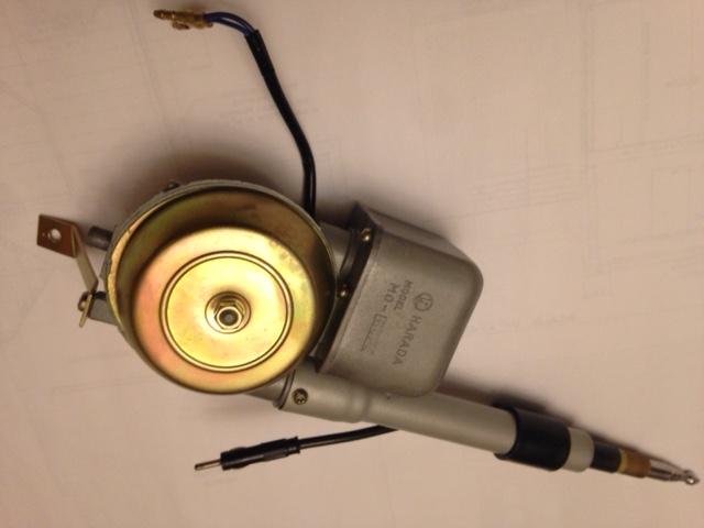

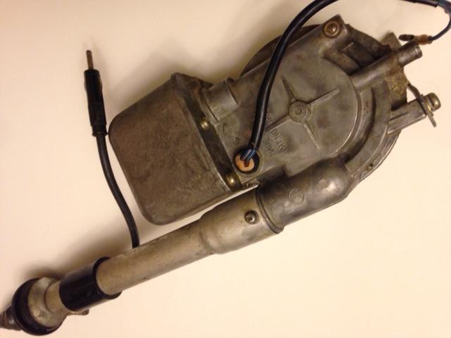

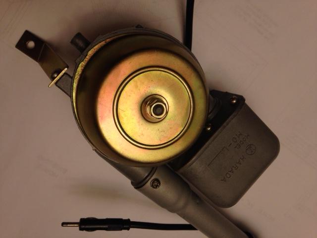

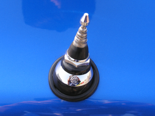

February 1, 20187 yr Author comment_541297 I thought a few before and after pictures of this latest antenna restoration might be nice. I media blasted the aluminium case with walnut shells polished the used mast, blasted wire brushed and plated the yellow zinc parts. I put together all of the best bits and pieces and put it all back together. A chrome cap for the ball and restore a retainer nut and cap, this project will be finished and on it's way back to the owner. Link to comment https://www.classiczcars.com/forums/topic/46443-antenna-rebuild-restore/?&page=5#findComment-541297 Share on other sites More sharing options...
February 1, 20187 yr comment_541298 Fantastic , Jerry . I hope people in HARADA see this thread and feel our passion for these parts to enjoy our Zs. Kats Link to comment https://www.classiczcars.com/forums/topic/46443-antenna-rebuild-restore/?&page=5#findComment-541298 Share on other sites More sharing options...

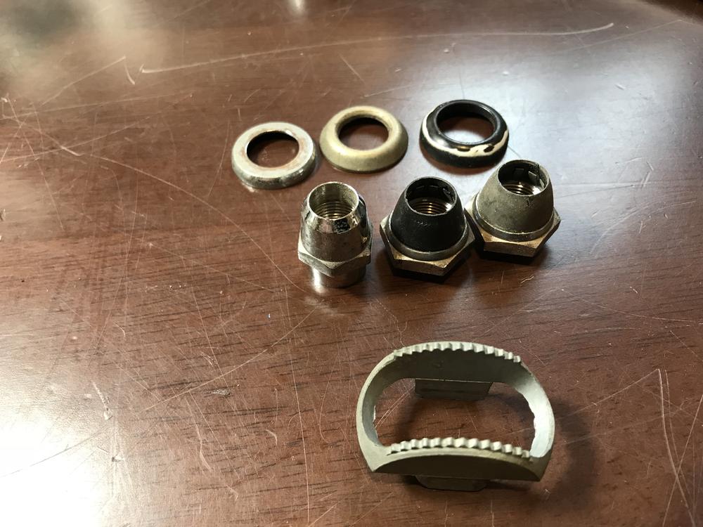

February 1, 20187 yr comment_541302 Sorry I may be posting off topic, I show you a manual extension antenna which would be an alternative choice for someone who doesn’t try to repair his auto antenna. This is for Fairlady Z (std) and export 240Zs which do not have an auto antenna. I may mixed up associated parts which are used for an auto antenna . It may not have a rubber ball , it might come with a die cast scallop ? piece. Kats Link to comment https://www.classiczcars.com/forums/topic/46443-antenna-rebuild-restore/?&page=5#findComment-541302 Share on other sites More sharing options...

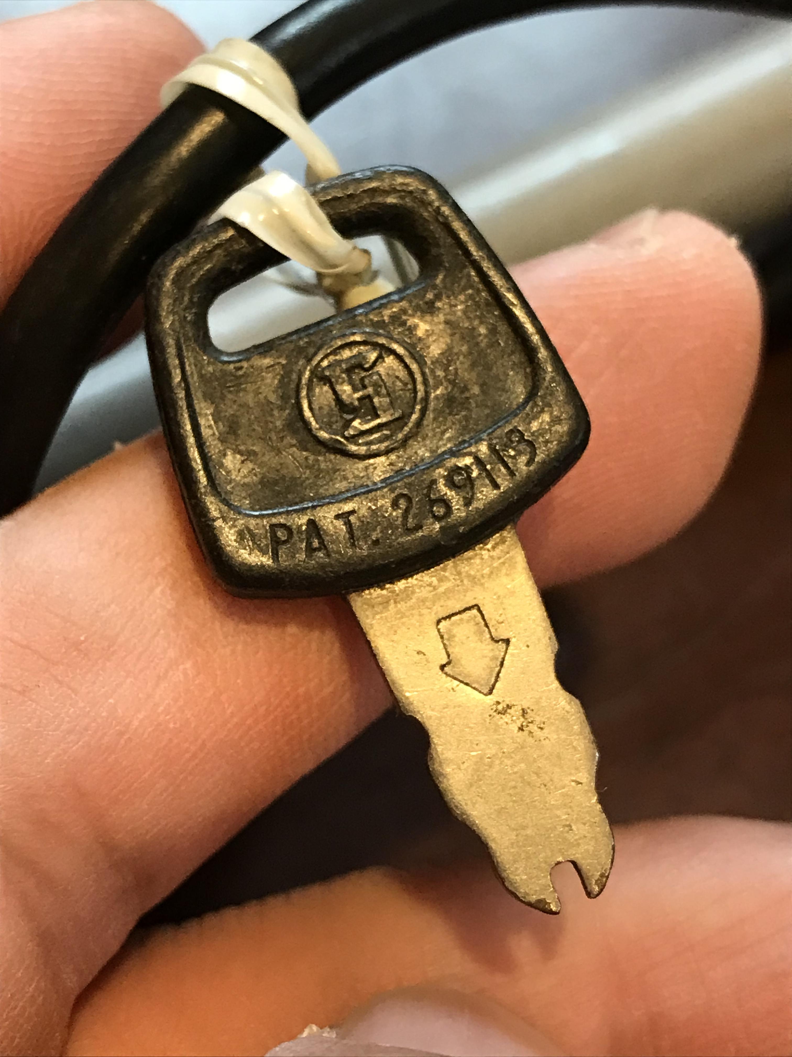

February 1, 20187 yr comment_541305 Hi Kats, This is a picture of the manual antenna showing the emblem on the round metal piece and another photo of the original Nissan key. -Mike Link to comment https://www.classiczcars.com/forums/topic/46443-antenna-rebuild-restore/?&page=5#findComment-541305 Share on other sites More sharing options...
February 1, 20187 yr comment_541306 Mike B, what a great news you have a rare one and a super rarer Nissan key !! I too have a Hitachi mark on the metal piece, I think it should go with manual extension antenna as I see your original antenna. I found the black plastic ring which is in between the Hitachi piece and the top rock nut is smaller than the one on the auto antenna. Kats Edited February 1, 20187 yr by kats Link to comment https://www.classiczcars.com/forums/topic/46443-antenna-rebuild-restore/?&page=5#findComment-541306 Share on other sites More sharing options...
February 1, 20187 yr comment_541307 Hi Kats, Yes, I recall seeing you post the photo of your antenna with the Hitachi mark on the metal piece, but I had never seen one on a North American market 240Z. The S30-S I posted the photo of is the only other one I have seen with the mark, so it makes sense it would be from the S model manual antenna. -Mike Link to comment https://www.classiczcars.com/forums/topic/46443-antenna-rebuild-restore/?&page=5#findComment-541307 Share on other sites More sharing options...
