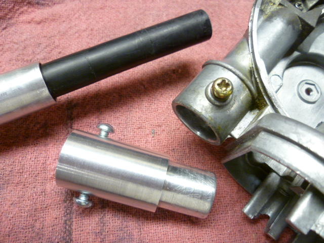

May 26, 20204 yr comment_600216 On 5/26/2020 at 2:54 AM, chaskill said: Ouch! I'm sorry for your loss, Captain Obvious. Thanks for the helpful pics though. That's what I was suspecting I might be up against, but glad I checked. I may try a drop of vinegar if another round of heating doesn't work. Well it wasn't a total loss, but it was one of those project steps which should have taken fifteen seconds turned into an hour of work. After the BFI removal, I cleaned everything up and made an "adapto-matic" extension to replace the original cut off portion and put the length back to where it should be. My aluminum adapter: Goop it up inside with silicone and put it back together:\ I actually made two adapters, but I don't remember exactly why. Either I needed to change diameters to use the mast from a different antenna, or it was simply "I cut it twice and it's still too short". Been too long to remember that detail, but in the end, the mast looked like this and it worked great: So like so many projects, it wasn't a total loss, but it took way longer than it should have because of unforeseen surprises. Link to comment https://www.classiczcars.com/forums/topic/46443-antenna-rebuild-restore/?&page=9#findComment-600216 Share on other sites More sharing options...
