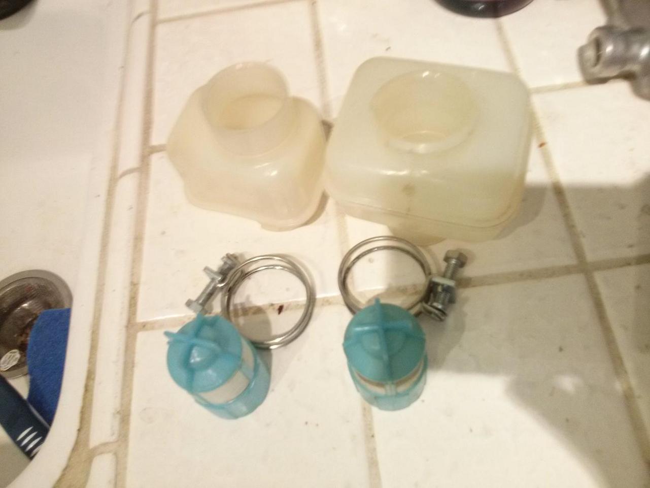

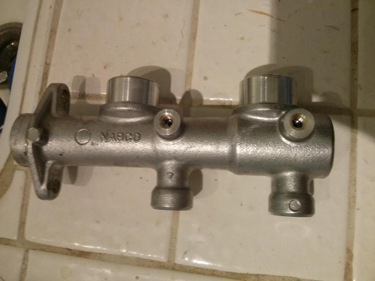

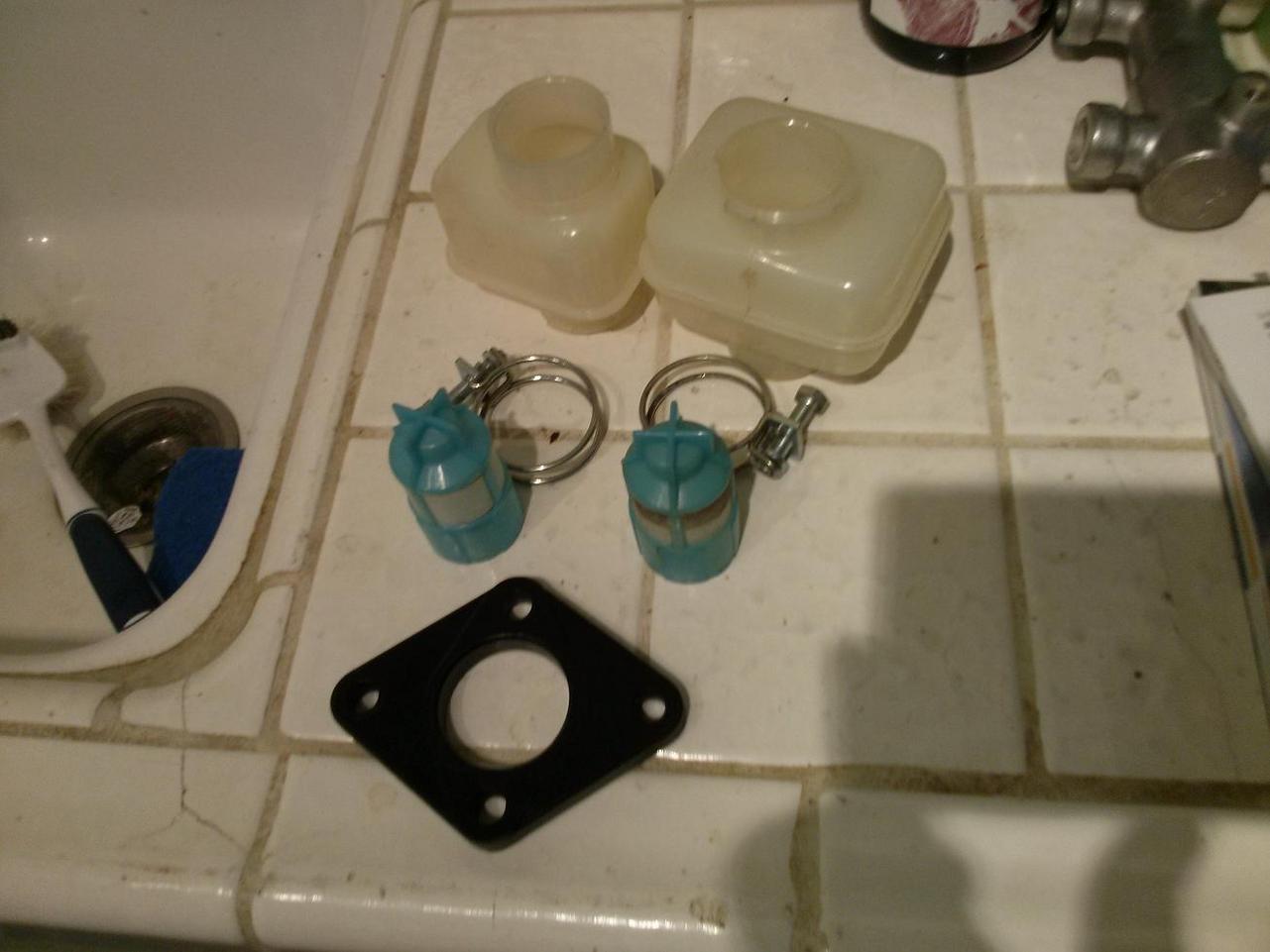

I ended up buying a 15/16 280 MC from Matt Hurr a while ago here. I am upgrading to 4x4 S12+8 calipers front, and 240sx rear. I currently have the stock 240Z MC and when I opened the box this is what I had . . .
MC
Fluid Cups
Filters
Fluid Cup brackets (to tighten around openings)

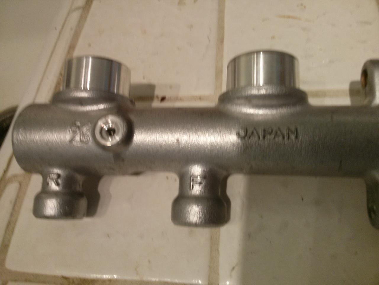

Now, I noticed that I didn't have any of the bleeder valves, what type do I need to buy to put into the SIDE of the MC?
Can I just take the Front and Rear Lines out of the bottom of my stock 240Z MC, and run them into the bottom of my new 15/16 MC? Do I need to buy any adapters?
Finally I see a small hole on the opposite side of the MC's bleeder valves. It looks like a screw can go into there, but there is none. Do I need a screw for that hole?

Hi New-to-240z,
You are missing so many important parts.
The small hole on the opposite side of the MC's bleeder valves is to put a special size screw that stop rear brake piston.
You better get another 15/16 BMC or brand new Willwood 1" BMC.
You serious? I can't believe this. I had this sitting up in my closet for like 8 months waiting to be installed only to find out it doesn't have all the parts I need! Hope I can find the guy . .
Anyway, I going with rear disk 240SX calipers so I wouldn't need the special screw right?
Also, I thought that I only needed those valves in the output to the brake lines if I was using Drum rear brakes. Since I'm using calipers, I shouldn't need them. So, would I be able to simply unhook my stock lines from the MC and connect them to the new MC?
The parts you are missing are hard to find without buying another MC. It might be easier to get one from RockAuto And for $53.00 you have a complete unit without the 2 reservoirs. Its only $30.00 with core.
