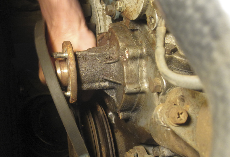

June 4, 201311 yr Author comment_424843 Alright, so, today's project was a pain in the tail end, but we're on schedule. I think I found the cause of some of my front-end rattle. Turns out the radiator shroud wasn't actually bolted to the radiator. Pulled the top hose, managed to get the fan and clutch removed from the water pump after much swearing, and started soaking the hell out of the water pump bolts.The pulley shows a lot of buildup, but it should scrub clean with a little elbow grease. The pump itself looks like crap, but so does most of the stuff under the hood. I'll be soaking the bolts for the next week or so before removing the pump. I'll have a look at the shroud and see if it needs some kind of repair that might explain why it wasn't actually attached to the radiator. Link to comment https://www.classiczcars.com/forums/topic/46470-motivation-or-the-lack-thereof/?&page=3#findComment-424843 Share on other sites More sharing options...
June 10, 201311 yr Author comment_425232 Been sick the last few days, so very little real progress to report. I managed to break the fan loose from the clutch - I have no doubt it's original - and paid the price of very cut knuckles. The pulley is pretty crapped up, but it should clean up just fine with a little steel wool. The water pump bolts have gotten another soaking with ATF/Acetone and will get a couple more during the week - the pump is the project for the weekend. Link to comment https://www.classiczcars.com/forums/topic/46470-motivation-or-the-lack-thereof/?&page=3#findComment-425232 Share on other sites More sharing options...

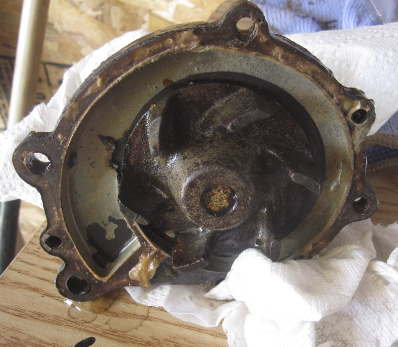

June 16, 201311 yr Author comment_425764 Yes, there's a drain plug - I ended up finding that article after I'd already siphoned the tank, but it's good for future reference. Today's update: The water pump has been replaced, although one of the short bolts did break off right at the first thread (top, driver's side, roughly 2 o'clock position). The other bolts came out just fine, although one of the thick, long bolts was very corroded and was a major pain to get out via much wiggling and swearing. I know some folks have had good luck with one missing bolt, although it's usually the 11 o'clock bolt - so I figured we'd go ahead and try it. It does leak from that area, but it's not extreme. I think I try pulling it and using a gasket sealer and then replace it again. The new fan clutch and everything seem to work very well, and the leak at the pump is not severe. Now, I found the obvious point of failure in the old pump - the bearings failed and the impeller ground against the internal baffle. Explains why I couldn't turn it by hand. So, now the car idles well and I'll keep at the water leak issue, but I'm going to have to move ahead with the fuel pump, which sounds like a banshee, and the car's desire to stumble when it's given basically any throttle. It reacts pretty violently when given any gas, stumbling and almost making a backfiring sound. I took a couple vids but they don't sound very clear. I'm going to try cleaning them up and uploading them later. Link to comment https://www.classiczcars.com/forums/topic/46470-motivation-or-the-lack-thereof/?&page=3#findComment-425764 Share on other sites More sharing options...
