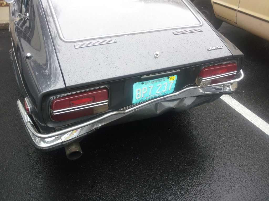

On May 1st I was rear ended. Inspections from below indicated 99% of the damage was behind the rear shock towers. removing the carpet showed that the spare tire pan had been distorted.
The rear bumper under the license plate ended up 5 1/2" inches forward of the trailing edge of the hatch (about 8-9 inches of crush).
Finally got the car into a body shop yesterday afternoon and popped the hatch. We found the spare tire (properly inflated) jammed in the collapsed pan. Besides increasing the stiffness of the area, the spare had absorbed much of the shock and spread the load out across the forward side of the pan. In doing so, the damage ahead of the pan was greatly reduced.
In my case, this has meant a repairable vehicle instead of a total. As far as the human cargo, my wife and I only suffered week long headaches and neck stiffness.
Let this be a note of caution for all of us who drive around without a spare - and those of us who haven't topped off the air in the spare for years. For Z's your spare is also part of your safety equipment.
