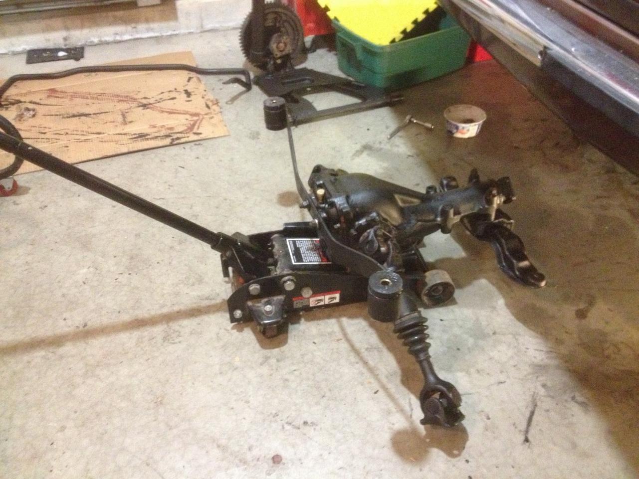

I've replaced mine several times using jack stands on the rear only. They're heavy so if you used an auto lift you better be able to maneuver about eighty pounds over your head easily, or have a transmission jack. Doesn't sound like a whole lot but it's an awkward load. On the ground on jack stands you can either bench press it or use a floor jack, balancing carefully. I've always used a floor jack for ease and to stay less greasy, plus it makes it a one man job.
There are basically two ways to do it, leave the mustache bar on and it will drop straight down and go straight back up, or wiggle it forward to release the studs from the mustache bar, and reverse that to install.

I dropped my diffy with half shafts on it, car was on jack stand. Those half shaft bolts were super duper tight on differential end so i had to do it that way. I removed driver side control arm and dropped it, while laying under it. Putting new diffy back is not that PITA if you have extra hands to operate your jack. I was lying under car while my wife operated jack and lifted it up as requested. Took about 10 mins to get it fitted.
I dont see any reason why you should drop mustache bar, unless you are about to change that too.
I'm with Zed Head on just adding fluid. Might as well try that first.
I've swapped diffs many times and might swap one later today. It's pretty quick and easy to put the car on 4 stands and use a jack to lower the diff out. I leave the mustache on the car. The biggest pain is the half shaft nuts.
Chuck
So you know-good advice above. The diff will pretty much hang off the moustache bar after disconnecting the front of the diff- even without the nuts on there. The r180 is closer to 65lbs - so you can man handle it if your careful. Or balance it on a jack to lower it down.
I've always left the mustache bar in, never actually left it attached to the diff, only seen it done that way. Thought it was worth mentioning. As madkaw says, the diff will hang from the two studs in the bar without the nuts, giving time to practice lifting and moving it before bumping it forward it and letting it down.
I've also found that the inner half shaft nuts can be removed using a bunch of extensions on a ratchet handle, working from the wheel well, if you rotate the shaft to the right spot. Leave the outer nuts for last so that you can use the wheel to rotate the shaft.
Also, the half-shaft flange can be a tight press fit on its locating center. You might need a punch or chisel to knock it loose, on the inner and outer sides both. If you use a chisel to split it, make sure that you don't leave any burrs on the surfaces when you put it back together.
