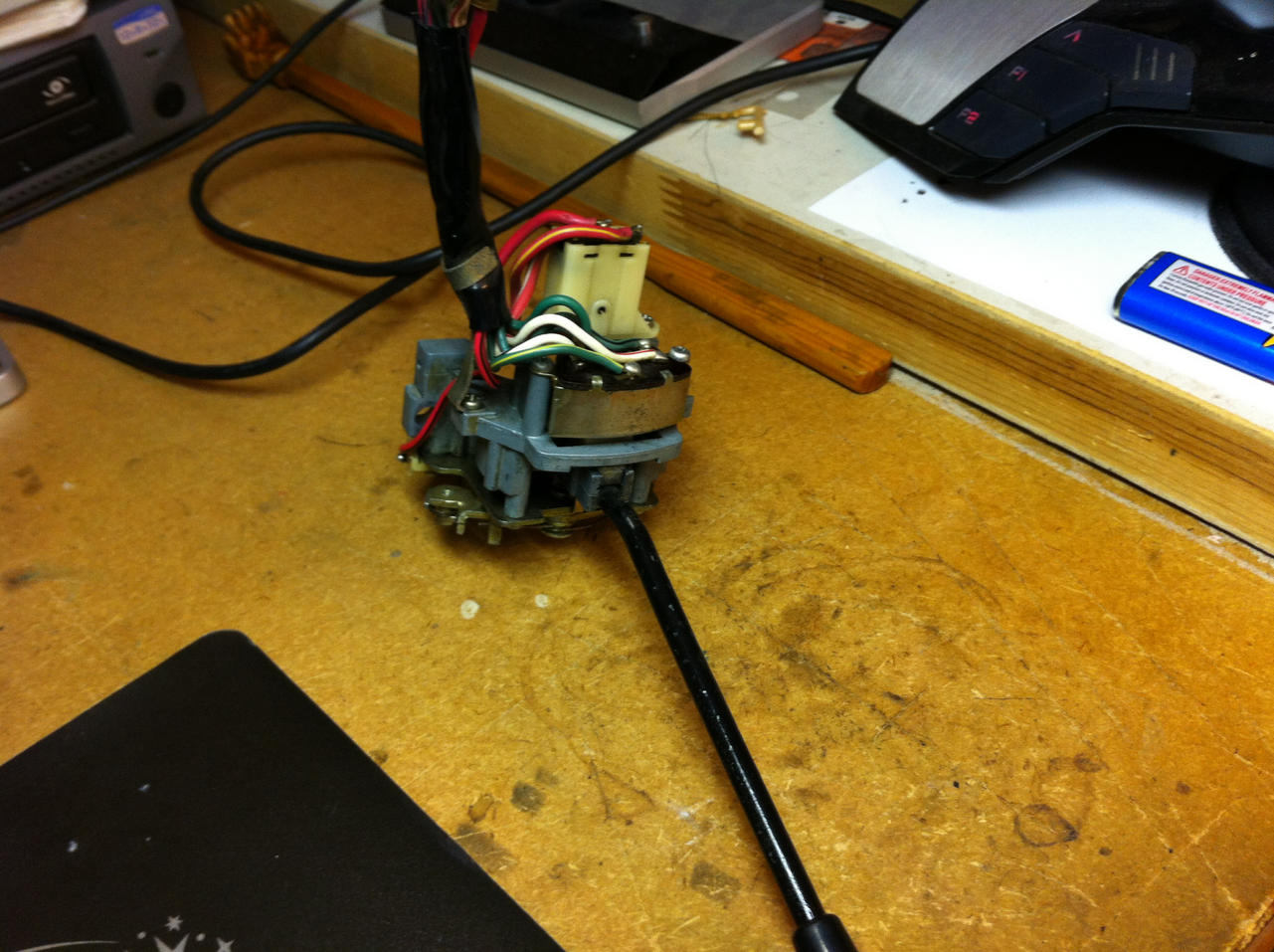

kenmataya Posted June 4, 2013 Share #19 Posted June 4, 2013 hello all, another turn signal switch question - i have a early signal switch (see image), it was working but has stopped and i swapped in a later model switch that works OK - it requires a bit of rewiring to work. when i use the lever to make the turn signal operate ( the switch is together ) it won't work, but if if i pull the switch box off and push the switch to either side it does work - i.e. the lever doesn't push the pin far enough to complete the circuit. so, has anybody pried the box open to solve this problem? Link to comment Share on other sites More sharing options...

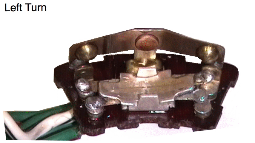

Mikes Z car Posted June 4, 2013 Share #20 Posted June 4, 2013 (edited) Don't know if this will help with visualization much. This is the turn switch in action as it is put through left turn, right turn and no turn for a January 1970 Z. It is an animation I made for a blog I haven't posted yet. It doesn't show the ball bearing on the end of a spring that rolls across the see saw part of the switch to make it move back and forth. Click to see the action. Mike Edited June 4, 2013 by Mikes Z car Link to comment Share on other sites More sharing options...
kenmataya Posted June 5, 2013 Share #21 Posted June 5, 2013 thanks! that is pretty much what i suspected. so it looks like i need to open the box and flatten the contact plate ( with the 4 contacts ) a little. any tricks to the assembly disassembly?thanks,Ken Link to comment Share on other sites More sharing options...
SteveJ Posted June 5, 2013 Share #22 Posted June 5, 2013 Turn Signal Repair | Fiddling With Z Cars Link to comment Share on other sites More sharing options...
Mikes Z car Posted June 5, 2013 Share #23 Posted June 5, 2013 Steve, that is a terrific article on the turn switch. Nicely done, great pictures. kenmataya, not sure but if flattening is done maybe the ball bearing has more freedom to come out of its hidey hole and could fall out when a turn is selected? Instead of flattening maybe consider bending down the flexible tabs the contacts on the see saw are mounted on? I wonder though, maybe if the contacts are cleaned the contacts are good then without any bending? Just thinking out loud here. Link to comment Share on other sites More sharing options...
SteveJ Posted June 5, 2013 Share #24 Posted June 5, 2013 Thank you, Mike. Now that I have a better camera and a lot more switches to play with, I was thinking of re-doing that one. I liked your animated GIF, too.I agree about not flattening the rockers. That won't improve the operation of the switch. Link to comment Share on other sites More sharing options...
