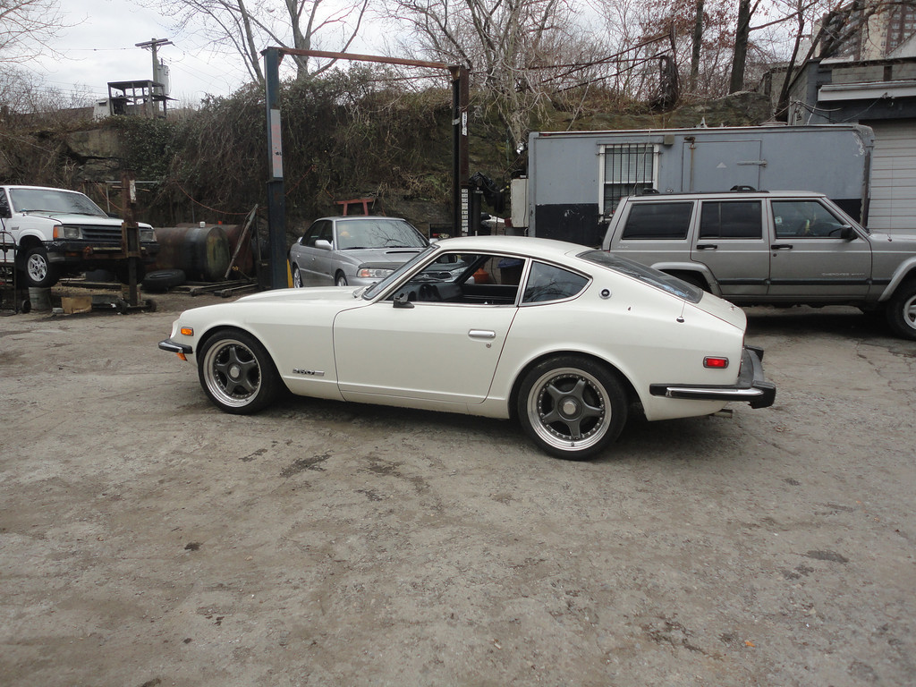

Running Tokico springs and Blues on my 78 with 245/45/17 Eagle GT's. I had to trim the MSA air dam for clearance but I think that is pretty common anyway. The wheels are the Konig Imagine with the opal finish that MSA was selling. The ride is a little stiff, but I think that has a much to do with the sidewall on the tire as the suspension.
