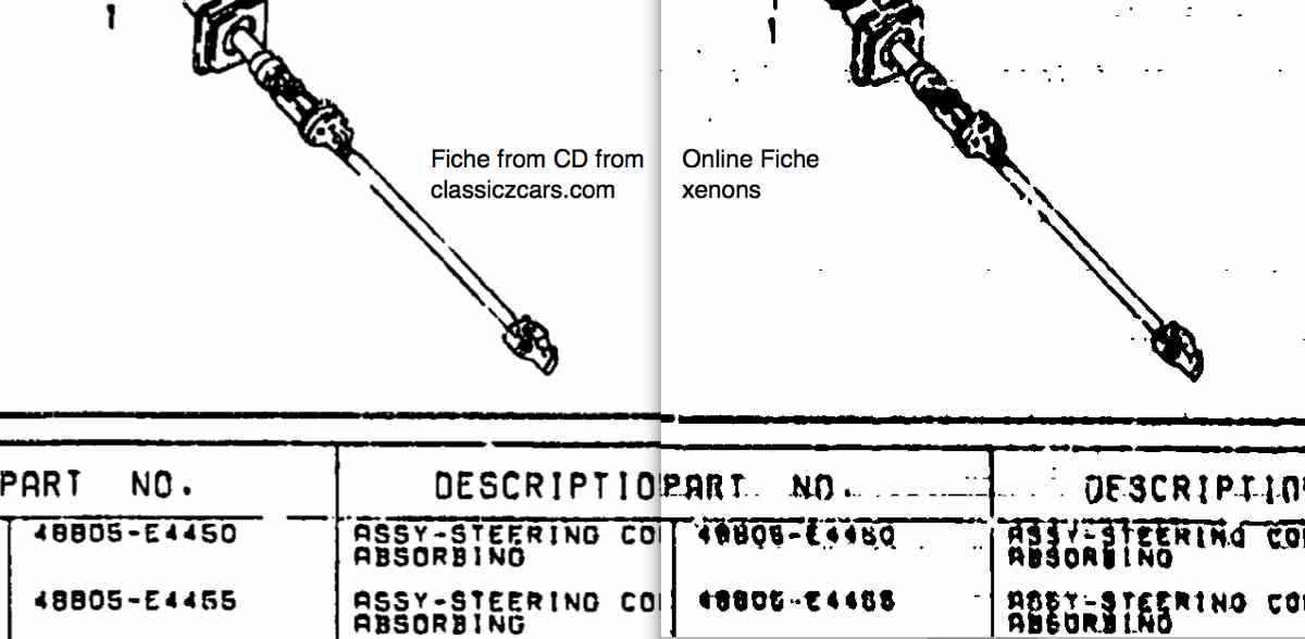

June 14, 201311 yr comment_425607 Section 8, however, is truly MIA. (Maybe because it's "Section 8?") Ha Ha that is pretty good. Being ever curious about computer graphics I noticed the fiche classiczcars.com sells in the store is more readable than the one at the xenons website though I think it is great xenons offers their fiche as a free service. I only noticed because I was recently looking up a part and was trying to read part numbers: Fiche on left from classiczcars.com: On my old car I took the hatch lock apart and rearranged the order of those tumblers to make the ignition key fit though the keyway has to be the same for this idea to work. I did have to leave one tumbler out as it would not fit the key no matter what position I put it in. Edited June 14, 201311 yr by Mikes Z car Link to comment https://www.classiczcars.com/forums/topic/46733-trouble-with-ignition-lock-cylinder/?&page=2#findComment-425607 Share on other sites More sharing options...
