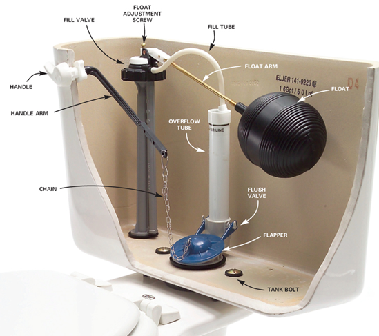

Bruce, what is it about the existing floats that make them need to be replaced? Aren't they solid material? It is something to do with the metal frame? Are the float bodies deteriorated? Can't imagine ways to help unless we know the details.
If its the resin that needs replacing, I was thinking about other ways to replace just that part.
Precisely weighted ping pong balls? Styrofoam? Just need something with the same density, yes?
I'm flush with ideas once I get going!
