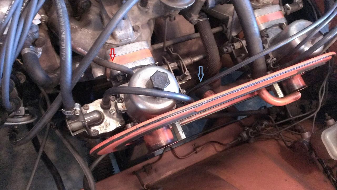

I have another question about my car actually... I'm not sure how I missed this earlier. I was inspecting around the air cleaner and realized that the hose that attaches to the bottom is gone, there's a hose coming from near the carb that is plugged with a screw(?!) and the hole towards the front of the car on the air cleaner has been plugged on the side towards the engine. I've attached a picture so you can see what I mean, the air cleaner cover has been removed. Red arrow points to the hose with the screw plugging it and the blue arrow points to the hole that has been capped off. I'm guessing the car has been de-smogged which is fine with me I just want to be sure there isn't something weird going on.

If I understand your description, the red arrow hose goes to the front carb and connects to the diaphram on the distributor (the round thing sticking off the side of the distributor).
The blue arrow indicates the front carb choke wire. You should see the choke linkage and where it connects.
Do you have a Factory Service manual? (FSM). If not they can be downloaded. Just search for a member here who goes by "Blue".
Also check the ZTherapy website for illustrations and you may want to get their SU Carburetor DVD.
