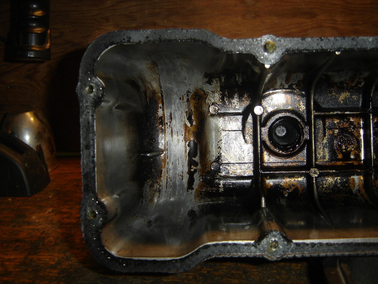

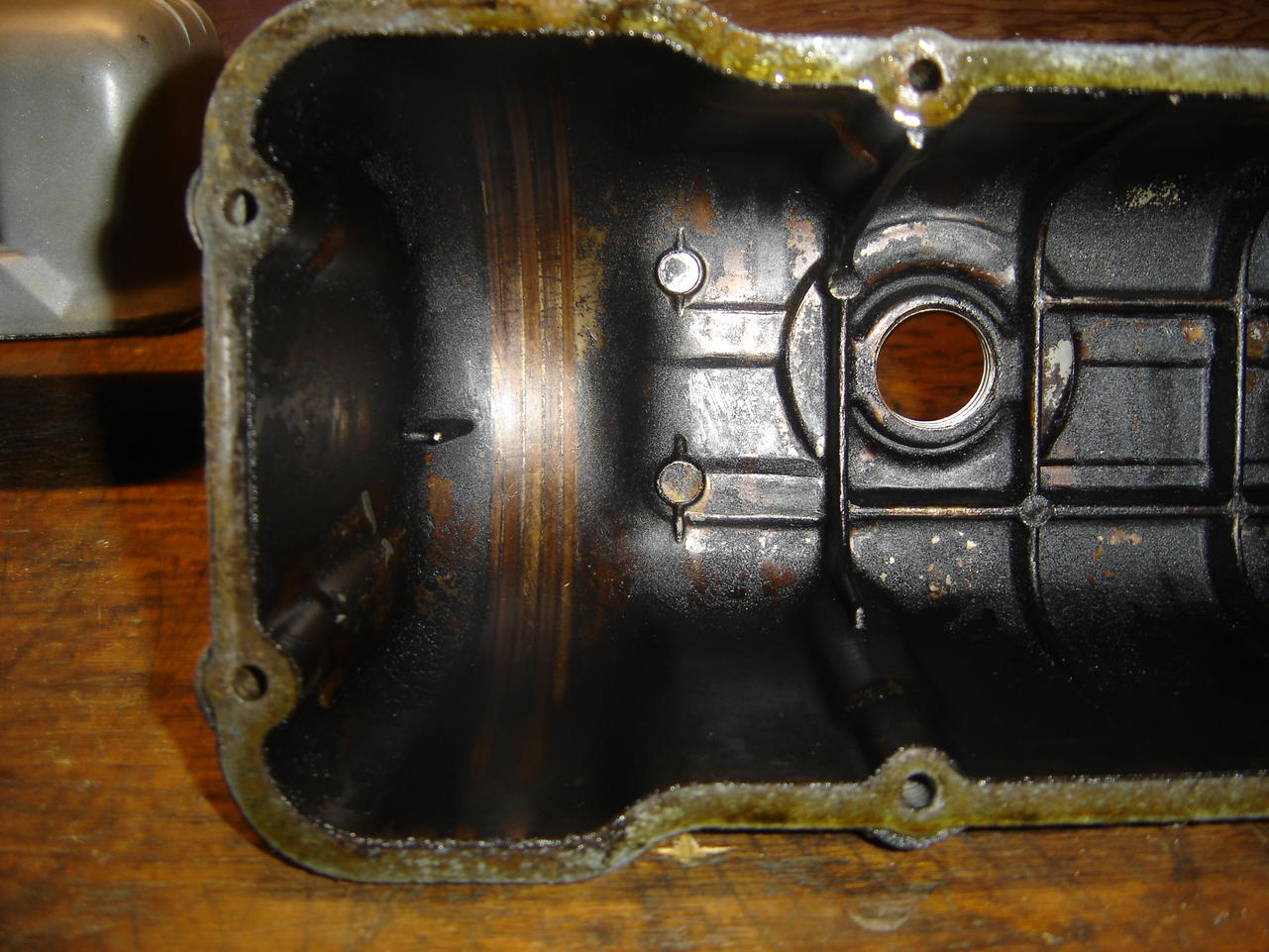

Hardway, so from what your saying, it seems then that there was no actual touching of the chain to the valve cover. You can confirm that there is no marks in the aluminum?
If thats the case, then the patterns we see are likely just "cleaning" of the previous dark varnish coating by oil spraying from the chain. Did you recently change to so some of that modern "detergent" oil? LOL

I pulled the cover off my '77 that only has about 1500 miles on a newly rebuilt motor, also looked at the one I took off my 240 about a month ago. It has to be so close that the oil is slinging against the cover and making those footprints like Zkars says. I use VR1 and my valve cover didn't look like that when I put the motor together back in September '12.

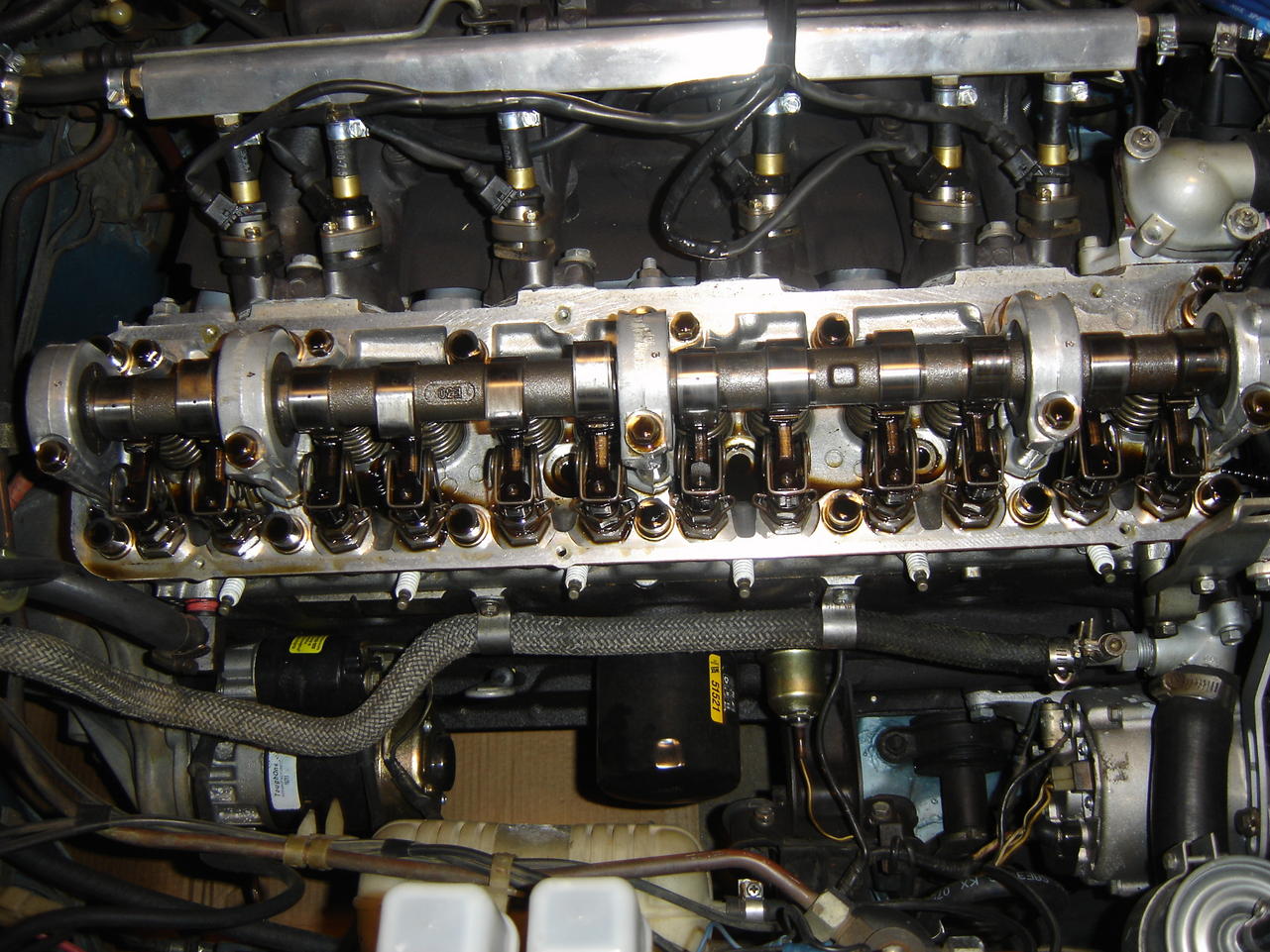

More details now that I'm made some positive progress. The car is running and left for its new home last night. The original power-on ticking/clicking noise that caused the iniitial investigation is gone. Replace with much more satisfying and familiar cold clearance set valve train clatter.
Blue/Jan, you guys are spot on about new chain being tight ie no slack. I installed the "new" (to him) head and a new chain and guide,s and as usual, the chain is a VERY tight fit.
I got the chain on its correct clocking, then when re-installing the (curved) tensioner, I had to use a c clamp across the chainand guide in the center to lightly compress it to get the top bolt (slotted hole) in the tensioner. Same when re-installing the tensioner. Tight fit indeed.
I took a picture of the old and new chain on the bench to show the length difference (sorry will post it later). The old is clearly stretched, but not quite to the extent I expected. The old head had shims under the towers as well which I removed for the near-stock thickness N42 that took its place (used his towers/cam/rockers/lashies). Would have been impossible to get that chain on with those shims in there.
I looked at the valve cover and it looks exactly like the two shown above. Not a mark/gouge in the cover that I can feel with my nail or finger, just the cleaned paths made by fresh modern oil clearing away varnish.
And in general, with more thought about what caused the tooth skip to start with, I'm more and more skeptical about the rag having anything to do with it. I just can't believe the texture and material strength (or lack of it) of it would be able to create a wad that would have had sufficient compressive strength to cause this. The rag was well distributed around the gear when I stopped dug it out. No concentration in one spot. I'm now inclined to believe its a combination of the herky/jerky motion of using the remote crank switch and the very loose chain with no tensioner pressure that ate my lunch. Beware!
Another learning point to add to the conversation. When using the starter to rotate things, it's now very clear that it had no problem bending the valves as it rotated the engine without so much as a hiccup that might give you clue something bad was happening. At one point late in the process, (actually just before the realization of doom occured) I'de put a socket on the crank nut to move the engine to exact TDC to get things lined up for another timing check. The engine rotated smoothly then BANG, it stopped dead. When back the other way, smooth until, BANG, same thing. Dead stop. I put quite a bit of pull on the handle and couldn't budge it. So its clear that HAND rotation or maybe pushing the car in gear is the right technique, if you have ANY reason to suspect an old loose chain or you're working on a new motor and testing if you turns over. Sounds obvious now, doesn't it?
