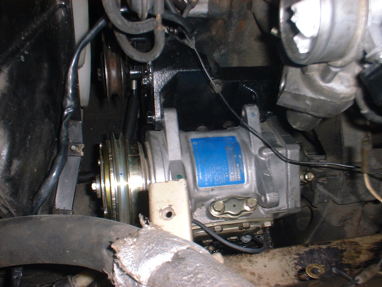

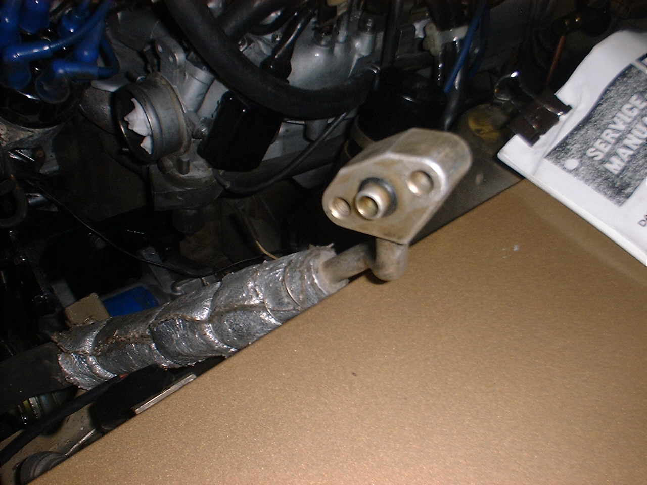

July 27, 201311 yr comment_428604 good used ones come up on ebay occasionally. Living in houston you probably use the a/c alot so you need a brand new compressor. You can adapt other hitachi's but have to have new hoses that attach to the compressor built. I use the mjs170 on mine. It bolts on and is used in many subaru's and nissan's of the 90. You can still find brand new ones for cheap... errr under 300$. There are later ones with a serpentine belt. You can use that one if you change out the clutch for a v-belt clutch. I got these hoses from the wrecking yard. donor was a 90's sentra and the a/c shop built them so they would fit my 78. Its been 8 years and my a/c still works great. Im in hawaii so i use it every day year round. Link to comment https://www.classiczcars.com/forums/topic/47079-hitachi-a8937-replacement-air-compressor/#findComment-428604 Share on other sites More sharing options...
