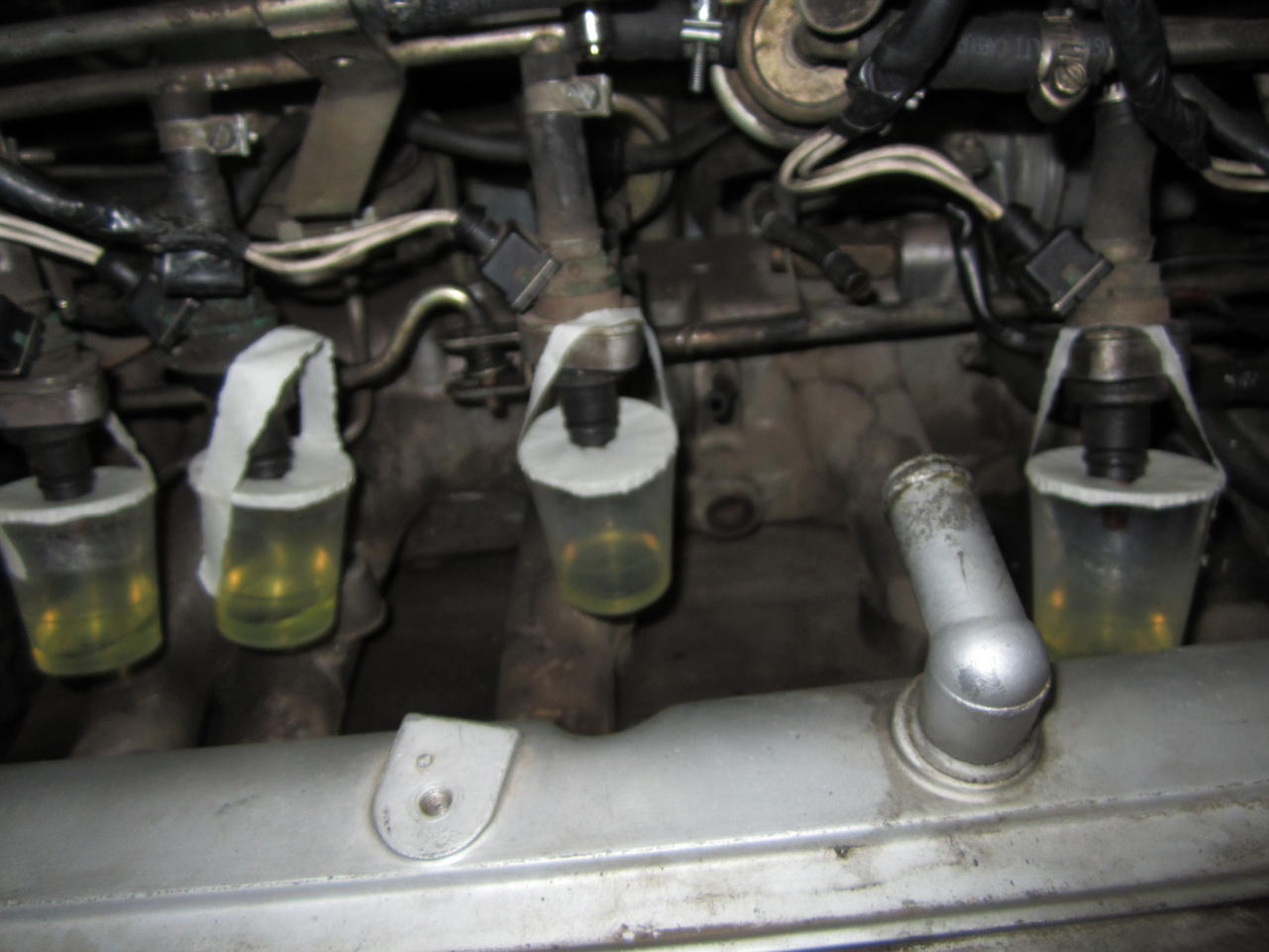

You can remove the connector one by one with the engine running. You should notice the revs drop per cylinder when you disconect it.
Another alternative is to lift the fuel rail with injectors. Do a run test with the spark plugs out and crank is on the starter for a short period and see what the injectors do.
I did that two years back to find two faulty (nr. 3 and 4) injectors.

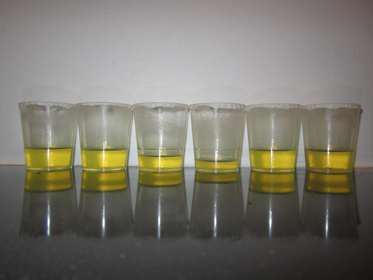

I just put 12 volts to the two suspected injectors, I can hear them clicking. Next will be to lift fuel rail and test crank it like you said. I might just end up ordering all new injectors since these could be original injectors and I know for a fact the car was sitting for 18 years with fuel in it.
I ordered new quick connect injector plugs since mine are in rough shape and cracked. I'm also thinking about ordering the Pallnet fuel injection rail system since I'll have everything pulled apart. I like the cleaner look of a simply fuel rail. Just keep throwing money at it until it runs right?? haha
I got the two bad injectors flowing the same as the other four by reverse flushing, like Blue mentioned.
It was a crude simple set-up, but it did the job: 70cm garden hose fitted to the injector tip with a hose clamp, fitting on the other end for the air compressor, 9volt battery & connector. Continuous 12volts is not good for the injector coil and they open and close good with 9volts.
Filled the hose with a fuel and injector cleaner mix and blow it through with 1.5bar compressed air. Did that 3 or 4 times and they all cleaned up a lot. Its not perfect, but it got them all producing within 90% of each other back on the fuel rail.
If you are thinking of buying new injectors, now would probably be the time to do it. That would eliminate them as a cause and like you said; after 18 years of sitting with old fuel I suspect they will be a like mine were.
Chas
