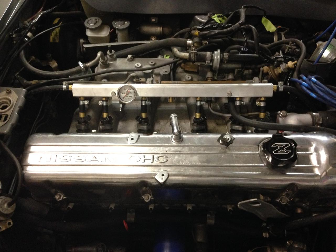

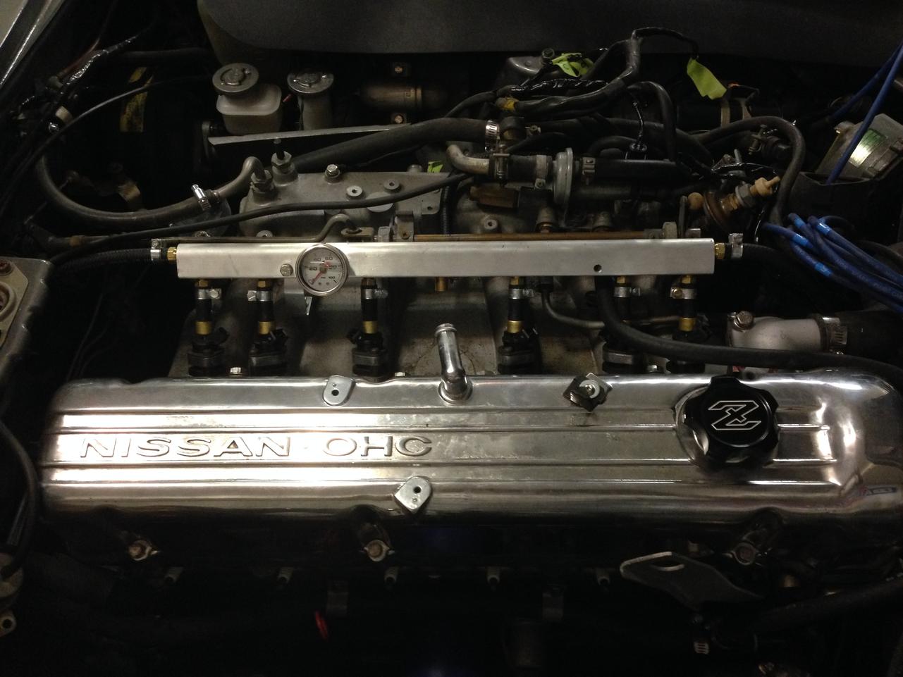

May 11, 201410 yr Author comment_447627 Getting the fuel rail installed and hooked up. Simply and clean design, I like it. I soldered all new quick release injector clips onto my harness. Now I know I'm getting a good connection and they are easy to pop on and off. Link to comment https://www.classiczcars.com/forums/topic/47115-280z-full-restore-in-5-months-hopefully/?&page=13#findComment-447627 Share on other sites More sharing options...
May 11, 201410 yr comment_447655 looks great - can you read the fp gauge from the drivers seat with it angled off to the right side?i'm going to be doing a similar setup and have been wondering about that. Link to comment https://www.classiczcars.com/forums/topic/47115-280z-full-restore-in-5-months-hopefully/?&page=13#findComment-447655 Share on other sites More sharing options...
May 11, 201410 yr Author comment_447674 looks great - can you read the fp gauge from the drivers seat with it angled off to the right side?i'm going to be doing a similar setup and have been wondering about that.Unfortunately I can't, I had to stand over top of the engine to see it. Link to comment https://www.classiczcars.com/forums/topic/47115-280z-full-restore-in-5-months-hopefully/?&page=13#findComment-447674 Share on other sites More sharing options...

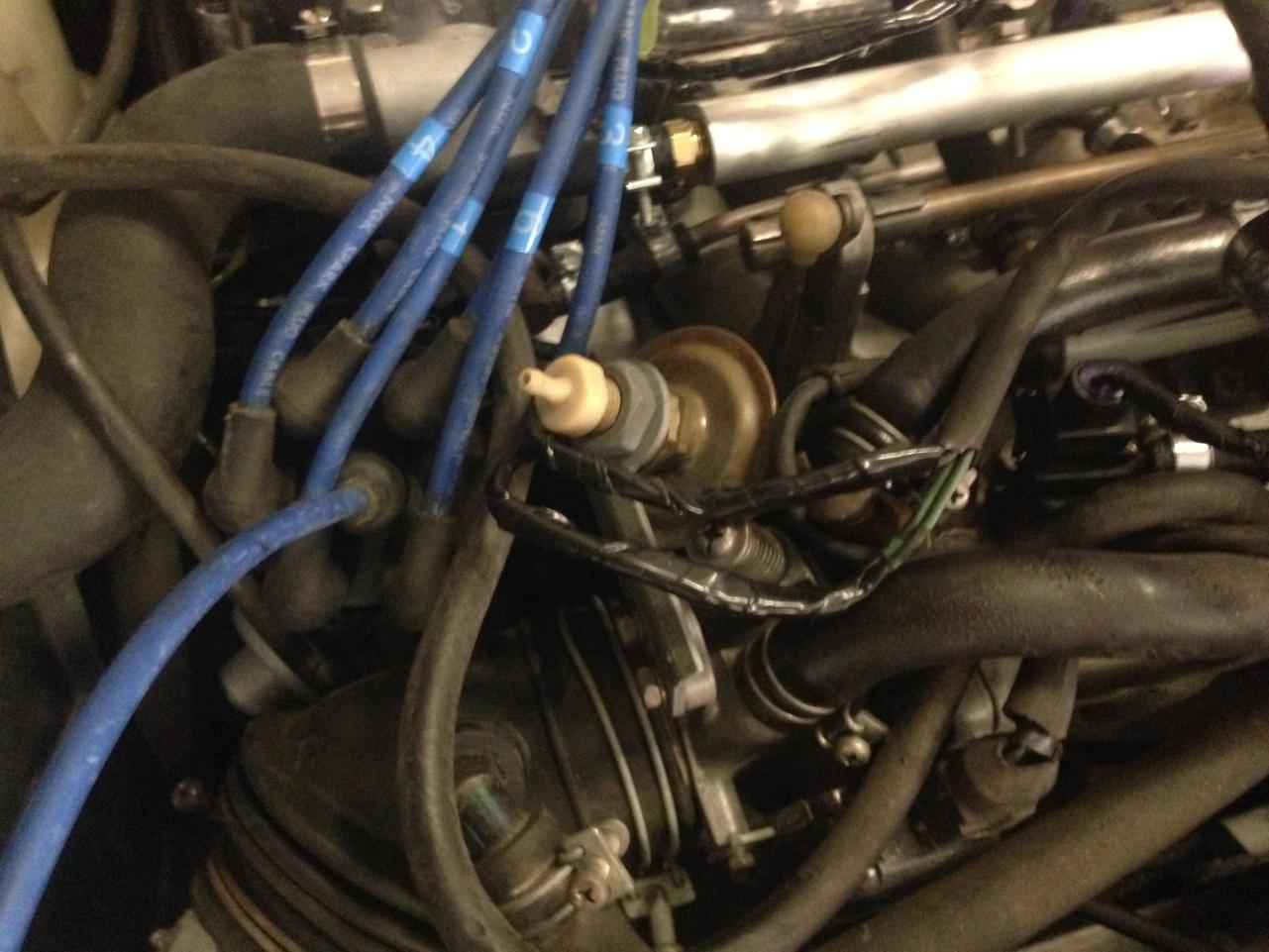

May 12, 201410 yr Author comment_447677 Also what vacuum hose is suppose to go to the end of this? It looks like it helps with idle. I don't think this is stopping my engine from running right, but it can't be helping either. Link to comment https://www.classiczcars.com/forums/topic/47115-280z-full-restore-in-5-months-hopefully/?&page=13#findComment-447677 Share on other sites More sharing options...
May 12, 201410 yr comment_447679 sure sounds like timing...i learned from Blue that the dashpot stays like that, open to the air - it's just to provide a "soft landing" to the throttle when it closes quickly. i had (mistakenly) put a vacuum hose to mine, rendering it useless. he saved me from myself on that one. Link to comment https://www.classiczcars.com/forums/topic/47115-280z-full-restore-in-5-months-hopefully/?&page=13#findComment-447679 Share on other sites More sharing options...
May 12, 201410 yr comment_447681 Yea mine didnt have a vacuum line on it when it was running. Link to comment https://www.classiczcars.com/forums/topic/47115-280z-full-restore-in-5-months-hopefully/?&page=13#findComment-447681 Share on other sites More sharing options...
May 12, 201410 yr Author comment_447683 ok good, that's one thing to check off the list. Link to comment https://www.classiczcars.com/forums/topic/47115-280z-full-restore-in-5-months-hopefully/?&page=13#findComment-447683 Share on other sites More sharing options...
