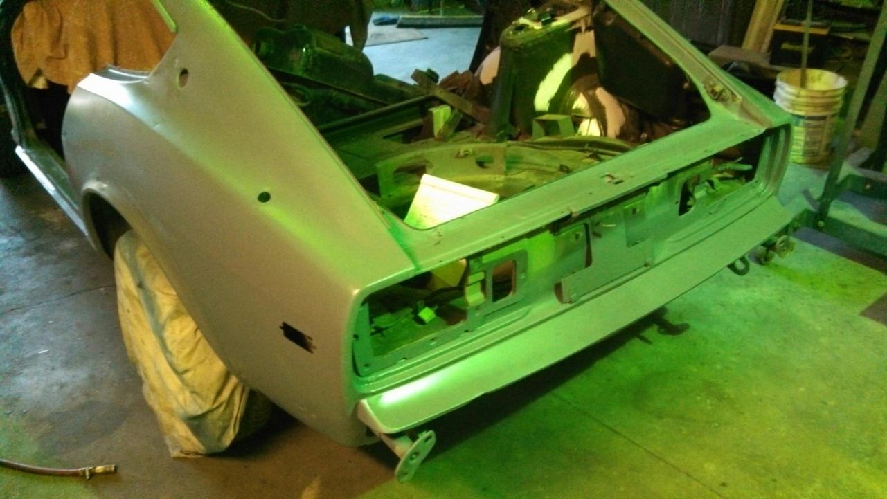

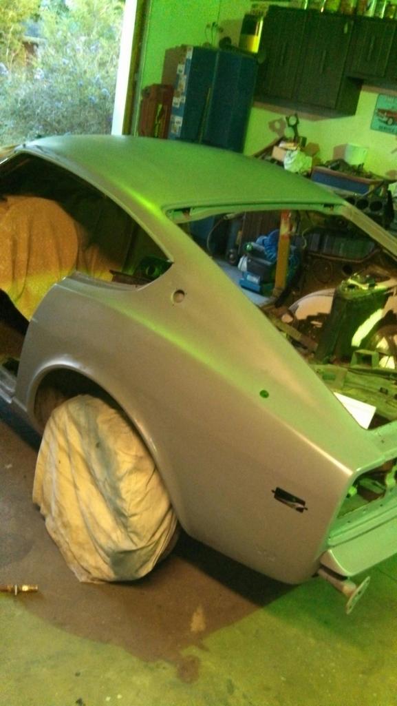

Made some killer progress this weekend. I should clarify what I mean by "Full Restore". Is it not going to be a trailer queen, but it will be a damn good weekend driver.
Got the paint 99% stripped. Spent many hours behind the blaster, while I had friends grinding and sanding. Looks like the driver door took a good wack, had a good amount of bondo on it. And the right rear quarter had some bondo where it took a good wack also. What's funny is I bought this car from the original owner and didn't even think to ask if it's ever been in a wreck, haha. Whoever did the body work did a really good job, the bondo was on there pretty good. But all and all it's nothing that's not repairable, it's just how it goes with 30 year old cars.

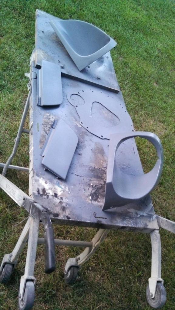

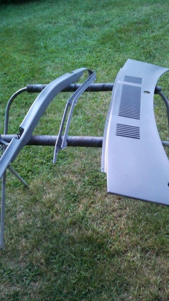

Back to body work. Got 2 coats of primer on so I can see exactly what kind of body work I'm looking at. Primer went on very smooth. Didn't get everything primed, but got a lot.
Both front fenders need patch panels welded on at the bottom and they have some other rust issues. I bought one patch panel last week so I could start working on it. After looking at them closer I said scratch that, and I ordered two new fenders from Black Dragon. Time is money and two new fenders will save some time.

Like most 280Z's its hard to survive 35 years and more without contacting something along the way. If it has not damaged the structure its ok. Panels, doors etc are fixable/replacable.
