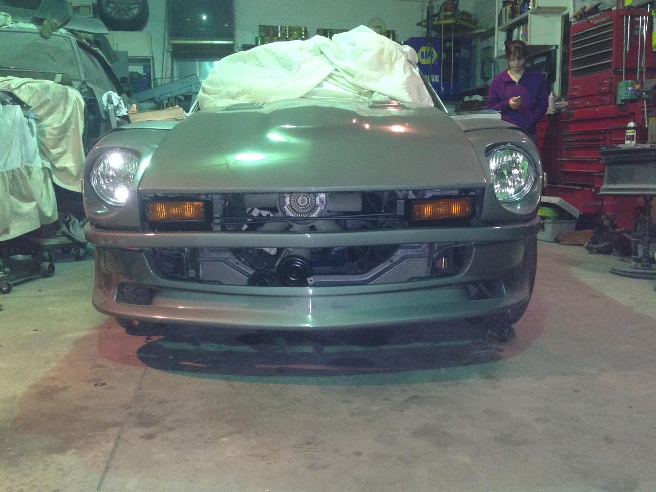

Your using the Xeon 280Z airdam? Im wondering what the "gap" distance between bonnet and top of the airdam is.
In your last photo, it looks like its a lot less than the standard valance panel. It should be less because its also replacing the small grille under the original bumper.

Is is the Xeon airdam, I really like the way it looks. I don't have the exact measurement on me, but I can measure it for you. I test fitted the top grill with the 240 bumper and I don't think it looks that bad. The stock 280 bottom grill is worthless with this setup. I'm not sure if I will leave the bottom space empty or try to make some sort of grill. That is something that I will figure out once I get the lights and top grill put in and can get a better overall picture of the front end.

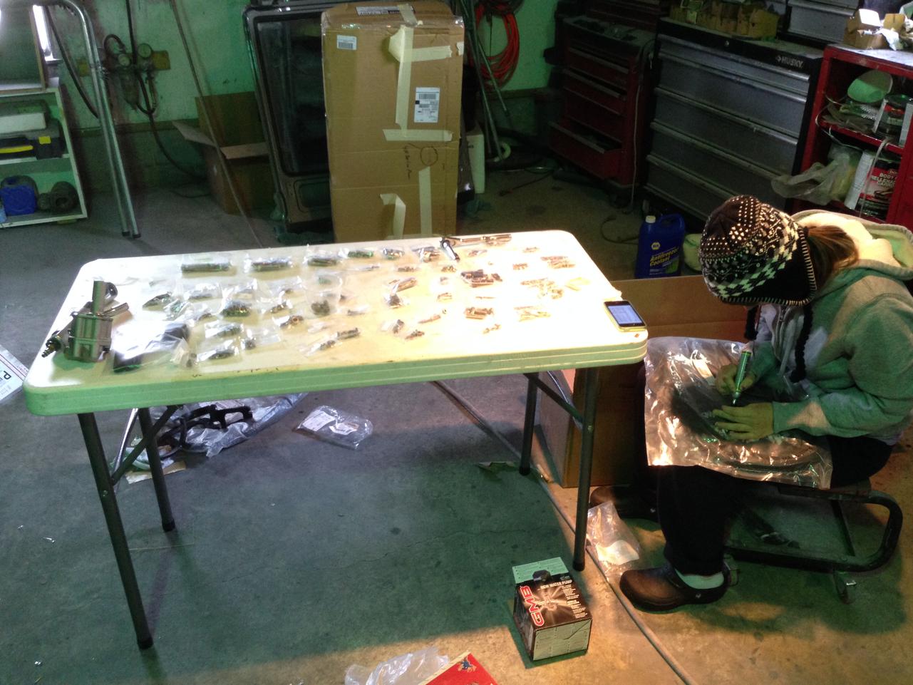

I ordered a bunch of stainless steel bolt kits, I laid them out so I could grab a bag when needed. These kits have already proven themselves! No more searching through my poorly labeled bag bolts for rusty bolts I have to clean. Now I have brand new bolts that are clearly labeled. Also had some help labeling all the weatherstripping bags to make finding them easier.

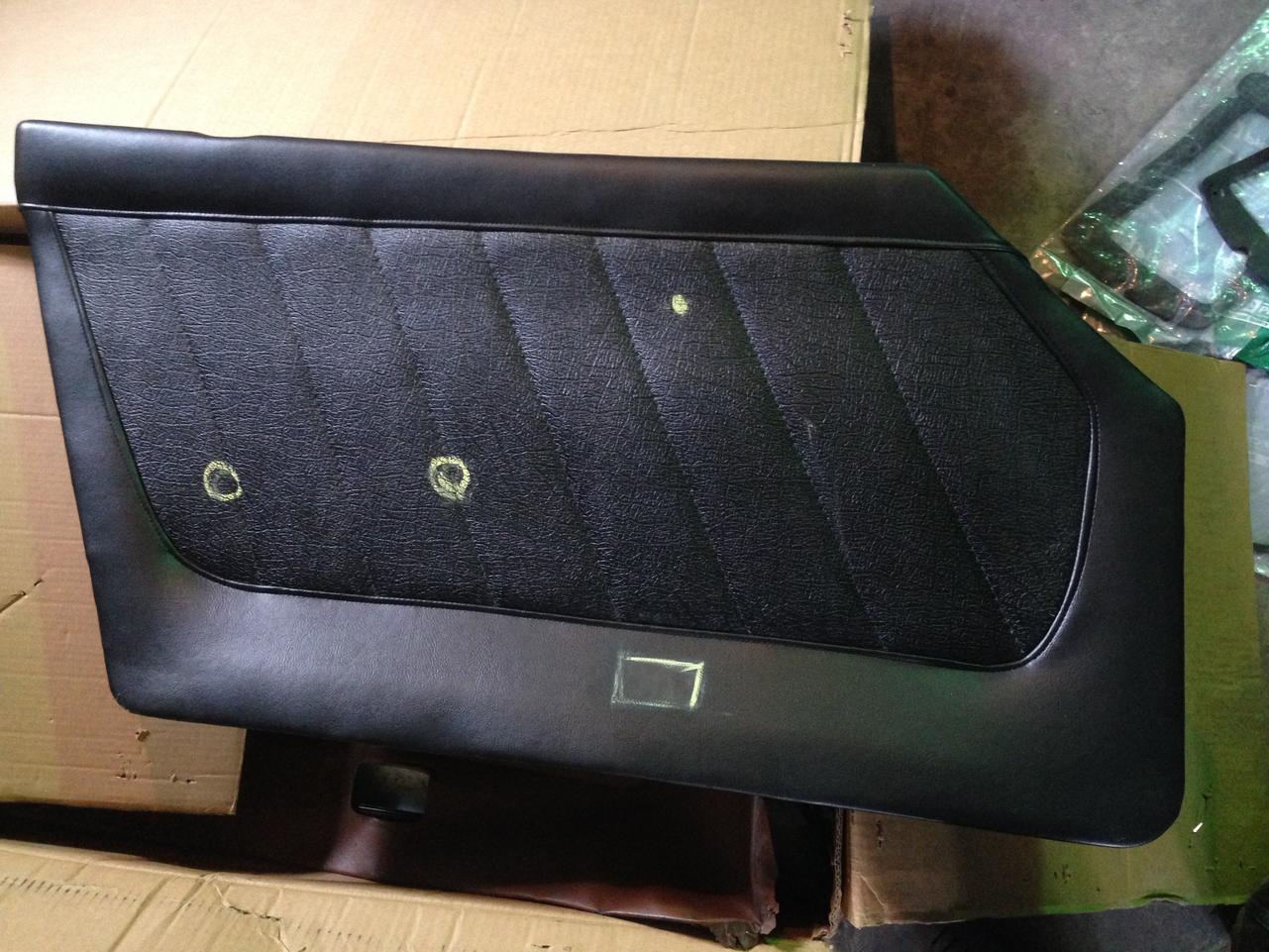

Got my door panels back from the upholstery guy, I bought all the interior pieces from Z Car Source. I didn't realize the design was different from factory. Not many options though when buying a new interior, so I'll take it.

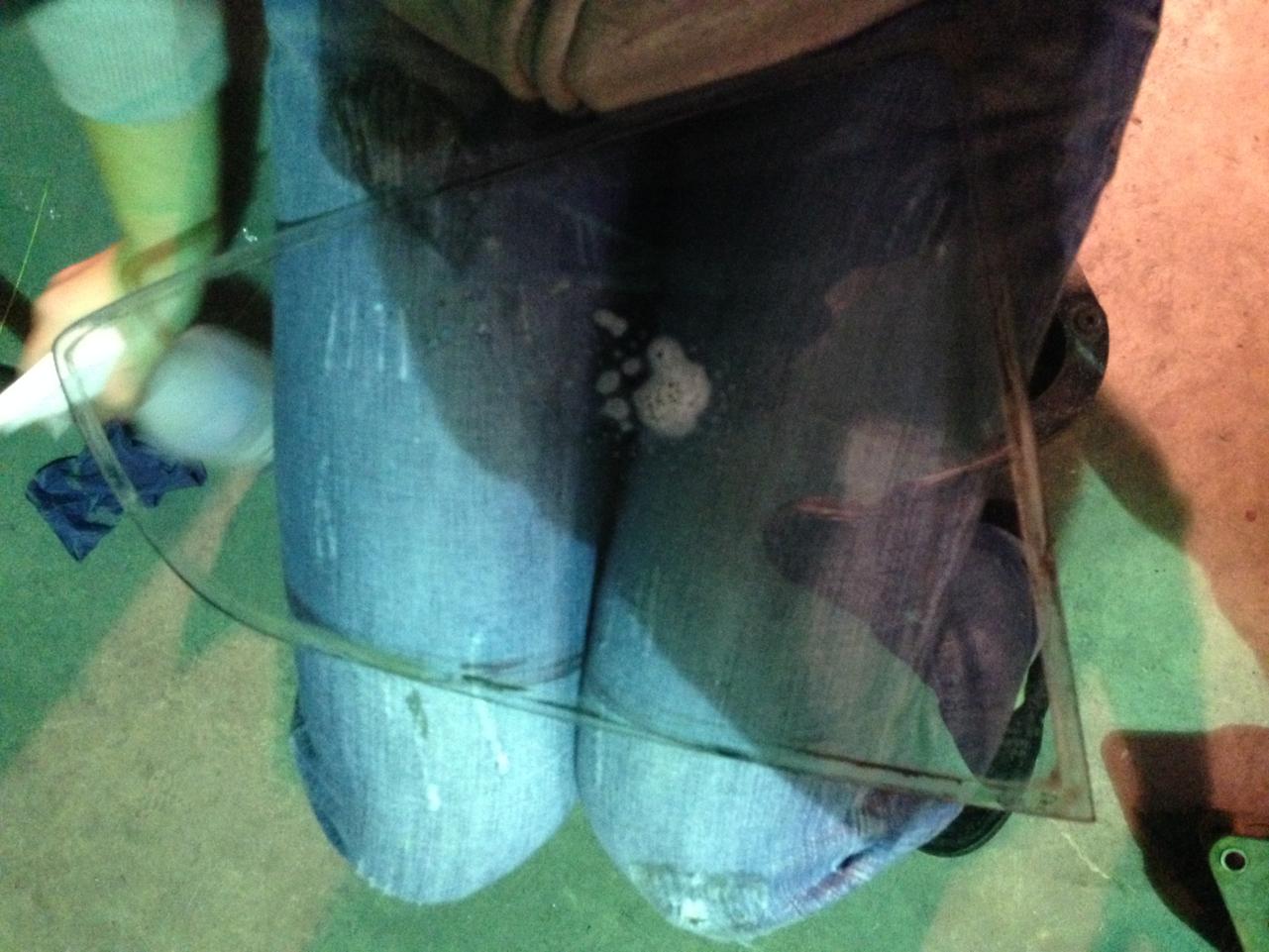

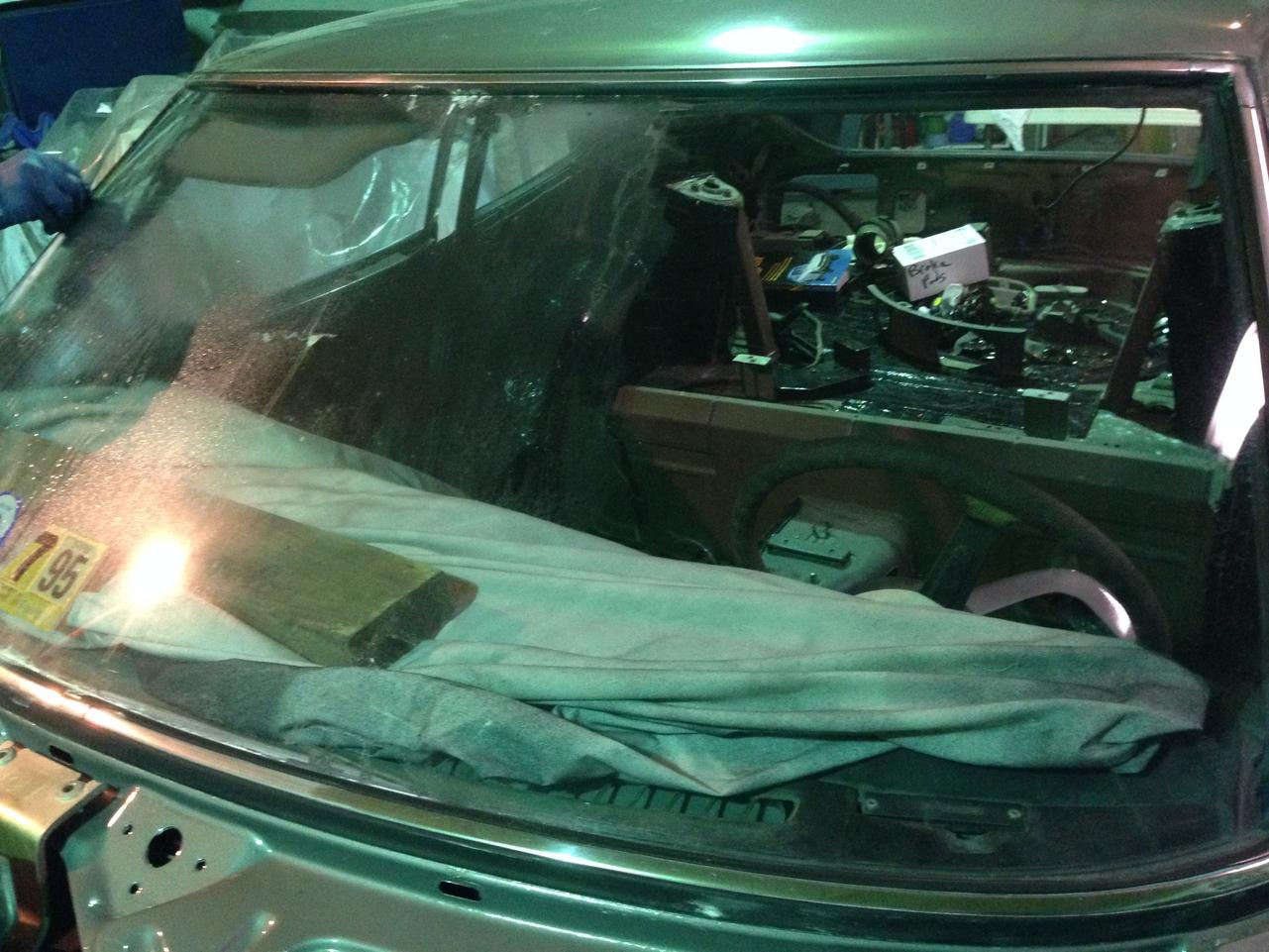

All window chrome polished and windows cleaned with a razor blade. Glass looks brand new! A shot of my half cleaned window. Notice the '95 inspection, I'm thinking I'll keep it on their for kicks.

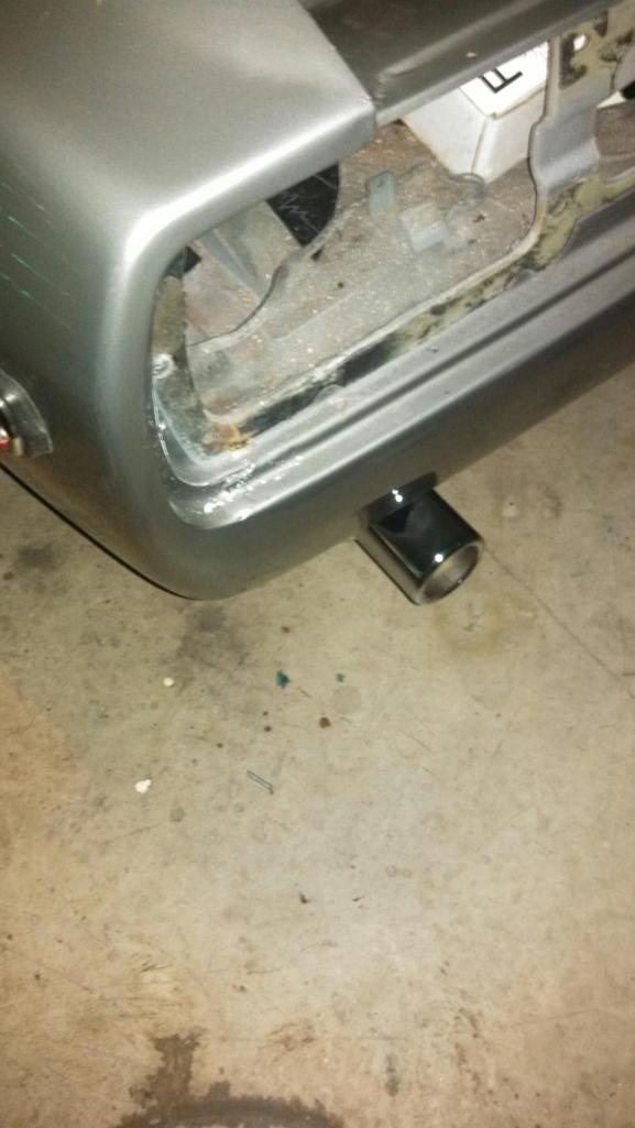

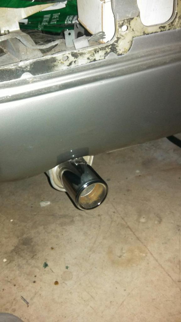

Lastly got the muffler installed and tucked up nicely. I put the header back exhaust on a couple of weekends ago, now it's finished up with the muffler installed. The chrome tip that came with the MSA exhaust kit stuck out way too much. Cut it in half and welded it on. I'm glad the muffler was able to be tucked in, I don't like the look of seeing half the muffler hanging out below the car. I've also been debating on whether to put the 240 rear bumper on. It has already been fitted and painted, but I'm really liking the way the rear looks without a bumper. All the holes were completely filled in before painting, so if I leave it off, everything is smooth.

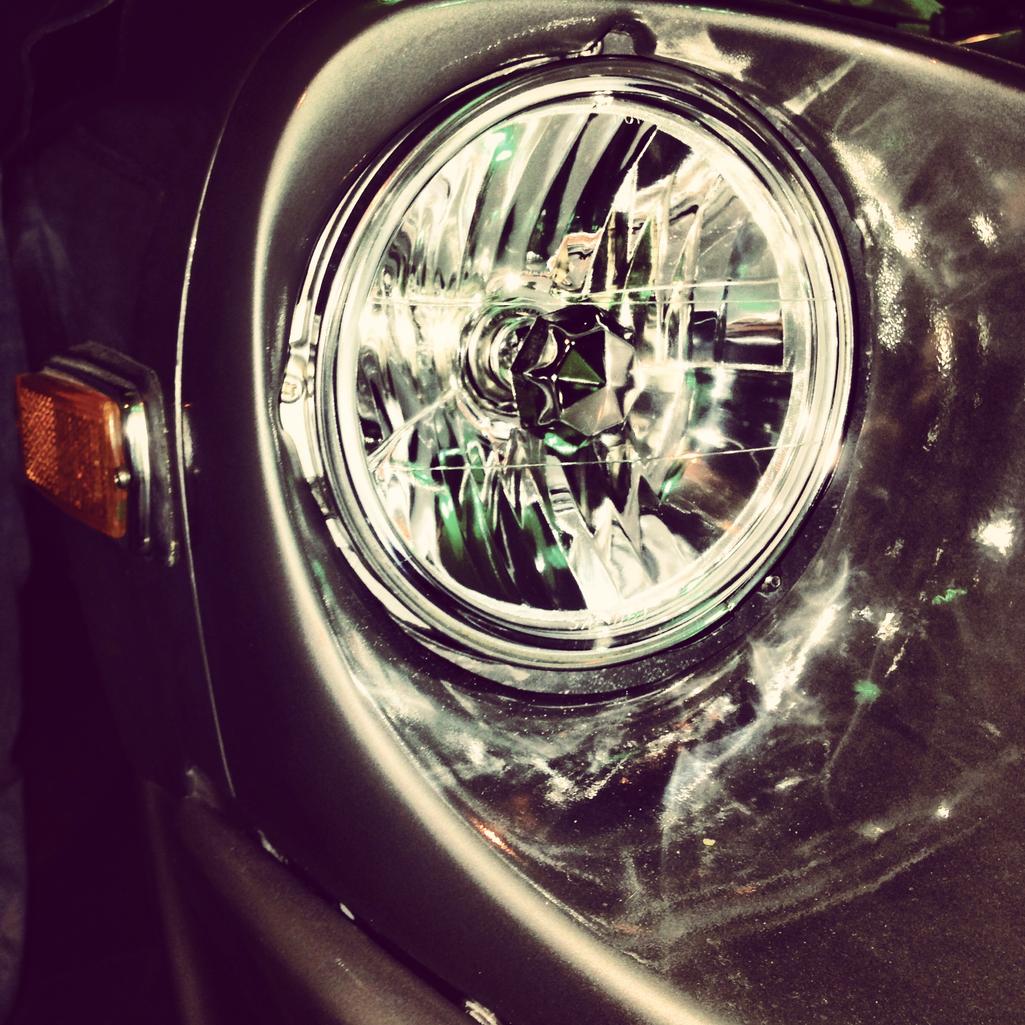

New headlights and blinkers in. The blinkers I cleaned in the dishwasher and they came out great! I love the crystal clear headlights.
The front end is looking sharp! Still need to get the grill made up.

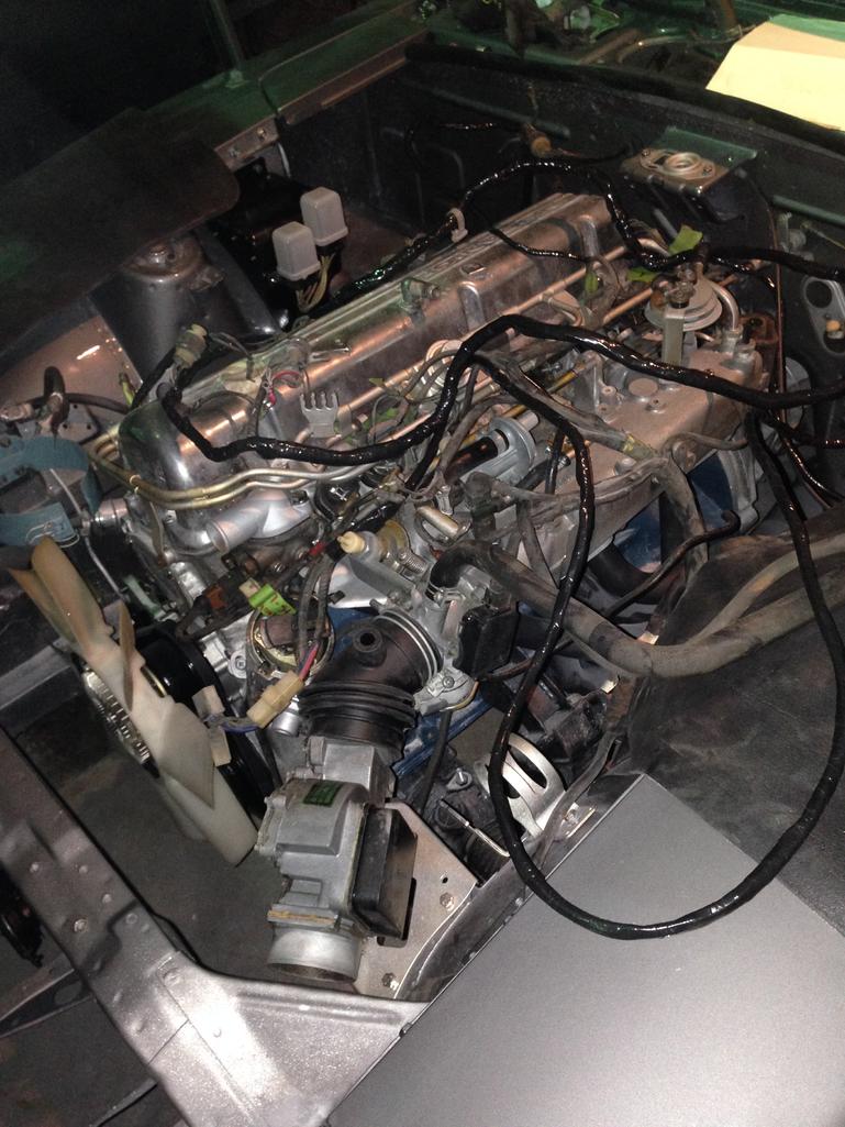

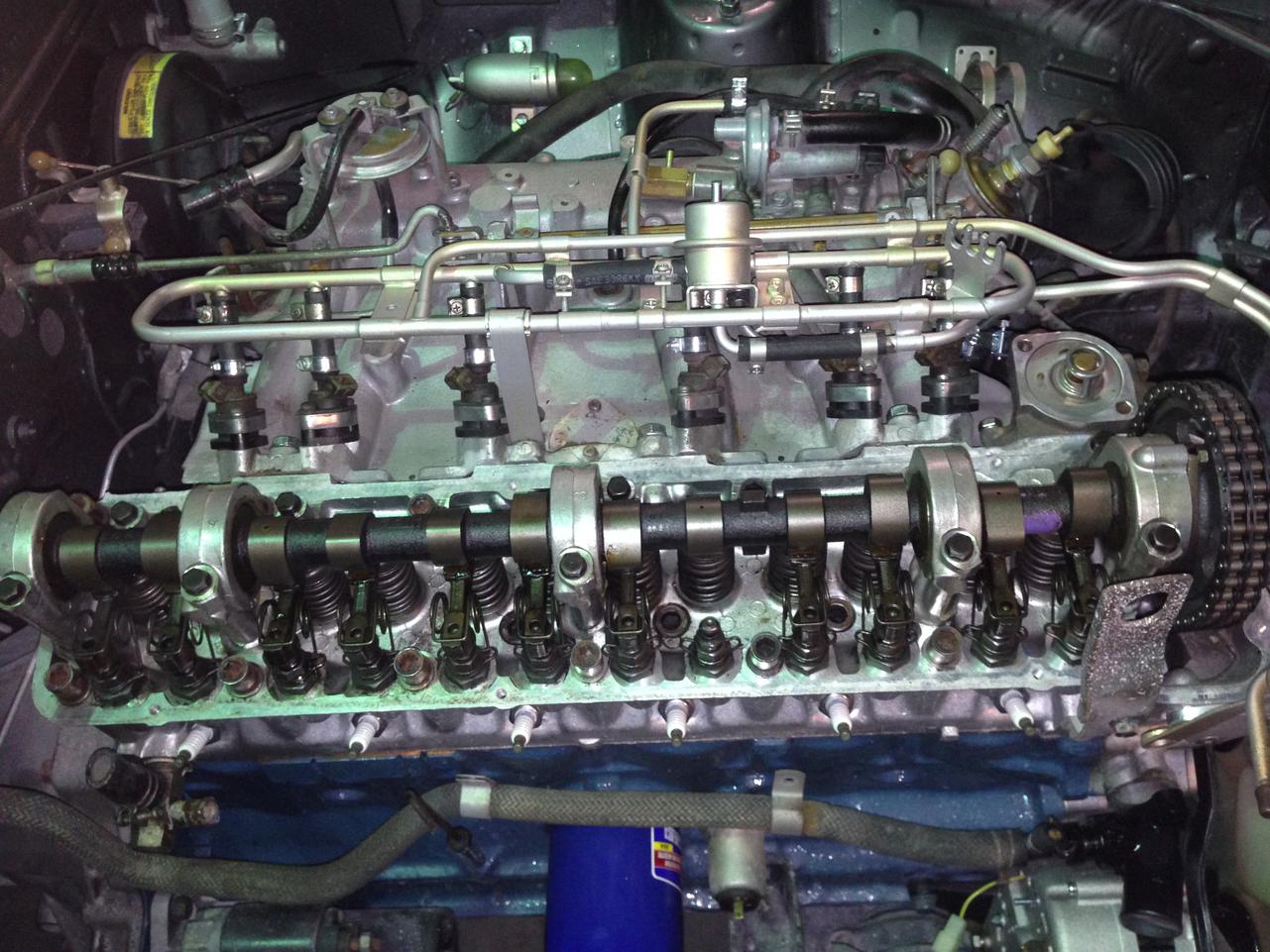

Got the fuel injection rail repainted and put in. I also re-taped the entire engine bay wiring harness, it looks much better. I hooked up the fuel injection wiring harness and some of the engine harness. It's hard to get the wires to look clean.
Wire harness looks sharp, harness laying across the engine.

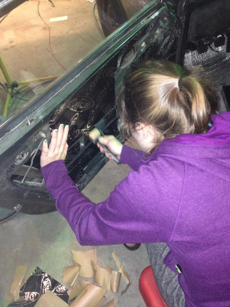

Had the misses in the garage helping. She did the sound dampening on the doors. Hopefully it helps some.post-25778-14150826878997_thumb.jpg

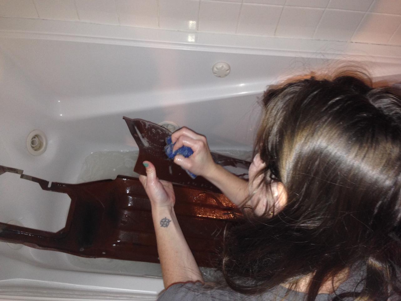

She also washed all my plastic interior parts, getting them ready to be painted black.

Hey Michael, looking at pic #3 you have the thermostat in upside down. You didn't button her up that way did you?
You know, I'm not sure. I will pop the cover off and double check. I remember looking at it and wasn't quite sure which way it went. Thanks for the catch!! Really appreciate it.
Whose Goat?
rcb is right. Topsy-turvy.
