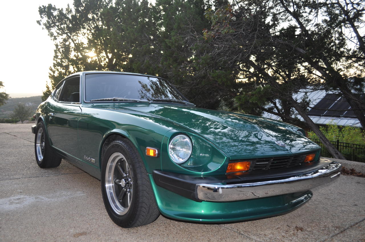

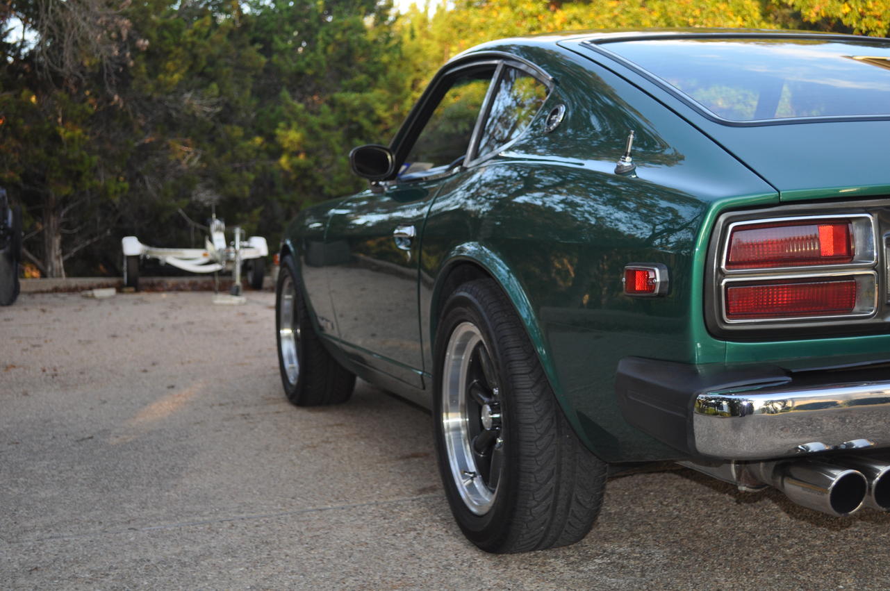

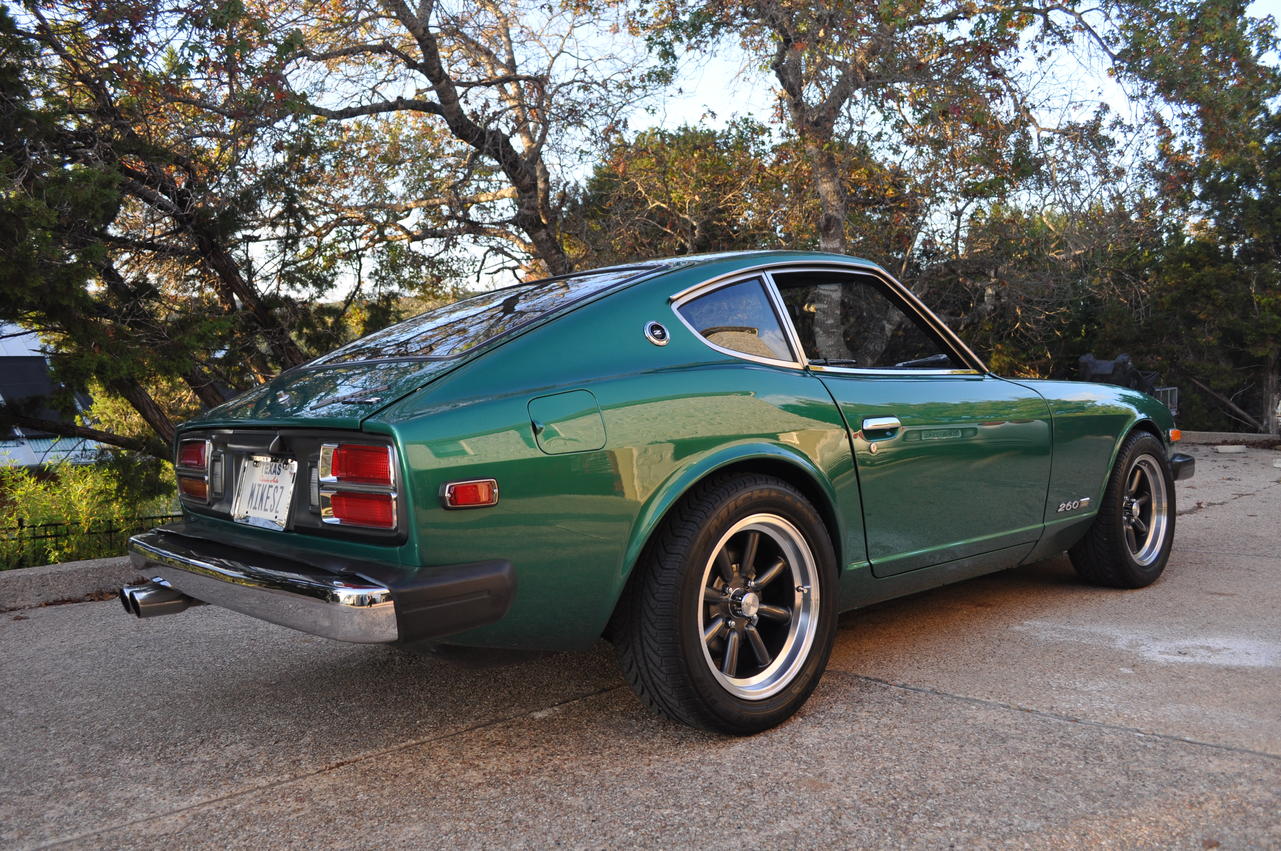

August 4, 201311 yr comment_429067 I run Konig 16 X 7 0 offset with 225-50 Michelin Pilot Sports and no issue with the center caps at all. Car has never handled so well. Only issue I had was some very slight rubbing on the rear tires at the top of the fender well when I would go over large bumps in the road. A slight roll of the rear fenders cured that problem. Here's a few pictures so you get an idea of how they look. Mike. Link to comment https://www.classiczcars.com/forums/topic/47127-konig-rewinds/#findComment-429067 Share on other sites More sharing options...
