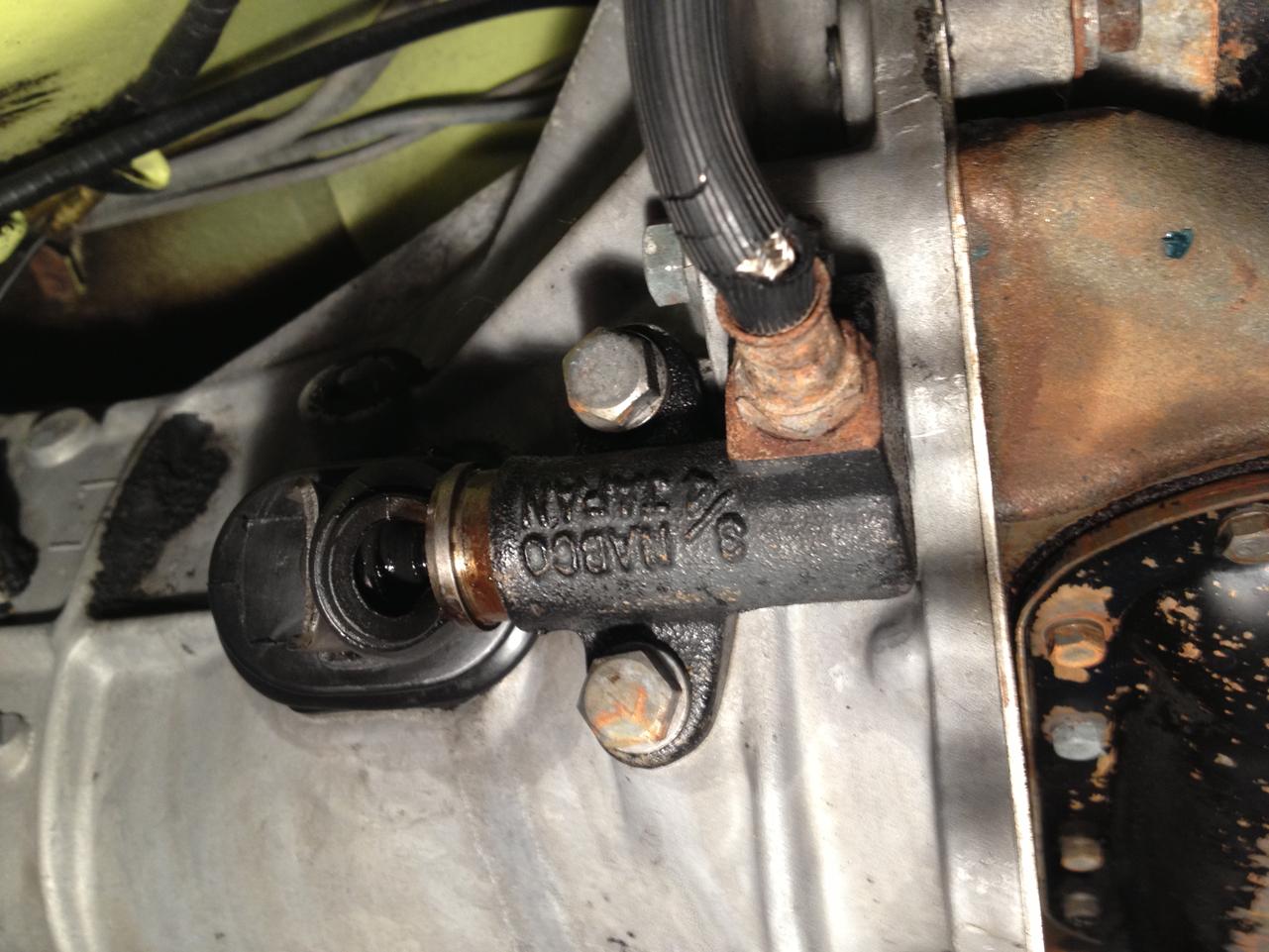

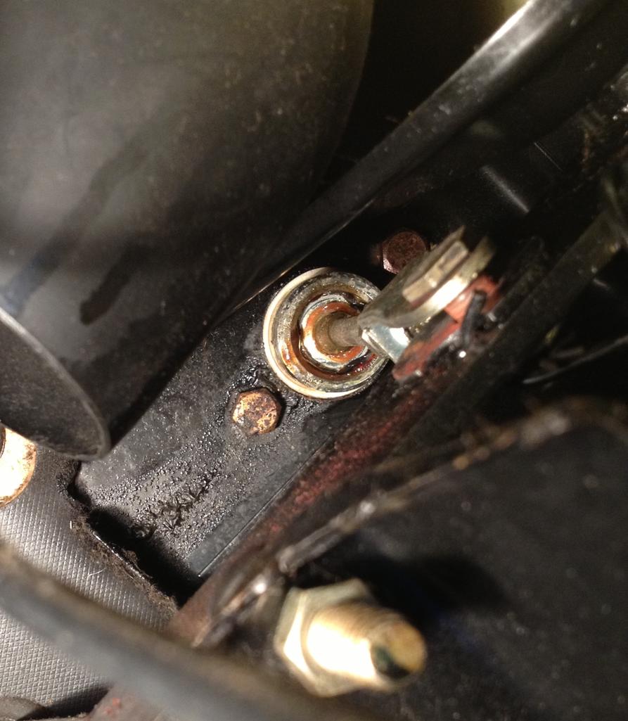

Ok, I did my inspections and found:
1. Clutch fluid reservoir is low.
2. Evidence of fluid leakage at master cylinder in cabin. (see photo)
3. Evidence of fluid leakage at slave cylinder when rubber boot was pulled back. (see photo)
4. Rubber sleeve at flexible line at slave cylinder decayed/broken. (see photo)

If the master is leaking, it should be swapped. I tend to follow the line of reason that you may as well do both at the same time and avoid having an issue pop up later. The line will obviously need to be replaced, as well.
These parts are fairly cheap, may as well take care of all of it at once.
If you've got evidence of leakage, I'd replace 'em! You sound on the right track with both cylinders and the flex line. That flex line looks pretty end of lifespan to me.
All those parts are available pretty inexpensively at RockAuto.
As far as clutch friction parts, it's not surprisingly at all if it slips with the pedal partially depressed, clutches are designed to slip when you put the pedal down, what you would need to worry about is if it slips under load when you're not touching the clutch, which you shouldn't be touching the clutch unless you're changing gears (I don't wanna accuse anybody of anything, but just make sure we're at square one in case we need to be! Riding the clutch has worn out many a clutch unnecessarily.)
OK, sounds good. I'll go ahead and order the parts and replace and hopefully that will solve the problem. I think I'm now on the right track though since my clutch pedal isn't all that firm and the clutch doesn't slip under load. We shall see...
Thanks again for the help!
Bad master for sure. The boot on the slave looks shiny, indicating a leak there as well. Unless you have an urgent need for the car don't waste time filling or bleeding before replacing the bad parts.
Bench bleed the new master, install new slave, hook up the line and you should be able to gravity bleed the slave.
While replacing the interior pin on master rod, look for rounding out of the hole in the pedal where the clevis pin goes thru. Can add some slop when you need to adjust. Might have to add a bushing to tighten it up.
Pretty straight-forward install, couple of fun hours and you'll be well rewarded.
