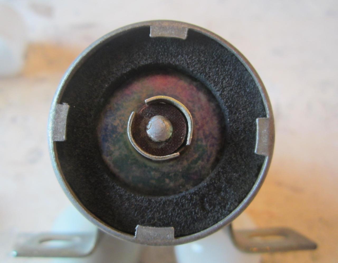

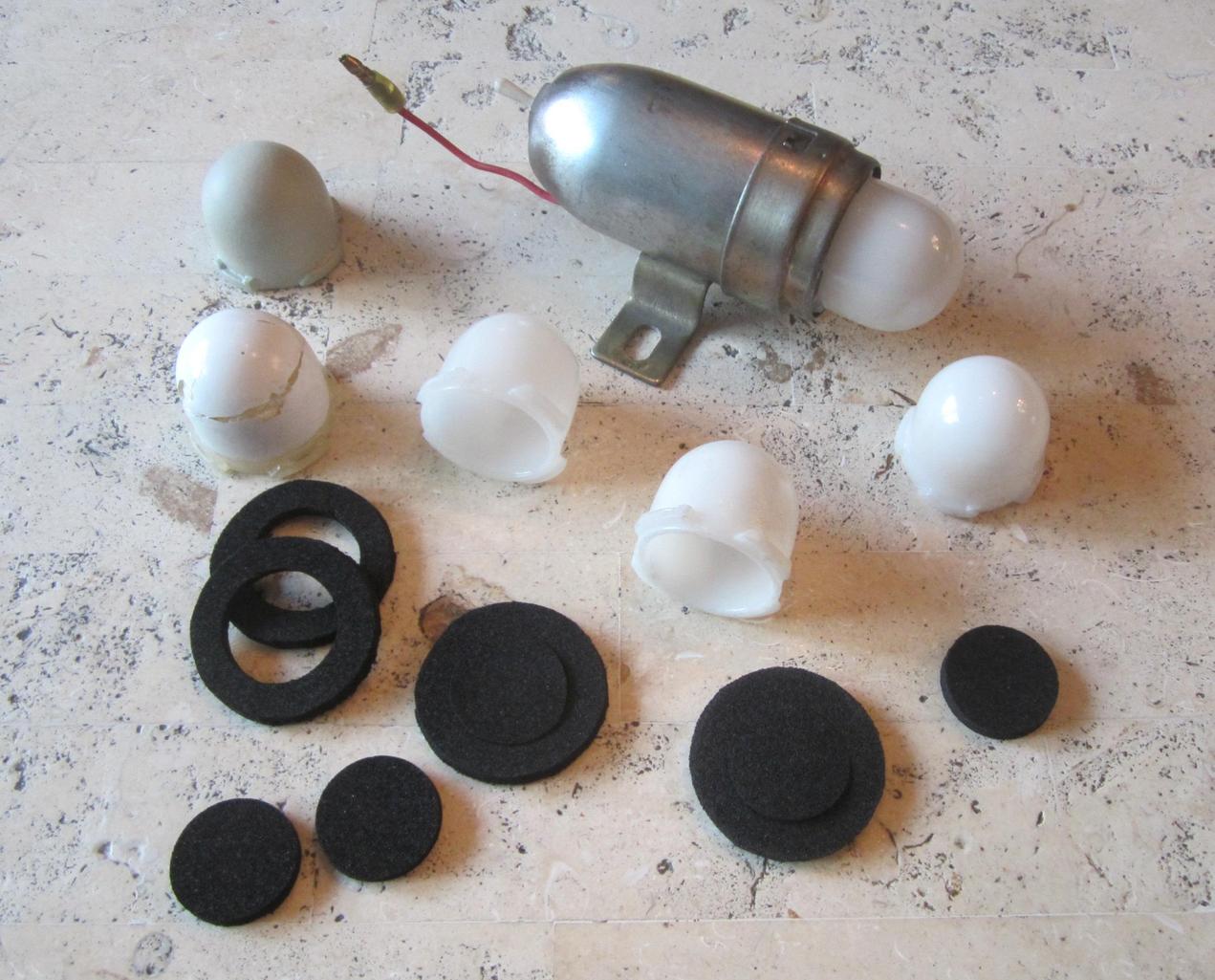

I stamped mine out of rubber foam. Its about 3mm thick and works well. Mike, I think the original (on mine) was a silicone rubber gasket with a clear adhesive ring to attach it to the lens holder. The adhesive in mine turned brown and brittle. The silicone just crumbled in my hand.
I also made a mould for the lens, but its 2mm to high to send as regular post and therfore cost €16.00 to ship anywhere outside The Netherlands:disappoin Started making a shorter version, but other more important projects keep interrupting planning. Now winter is coming Ill finish it. See blog for details

I just made some photos of the ones I made some time back. The one I am using in the car is 2 years old and no signs of wear.
The rubber foam Im using is used as a vibration insulator in truck bodies so it should hold up to the conditions its in without any problems. The grey/green lens is a 3mm shorter mock up for a new mould. It still needs polishing. The photo doesn't show the height difference all that well, but it is a little shorter.
Chas
That looks like an improvement to what was in there originally. I have never seen that material in the usual auto parts stores; is there anything else that you could get at the DIY stores, like Home Depot, or even a fabric store?
