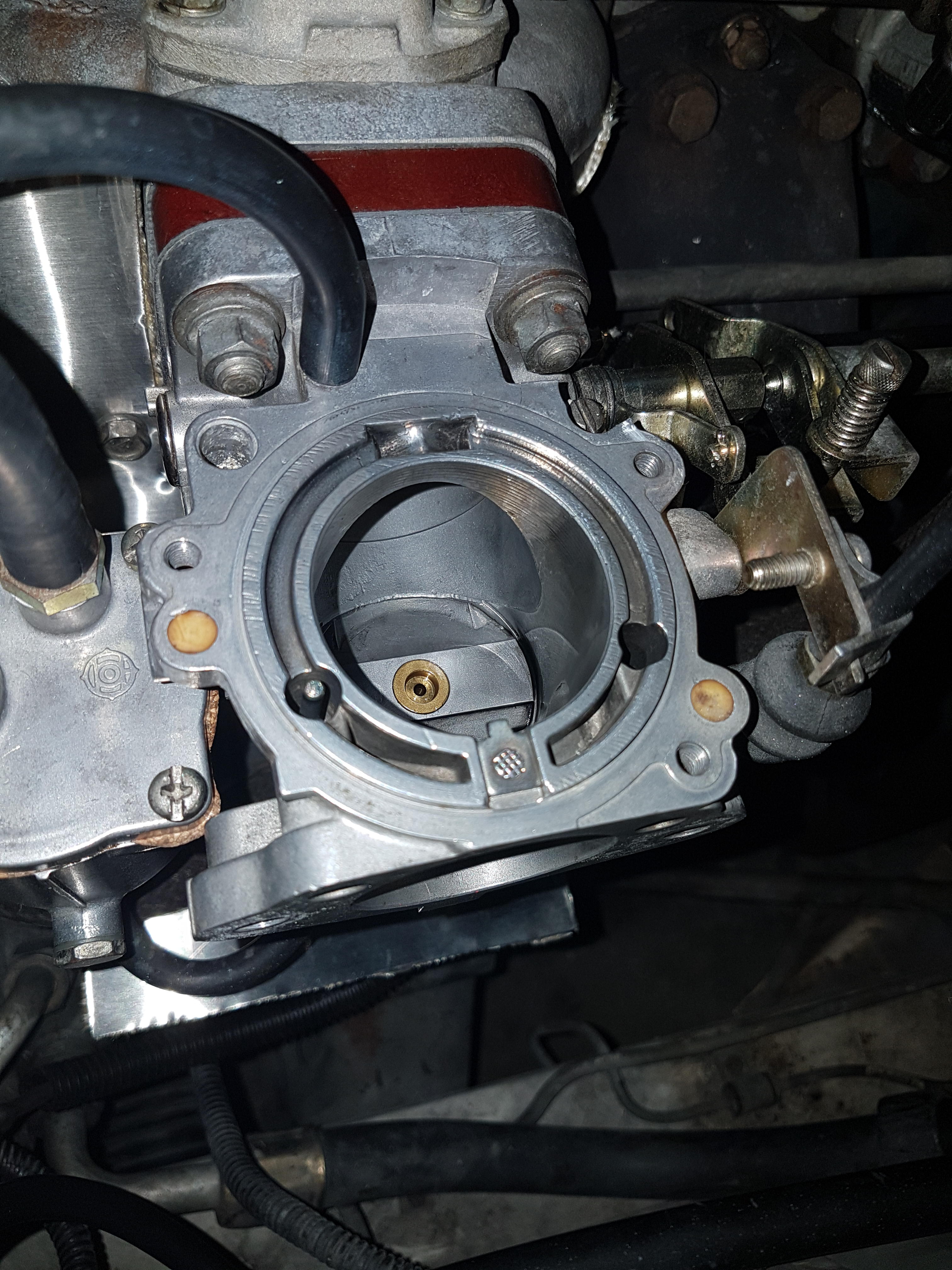

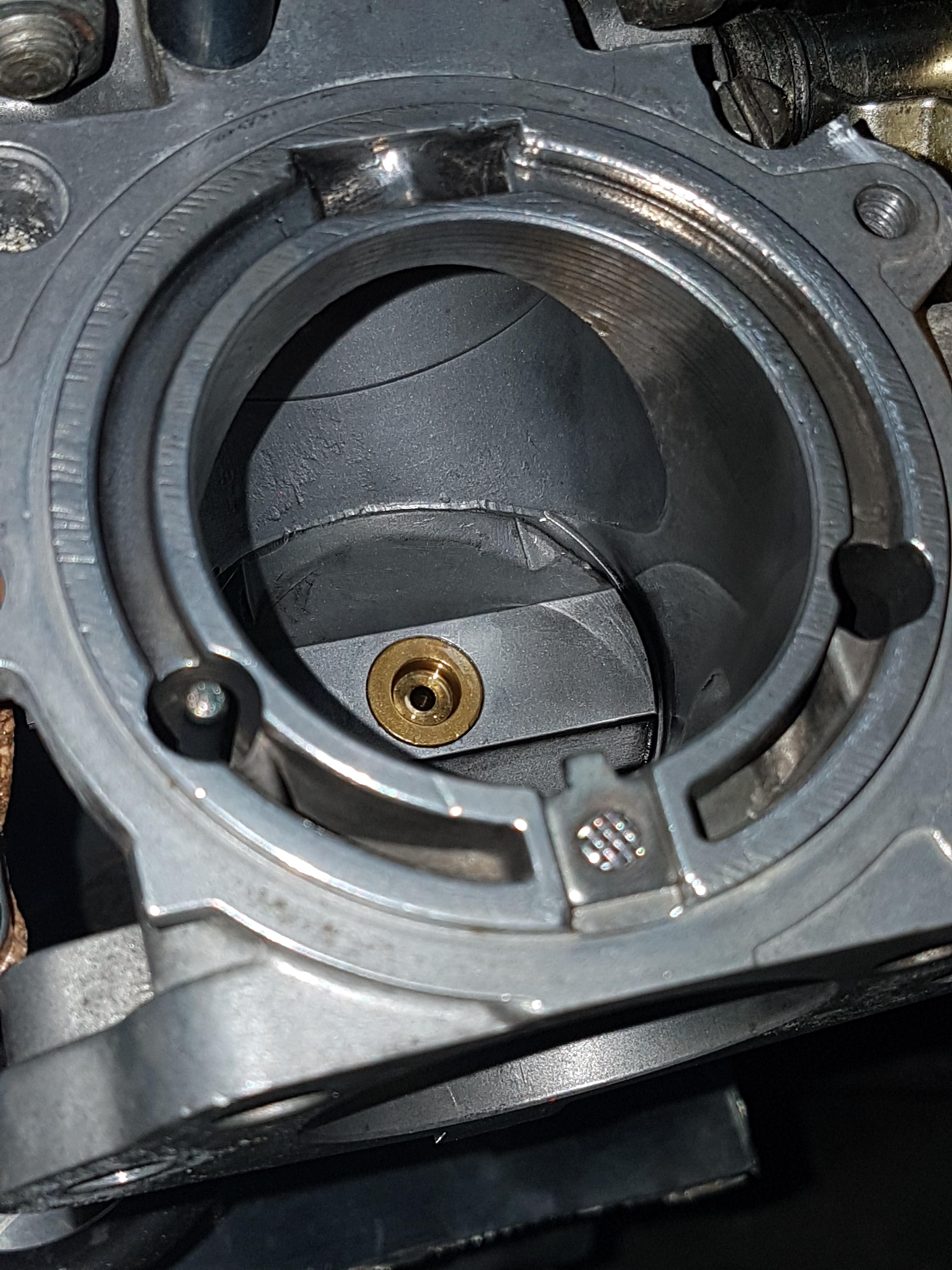

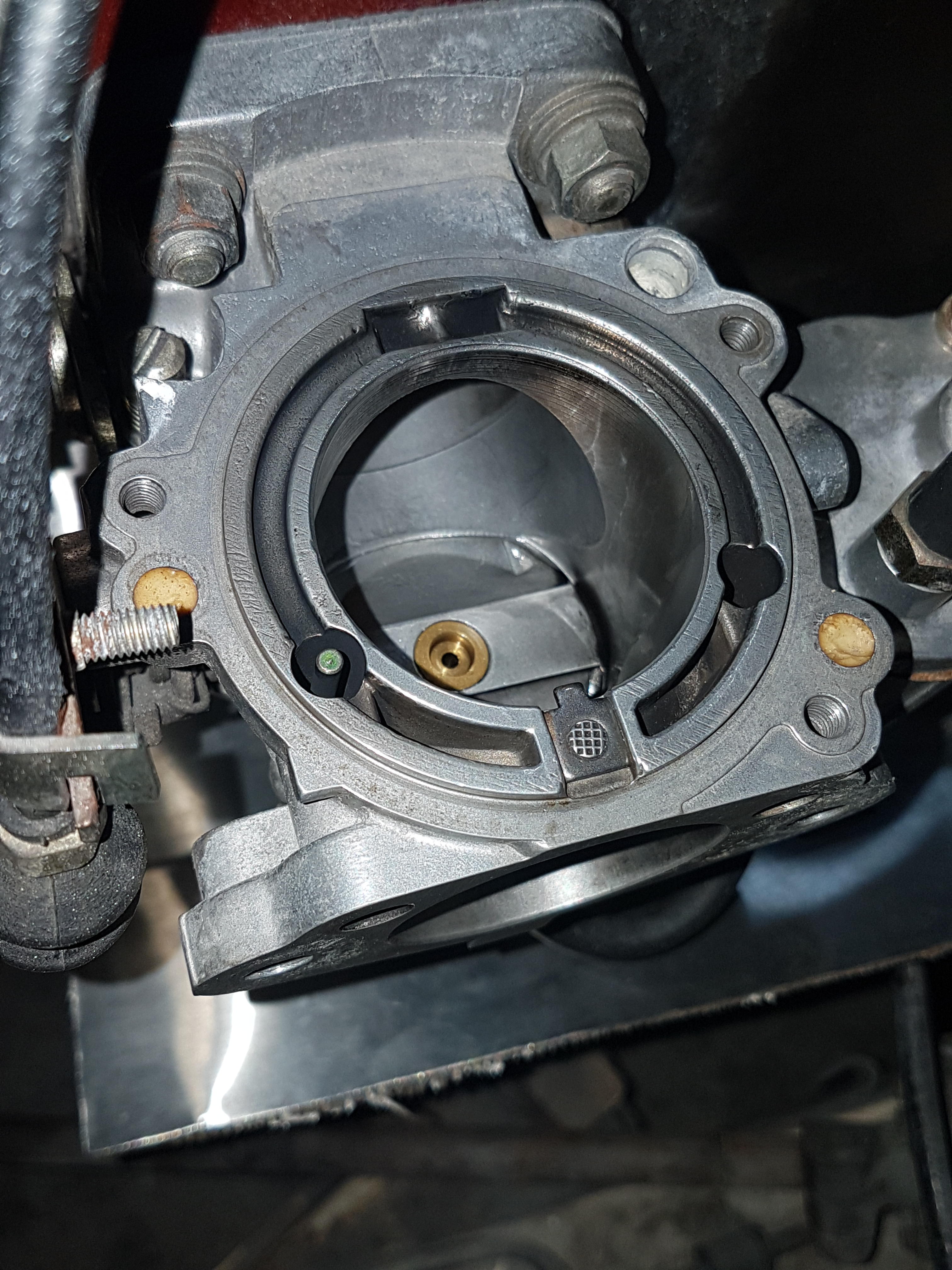

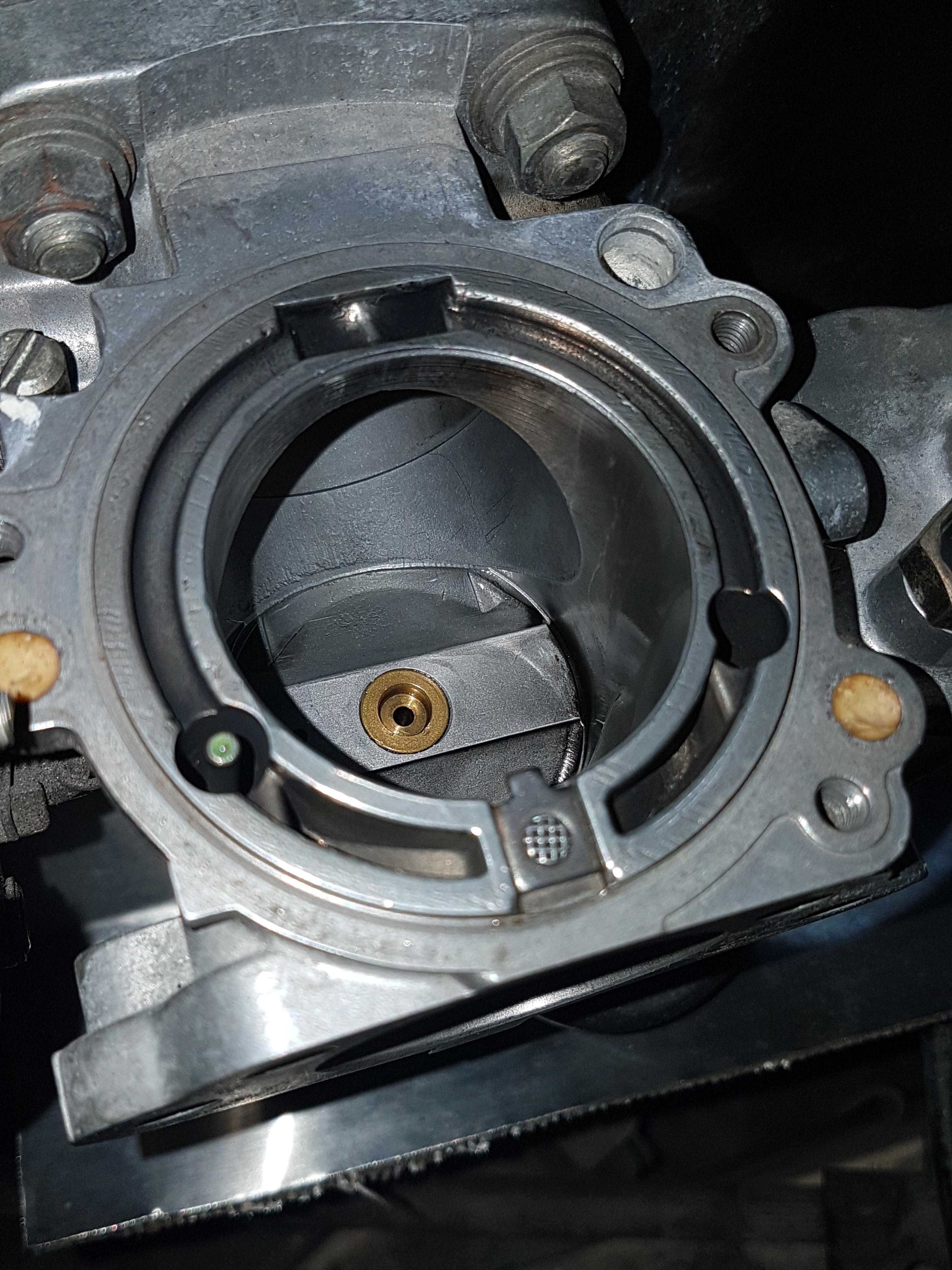

March 6, 20187 yr comment_543947 2.5 turns clockwise front and rear carb after cranking and running the engine for 1 min. I dont see no 1/16 inches of gas? Do you see it Link to comment https://www.classiczcars.com/forums/topic/47304-1972-float-adjustment/?&page=20#findComment-543947 Share on other sites More sharing options...
March 7, 20187 yr comment_543952 Nope. I'm not surprised. Try shining a light down the nozzle and try to determine how far down the fuel is. You could also try using the small tube from an aerosol can like WD-40 and try using it like a dipstick to determine the depth. One way or another the distance from the float to the lid has got to be reduced. Link to comment https://www.classiczcars.com/forums/topic/47304-1972-float-adjustment/?&page=20#findComment-543952 Share on other sites More sharing options...

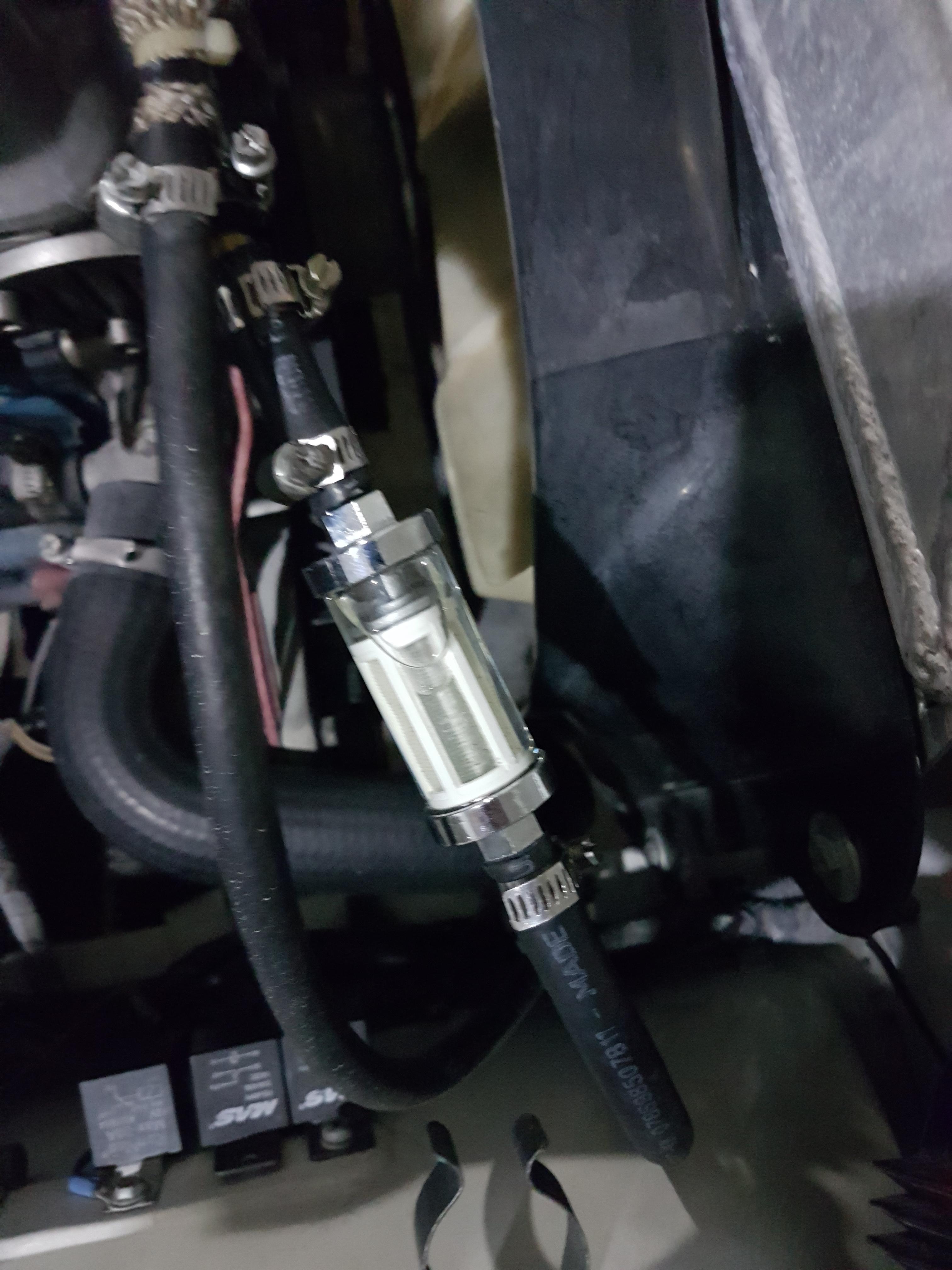

March 7, 20187 yr comment_543955 Ill have to lower it more car is still backfiring and sputtering under 4 turns clockwise. I really dont trust to pressure of this airtex 8012sx fuel pump. In the past when i the pressure was 4.3 psi the fuel filter was always full even after the engine was shut down. Link to comment https://www.classiczcars.com/forums/topic/47304-1972-float-adjustment/?&page=20#findComment-543955 Share on other sites More sharing options...
March 7, 20187 yr comment_543958 IGNORE the fuel filter. The fuel level is fine. Trust me. I've seen lots of them this way, including mine, which ran fine half full for decades. IGNORE the backfiring and sputtering. Until the floats are confirmed to be set properly, set your nozzles back to 2 1/2 turns down. RESIST the temptation to fine tune with the mixture screws until the floats are set. FOCUS on getting the float level 1/16" below the nozzle tops at 2 1/2 turns down. You can't compensate for a wrong float setting with the mixture screws. It doesn't work. If the fuel level is wrong, it won't be at the needle idle stage and will continue to be off throughout all RPMs. Link to comment https://www.classiczcars.com/forums/topic/47304-1972-float-adjustment/?&page=20#findComment-543958 Share on other sites More sharing options...
