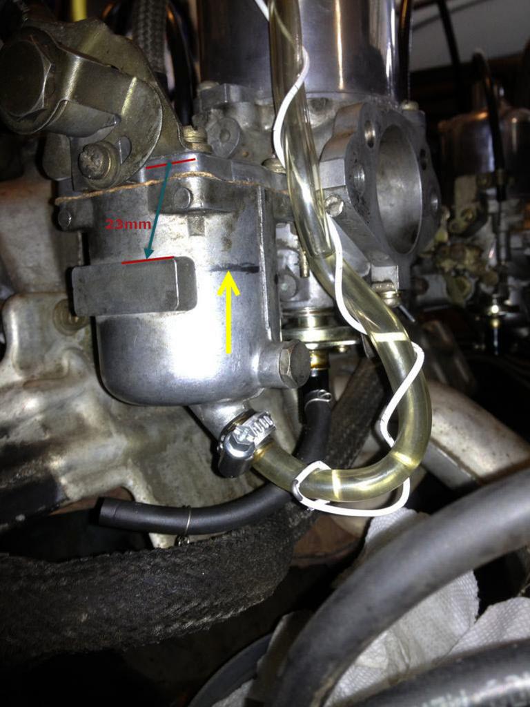

Back to the floats hitting the bottom of the lid or a less than optimum relationship between needle valve stem and float tang.  I simply eliminated the needle valve body sealing washer, thereby "raising" the valve assembly and helping with the float tang geometry and float position when valve closes.  I used a mark on the outside of the float bowls (both 23mm down) and clear tubing in place of bowl to nozzle hose to check level while engine running (engine ran on one carb during test).  Sparks plugs all have same color (so front and back three cylinders getting similar amounts of fuel).
That's the quickest and easiest "close enough" check I've ever done.  Worked good enough for me to see how far off mine were and desperately needed more adjusting.

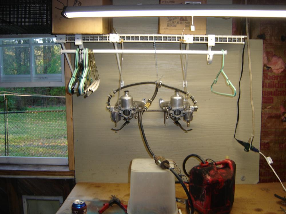

This is a photo from zkars or jarvo2, maybe both?  Simple to do.
Here's how high mine were, if you can see the fuel in the hose way up high where the float chamber meets the lid's top.
Forgot to add I did this off the car with an electric fuel pump but it can be done a lot easier on the car.  I was rebuilding the motor at the time.

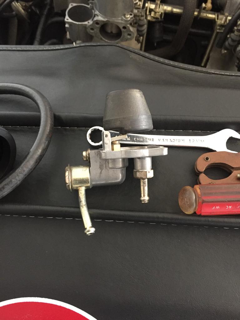

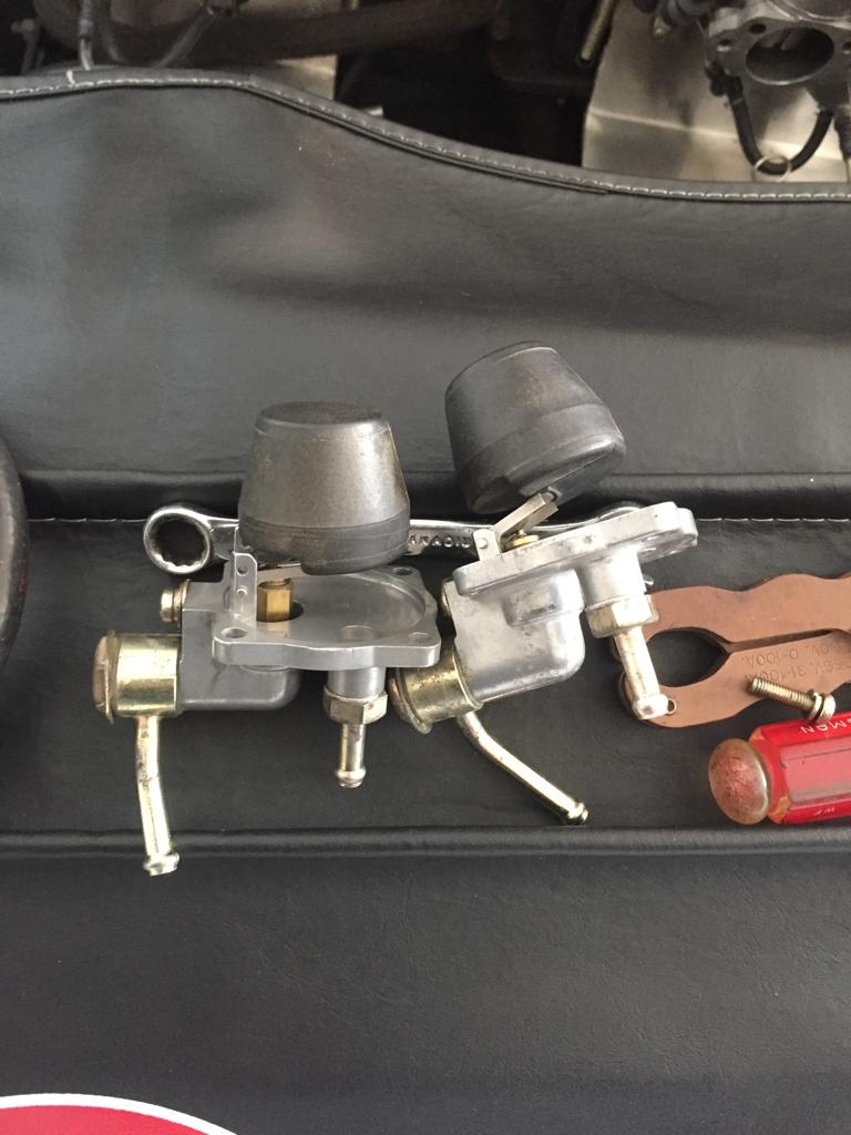

My mechanic drilled extra holes to the ears of the front float lid in order to get a precise fuel level at the float chamber. He set the front carb to 3.5 turns and the rear to 2.5 turns clockwise. Anyway we will test the car tomorrow in traffic.
