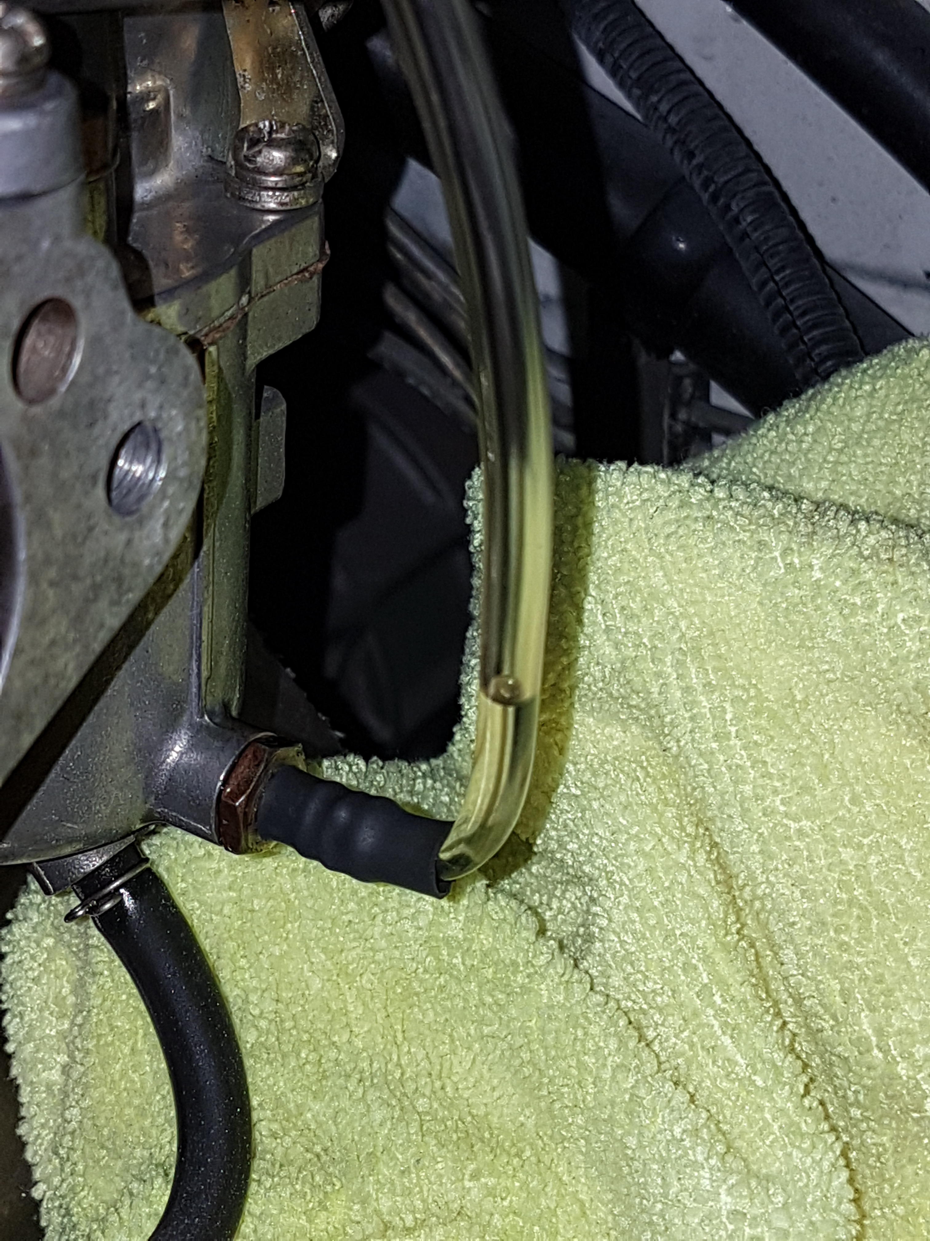

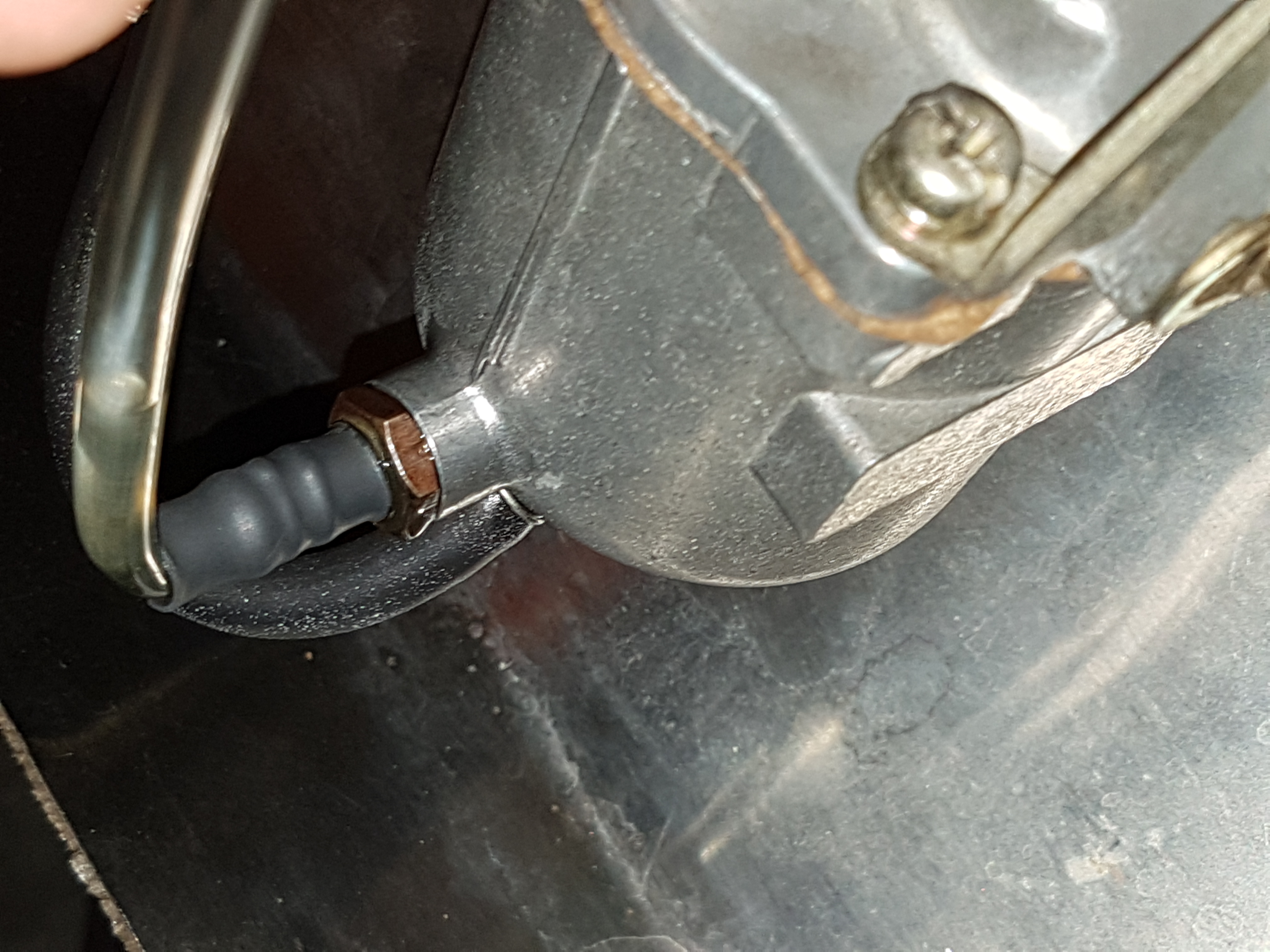

March 19, 20187 yr comment_545036 2 hours ago, Mark Maras said: Yes. Then start it up, shut it down and check the fuel levels again in both carbs at 2 1/2 turns to be sure the fuel level isn't too high and pooling on top of the nozzles. This means the gap between the float and lid will be much less than .55 or 9/16 inches?????? Link to comment https://www.classiczcars.com/forums/topic/47304-1972-float-adjustment/?&page=31#findComment-545036 Share on other sites More sharing options...
March 19, 20187 yr comment_545037 2 hours ago, Mark Maras said: Yes. Then start it up, shut it down and check the fuel levels again in both carbs at 2 1/2 turns to be sure the fuel level isn't too high and pooling on top of the nozzles. This means the gap between the float and lid will be much less than .55 or 9/16 inches?????? Link to comment https://www.classiczcars.com/forums/topic/47304-1972-float-adjustment/?&page=31#findComment-545037 Share on other sites More sharing options...

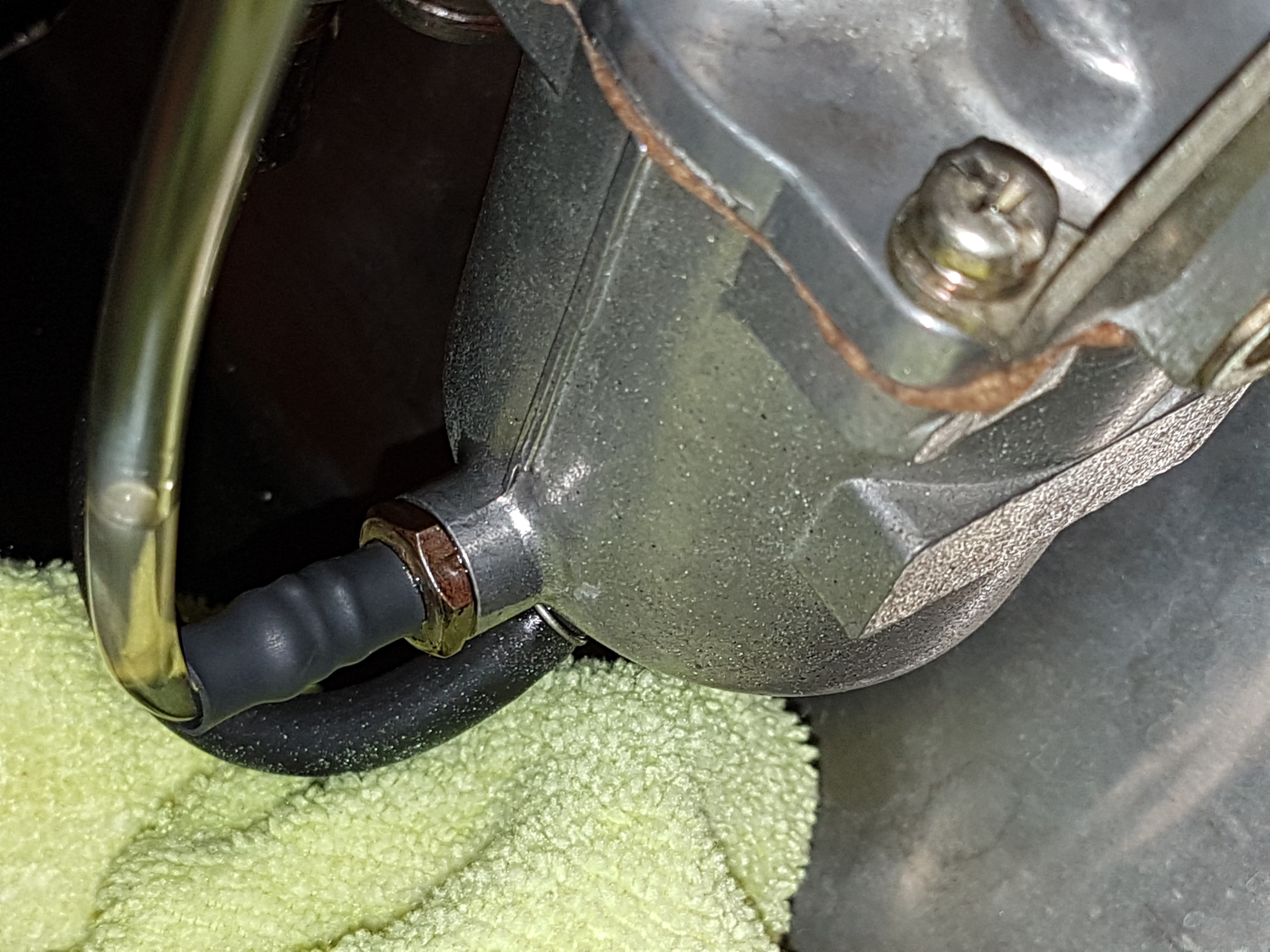

March 19, 20187 yr comment_545049 20 minutes ago, jalexquijano said: This means the gap between the float and lid will be much less than .55 or 9/16 inches?????? It would be better to see where the fuel level is before readjusting. Pull the domes and pistons (not the float covers). When you pull the choke on, the nozzles will lower and you'll be able to see the fuel level above the nozzles. Look and see if the rear carb fuel level is close to the front carb level. Link to comment https://www.classiczcars.com/forums/topic/47304-1972-float-adjustment/?&page=31#findComment-545049 Share on other sites More sharing options...

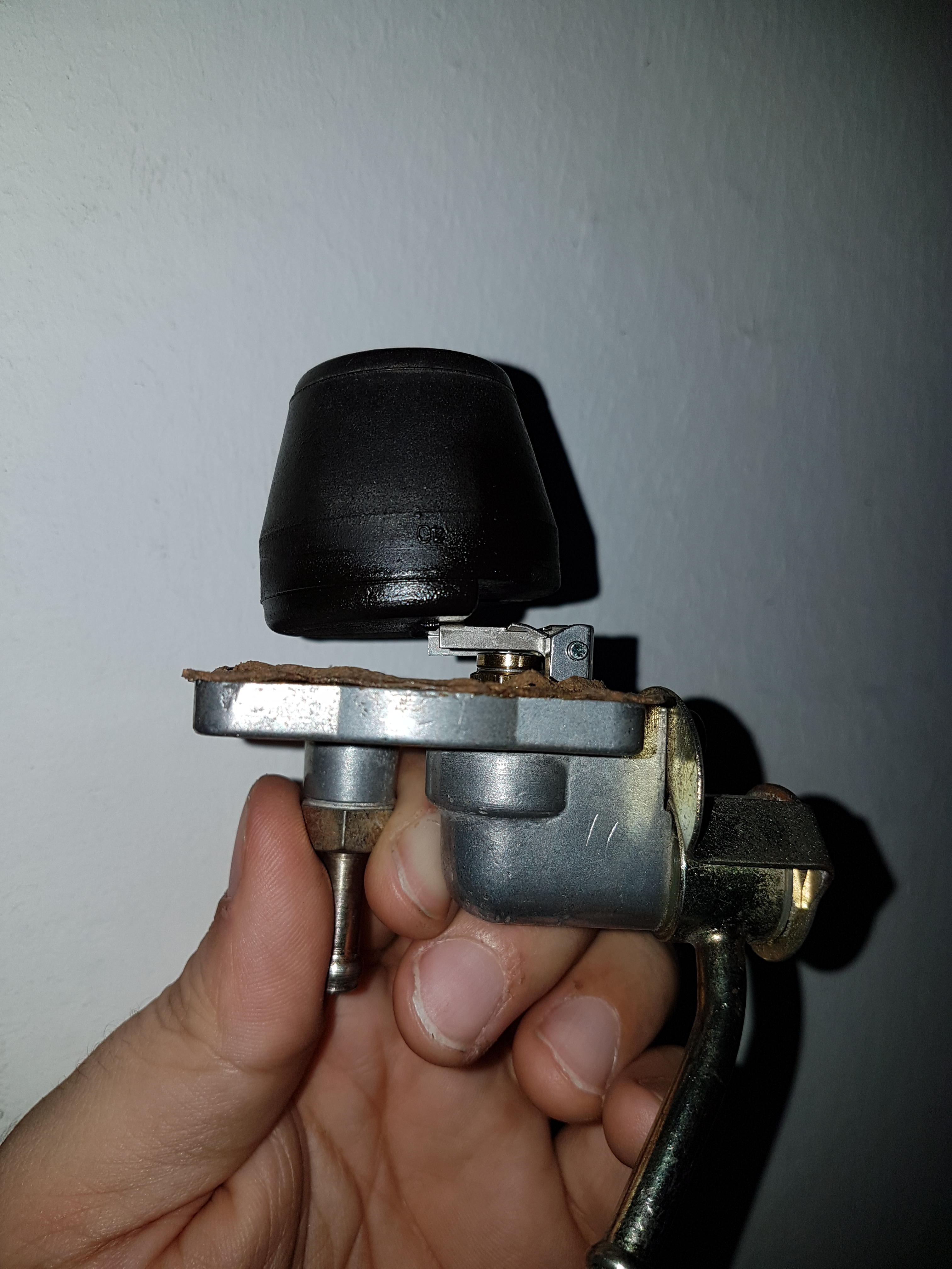

March 20, 20187 yr comment_545099 6 hours ago, Mark Maras said: It would be better to see where the fuel level is before readjusting. Pull the domes and pistons (not the float covers). When you pull the choke on, the nozzles will lower and you'll be able to see the fuel level above the nozzles. Look and see if the rear carb fuel level is close to the front carb level. Just bent the tang a little bit more Link to comment https://www.classiczcars.com/forums/topic/47304-1972-float-adjustment/?&page=31#findComment-545099 Share on other sites More sharing options...

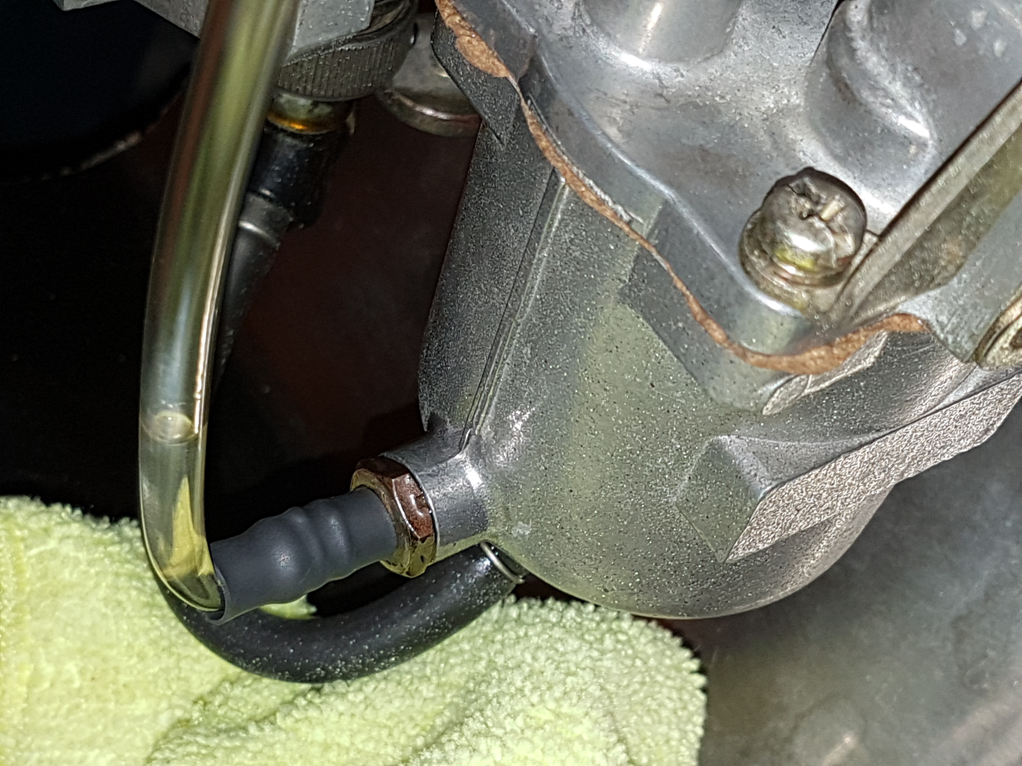

March 20, 20187 yr comment_545115 J, Can you mark a line on the outside of the fuel bowl where the top of the gas reaches? It is hard to tell from the angle of the photos? Link to comment https://www.classiczcars.com/forums/topic/47304-1972-float-adjustment/?&page=31#findComment-545115 Share on other sites More sharing options...
March 20, 20187 yr comment_545126 If i lift the piston up at 2000 rpm should the car stumble and shut down or should it keep running. Im afraid of bending the tang more and the fuel may overflow. Link to comment https://www.classiczcars.com/forums/topic/47304-1972-float-adjustment/?&page=31#findComment-545126 Share on other sites More sharing options...
