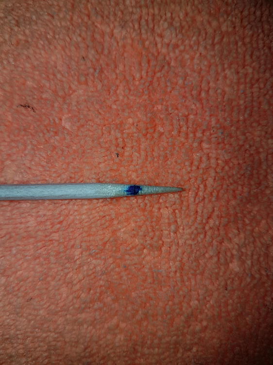

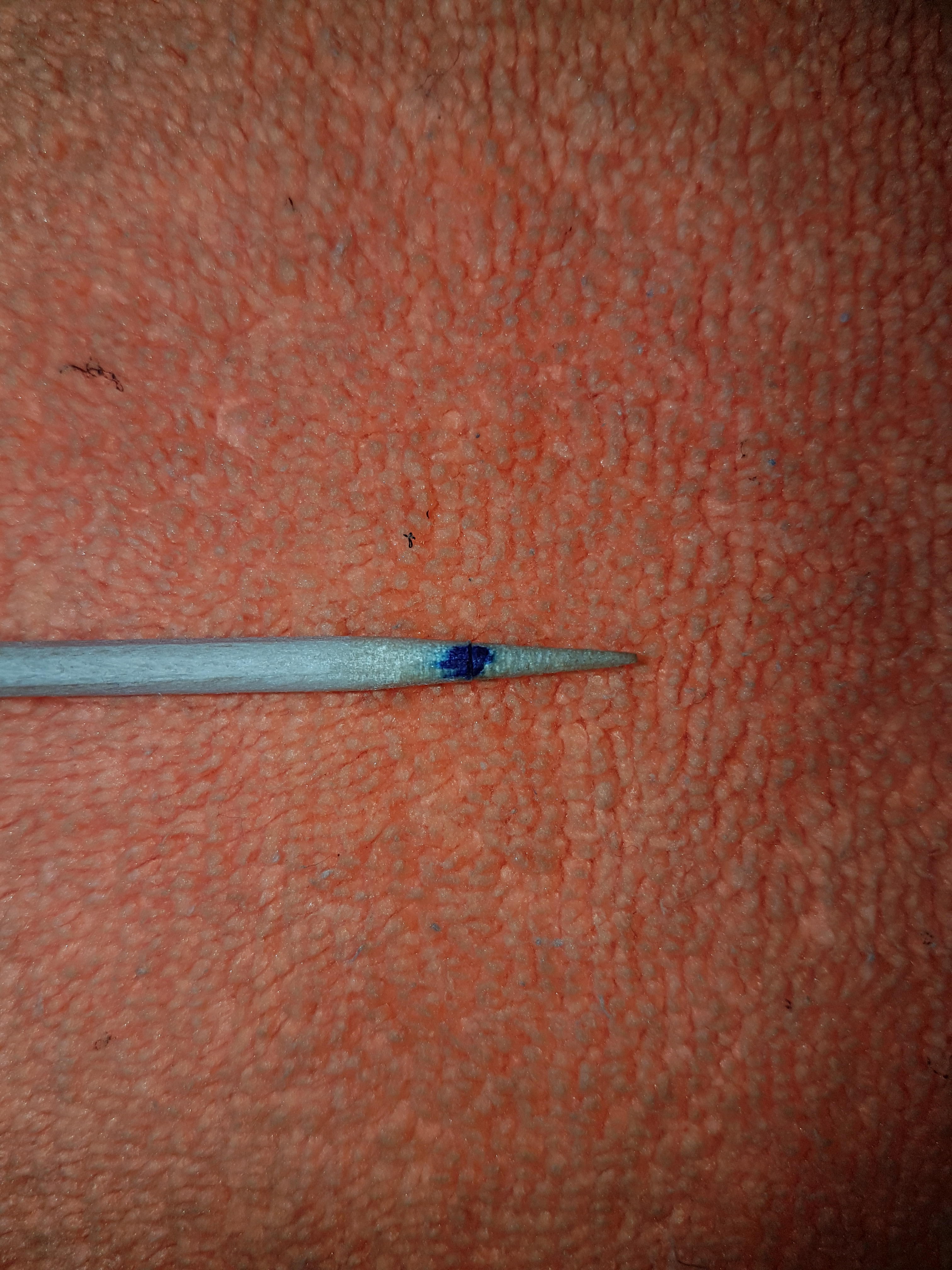

Okay i will replace the airbox filter and fire it up. Choke fully on until it reaches half of the temp gauge.  I thought the aim was to get 1/16th ince which equals to 1.58 mm under the hole of the nozzle.
