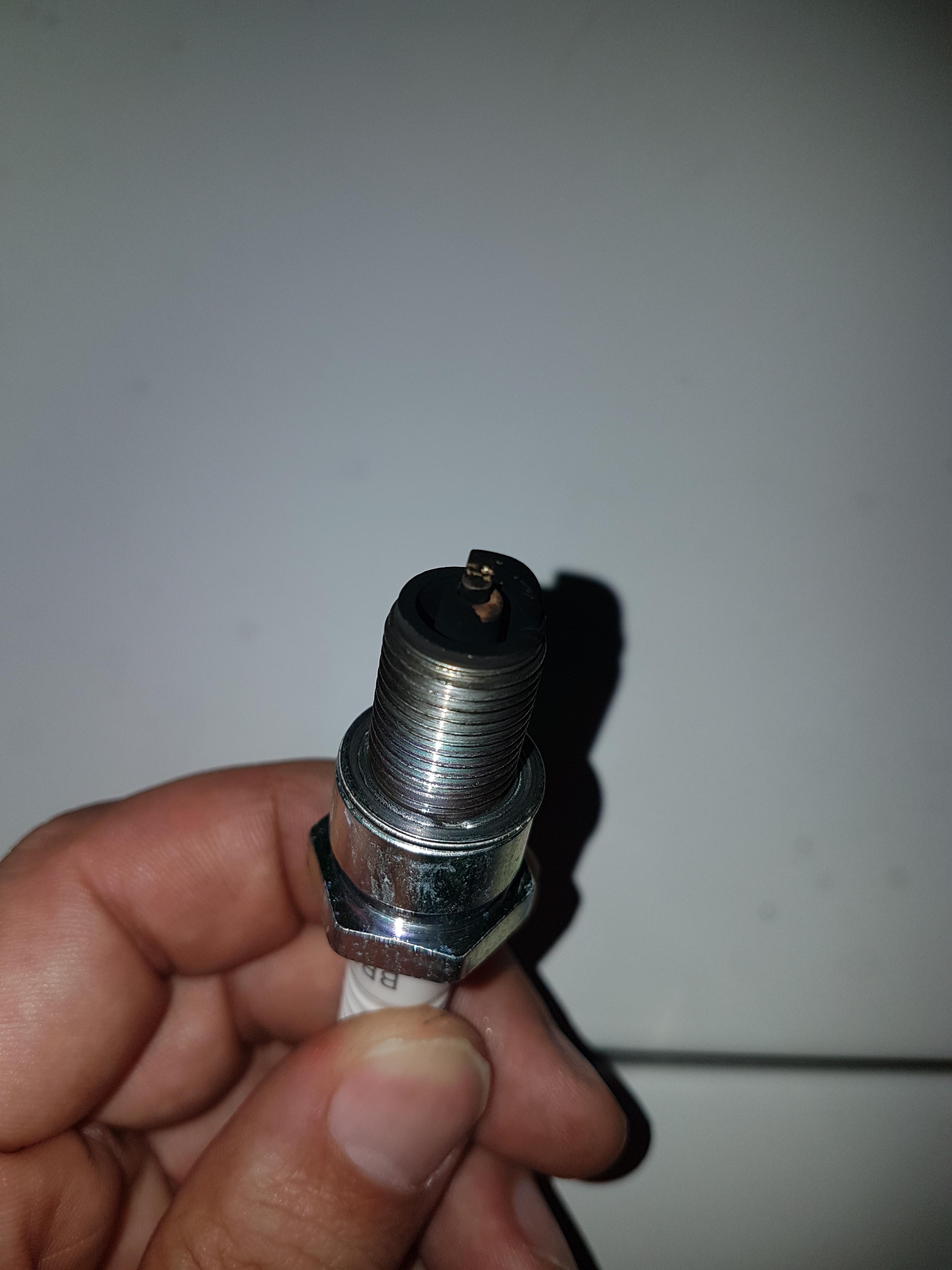

April 11, 20186 yr comment_547097 15 minutes ago, Lumens said: Now I see you are talking about your magnetic pick up gap. I am talking about spark plug gap as recommended by that Company. All plugs came out like this due to driving the car with full choke on to avoid misfire Link to comment https://www.classiczcars.com/forums/topic/47304-1972-float-adjustment/?&page=46#findComment-547097 Share on other sites More sharing options...
April 11, 20186 yr comment_547103  Of course it looks that way. With the choke on the fuel mixture is mega-rich. The reason I want you to put in new plugs and start it with NO CHOKE is I suspect that you're using too much choke and fouling the plugs before you ever get on the road. Yes the engine will lack power while it's warming up. Just baby the throttle and keep it running (with no choke) until it's warmed up, then take it for a drive. Link to comment https://www.classiczcars.com/forums/topic/47304-1972-float-adjustment/?&page=46#findComment-547103 Share on other sites More sharing options...

April 11, 20186 yr comment_547111 This is really weird. I swapped all the 6 spark plugs with a brand new ngk bp6es set and sprayed and cleaned the distributor cap, rotor and inner with deoxit d5. Viola! No more sputtering and coughing during the spin. No more rough accelaration. Just perfect. What could have been the cause??? Link to comment https://www.classiczcars.com/forums/topic/47304-1972-float-adjustment/?&page=46#findComment-547111 Share on other sites More sharing options...
April 11, 20186 yr comment_547112 Too much carbon on your plugs. You fouled them. Link to comment https://www.classiczcars.com/forums/topic/47304-1972-float-adjustment/?&page=46#findComment-547112 Share on other sites More sharing options...
April 11, 20186 yr comment_547115 1 hour ago, 240260280 said: Too much carbon on your plugs. You fouled them. Fouling the plugs damages them? No way to save them by brushing them with a brass brush? Link to comment https://www.classiczcars.com/forums/topic/47304-1972-float-adjustment/?&page=46#findComment-547115 Share on other sites More sharing options...
