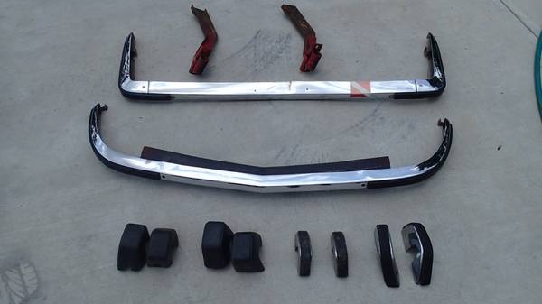

Earlier bumpers and brackets are lighter and tuck the bumper close to the body-as originally designed. There are mounting holes for both types of bumper brackets on the '73s. My avatar car is a '73 with earlier bumpers.
Here's a pic of the 73 bumpers and the heavy hangers (in red) below. Want to save weight up front? These are about 30 lbs or more.
The 72 has a much lighter front bracket and the tighter fitting bumper.
Thanks for the tip! I'll be sure to look into this modification. After stripping down the '73 front bumper (removing trims and such) will they bolt up directly to the earlier brackets without modification?
[ATTACH=CONFIG]65962[/ATTACH]
Cool, thanks for the picture. Sounds like a great idea to shed weight and get a cleaner look to boot. After stripping all this down, are the '73 chrome bumpers themselves identical to the earlier bumpers or are they a different design and require modification to use with the earlier type brackets?
