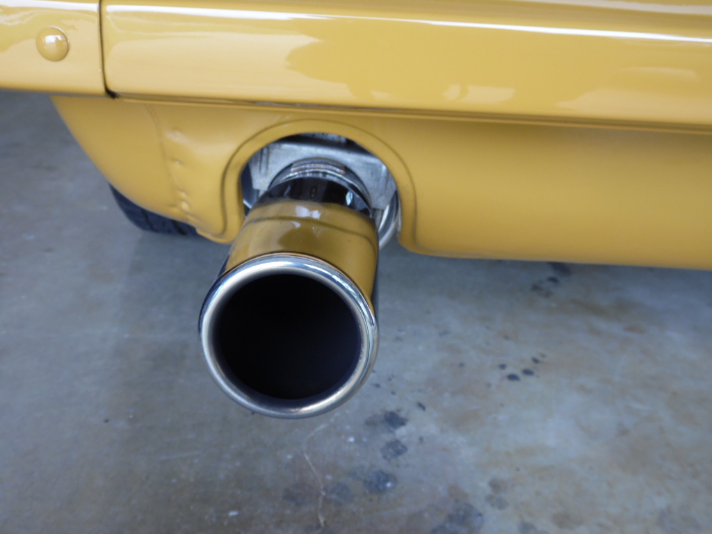

I checked the Dynomax website and the 17733 model is reversible with regard to inlet and outlet. Most of their mufflers are reversible with the exception of those with one inlet and two outlets. So the issue is fit and heat only at this point. Here is a picture of the install with a center inlet and offset outlet. I like the fit, but not the heat.
Some options:
1. Reverse the muffler and see how it looks and if it reduces the heat. This will only require a new rear hanger since it had to trim the one provided in the kit.
2. Have a muffler shop bend the pipe before the muffler to drop it an inch or so. This would still look fine and may reduce the heat.
3. Shop for a new muffler.
4. Install heat shielding on the car or strap it directly to muffler (Thermo-Tec heat shield).
Thanks for listening!
I've got the same system and install method, haven't noticed any heat problems (maybe I'm not looking hard enough ;) ). It looks like you have all of it pulled up pretty tight against the body, thus your clearance comment. Work with the hangers to drop the muffler a bit - this will give better clearance around the valance and possibly improve air circulation.
And... yes it is a noisy muffler. Many have added a 2" glass-pak upstream.
post-25140-14150826628964_thumb.jpgJust to follow up, I took the car to a muffler shop and they adjusted the exhaust hangers to lower the system a bit. They did not get it quite right though because the exhaust tip was lower, but was not centered where it should be. The next day I loosened the hangers and the clamp on the inlet to the muffler so I could rotate it a little. Since it has the inlet a the center and the offset at the outlet, a little rotation centered the outlet on the opening in the sheet metal. Now all is well, except maybe too loud. I still think it is too hot back there, but I need to take some additional readings.
