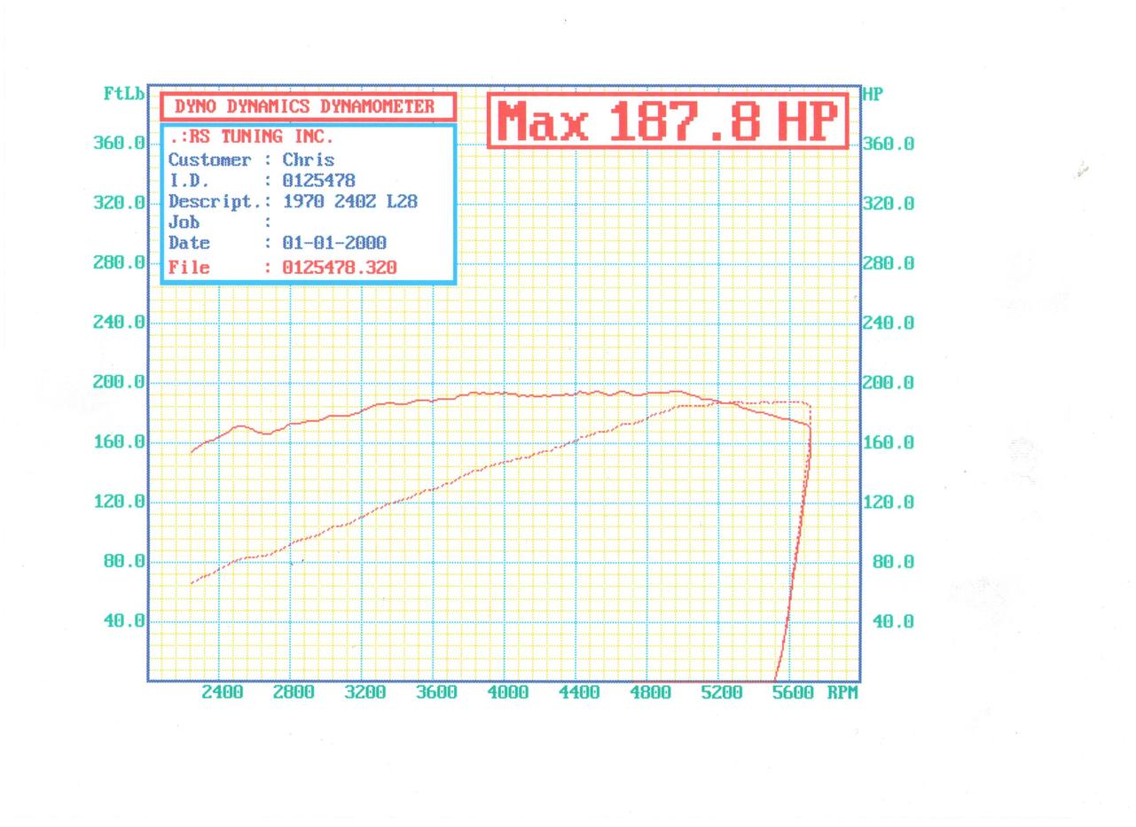

A moderately built L28 with well tuned ZTherapy SU's,
Had this done last week on a Dyno Dynamics machine, torque appears to be 190-192 ftlbs
I'm pretty happy with those numbers, but now I have installed a set of SK/OER triples and once I have those tweaked to best performance I'm heading back to the same dyno to answer for myself which carbs are better for me. I don't want to reignite that debate again but I thought some might be interested in the results so I'l post them as soon as I get them.
I am really loving the triples, great sound and the car feels stronger but I could just be fooling myself.
Chris

please elaborate on the engine. We have so few dyno numbers posted here, it would be great for reference. Please be specific as to all aspects,-- timing, cam , head, exhaust, etc...
Looks like good numbers. Did you not want to take it past 6000rpm?
I'll be next soon with my double-triple numbers.
F54 block, N42 head, port and polish, port matched,
Crane mild cam grind on a Nissan blank cam,
Flat top pistons, not sure which ones,
Cylinder bored 0.020" over, 10:1 compression,
10 lb aluminum flywheel
Steve, didn't want to go over 6000 rpm cause there was some ping happening which has disappeared with the triples.

I forgot to mention that I'm not using a header, I took a stock cast iron exhaust manifold and hogged it out to match the larger exhaust ports and smoothed the interior a bit, I would love to polish the interior of the manifold just not sure how I would do that.
Those are better than reasonable numbers- those are excellent numbers. I have read too many threads where folks have gone the stroker route and didn't do this good. Looking like 200+ HP at the rear wheels with triples is very possible . That is an accomplishment to be proud of- congrats.
Where were you at with the timing and what ignition ?
