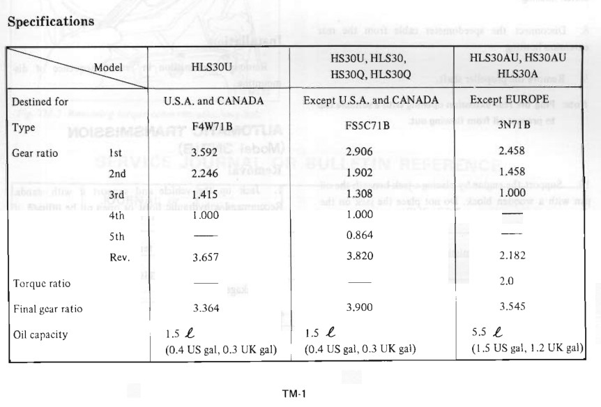

September 19, 201311 yr comment_432032 Should be the 71B, not C, according to the attached from the FSM. European, correct? Factory stock 240Z? Is it working now? If so, there should be no major problems. You're changing the clutch, nt the transmission. Just make sure to measure before installing. Where people go wrong is when they change the relationship of the throwout collar ears to the slave cylinder position, accidentally, by trying to match a combination of aftermarket parts to the year of their car. Measure before installing. The various web pages, like the one I linked above, are just starting points to help find the right parts, to get started on a swap. Edited September 19, 201311 yr by Zed Head Link to comment https://www.classiczcars.com/forums/topic/47427-what-brand-of-clutch-should-i-buy-for-240z/?&page=2#findComment-432032 Share on other sites More sharing options...
September 19, 201311 yr Author comment_432041 I'm probably over-thinking the situation and worrying about a problem that probably won't exist. I'll stack all the old parts on a piece of glass and stack the new ones next to it and compare measurements before installing. Link to comment https://www.classiczcars.com/forums/topic/47427-what-brand-of-clutch-should-i-buy-for-240z/?&page=2#findComment-432041 Share on other sites More sharing options...
