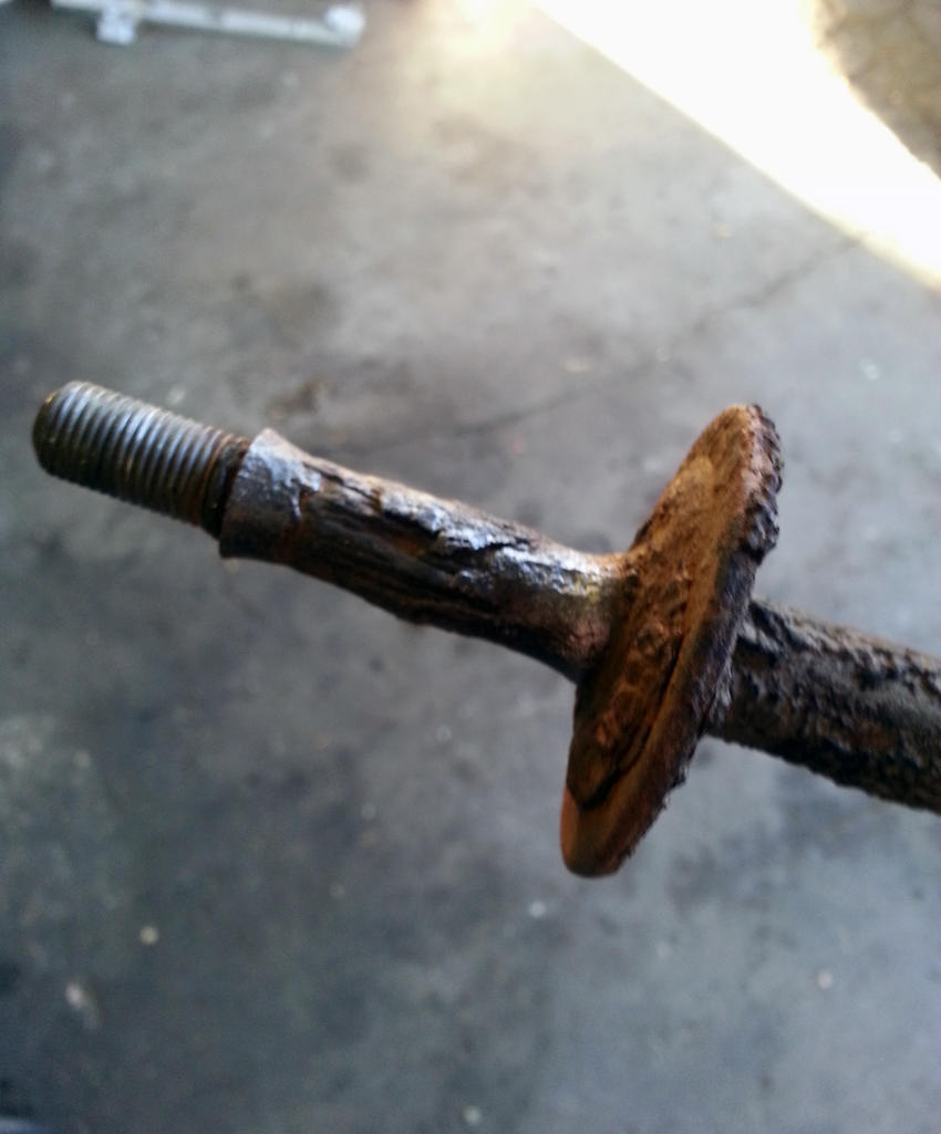

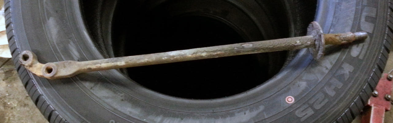

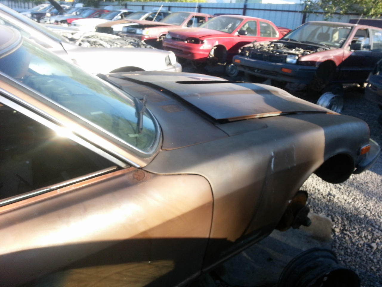

September 24, 201311 yr Author comment_432274 Forgive my crude diagram, but am I understanding this correctly? The 260 tension rod seems to have a retainer flange as part of the bar itself, or at least its corroded into one piece. But, the busing goes against it, into the cup on the chassis, and the other side gets a bushing, washer and then retaining and lock nut? Also, spied a pretty clean 280 at the Pick-n-pull. Probably there to pull apart the same 260 I was. Here's the donor. Yeesh. Here's what I managed to pull off. Don't have the nut, and the bushings were in even worse shape. But $10 was a fair price to pay. I don't think this ones gonna last. Guess I may need to start looking for a more permanent solution. It should do for now, though. I guess I have every bushing except the one I need.. Link to comment https://www.classiczcars.com/forums/topic/47472-uhm-i-think-thats-supposed-to-be-attached/?&page=2#findComment-432274 Share on other sites More sharing options...
September 24, 201311 yr comment_432280 That one looks pretty bad. I would do my best to find another. You would think they were common because people change them for performance rods.Goodluck searching.Chas Link to comment https://www.classiczcars.com/forums/topic/47472-uhm-i-think-thats-supposed-to-be-attached/?&page=2#findComment-432280 Share on other sites More sharing options...
September 24, 201311 yr comment_432287 Everything should come off the rod. In this pic, there are still a few old bits rusted into place on the donor rod. That large washer has to come off, but it's being held into place by a rusted into place sleeve tube. There is also a smaller washer behind the large one that you can't see in the pic. [ATTACH=CONFIG]66118[/ATTACH] Here's a pic of a bushing kit. Two small washers, two big washers, two bushings, a sleeve, and a nut: In application, from front to rear of the car, it goes: Small washer Large washer Bushing (with sleeve in center) Frame of car Bushing (with sleeve in center) Large washer Small washer Nut Here's a pic showing the install order. This is what it looks like with urethane in front and rubber in the back. Note that the concave portion of the large washers should be away from the bushings. Also note that the direction of the black rubber bushing is wrong. The thicker portion of the rubber bushing should be towards the large washers, not towards the frame. I originally installed them incorrectly and later took them back off to switch the rear bushings around. Link to comment https://www.classiczcars.com/forums/topic/47472-uhm-i-think-thats-supposed-to-be-attached/?&page=2#findComment-432287 Share on other sites More sharing options...
September 24, 201311 yr comment_432298 As noted, there's parts still on that rod. Get the big washer and the sleeve removed and you'll have a better idea of condition. The weak point is at the base of the shoulder of the transition from the smaller diameter threaded portion to the main rod. If that part is not cracked and about to break, or totally chewed up from rust, it might be fine. Polish it up and see how it looks then. Link to comment https://www.classiczcars.com/forums/topic/47472-uhm-i-think-thats-supposed-to-be-attached/?&page=2#findComment-432298 Share on other sites More sharing options...
September 24, 201311 yr Author comment_432346 That one looks pretty bad. I would do my best to find another. You would think they were common because people change them for performance rods.Goodluck searching.ChasYeah, I'll be looking for a better candidate. But this one will do in the meantime. It was the only junkyard Z. My friend apparently only had rear suspension parts, unfortunately. I know of one other parts 280z owned by a local Japanese Car restoration company. They seemed willing to let the part go, but were closing up shop and I didn't have time to come see it. My next chance will be tomorrow - so I'll try them again, and see which is better. If so, I'll swap my pick and pull part for a valve cover to polish up. HahaEverything should come off the rod. In this pic, there are still a few old bits rusted into place on the donor rod. That large washer has to come off, but it's being held into place by a rusted into place sleeve tube. There is also a smaller washer behind the large one that you can't see in the pic.Okay. Thats exactly what I needed. Thanks for the help everyone. Link to comment https://www.classiczcars.com/forums/topic/47472-uhm-i-think-thats-supposed-to-be-attached/?&page=2#findComment-432346 Share on other sites More sharing options...

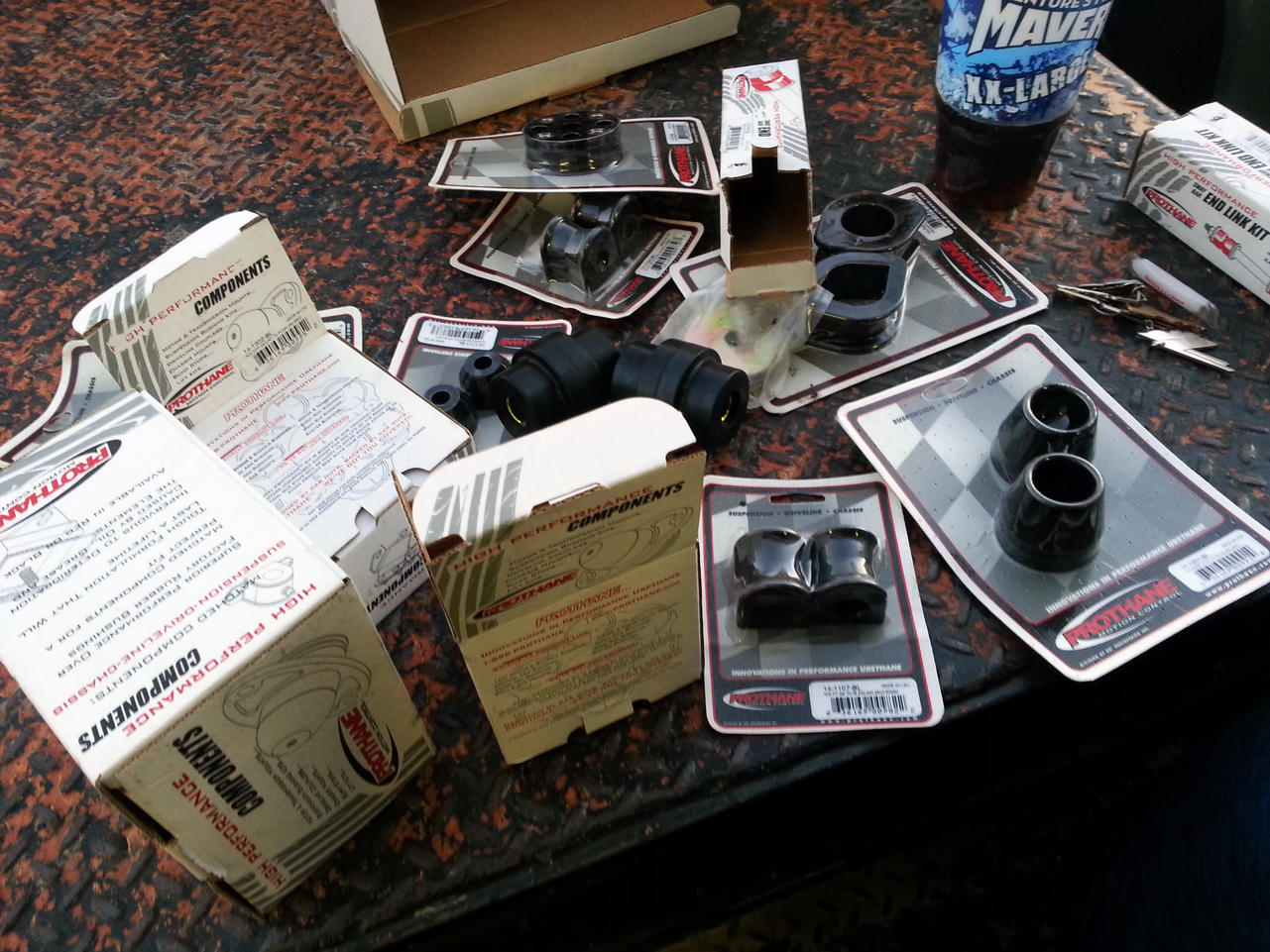

September 25, 201311 yr comment_432370 Here's a pic showing the install order. This is what it looks like with urethane in front and rubber in the back. Note that the concave portion of the large washers should be away from the bushings. Also note that the direction of the black rubber bushing is wrong. The thicker portion of the rubber bushing should be towards the large washers, not towards the frame. I originally installed them incorrectly and later took them back off to switch the rear bushings around. Captain. Did you buy this setup as is or is it made up from two sets? I have not seem them like this before, but I have seen them with two of the black ones. Your set up looks like it solves the stiffness problem. The black rubber with the deep grooves will allow it to flex when needed and its on the back so it wont alter the alignment geomentry. Chas Edited September 25, 201311 yr by EuroDat Link to comment https://www.classiczcars.com/forums/topic/47472-uhm-i-think-thats-supposed-to-be-attached/?&page=2#findComment-432370 Share on other sites More sharing options...
September 26, 201311 yr comment_432428 Chas, That setup was put together from two kits and I did it that way based on info gleaned from other's previous experience about breaking T/C rods.My PO had put poly at all four bushing locations (so I already had the poly). I replaced the rear poly bushings with rubber ones from that AC Delco kit in the pic. I bought two of those kits because I needed washers and sleeves for both sides, but only used half the bushings. I highly recommend that AC Delco kit by the way. Quality was excellent.I just wish I had taken a new pic after I spun those rubber bushings around. I hate posting that old pic knowing that it risks others making that same mistake simply out of example. It's on the car now and I didn't take a pic after I fixed them... Edited September 26, 201311 yr by Captain Obvious Link to comment https://www.classiczcars.com/forums/topic/47472-uhm-i-think-thats-supposed-to-be-attached/?&page=2#findComment-432428 Share on other sites More sharing options...
