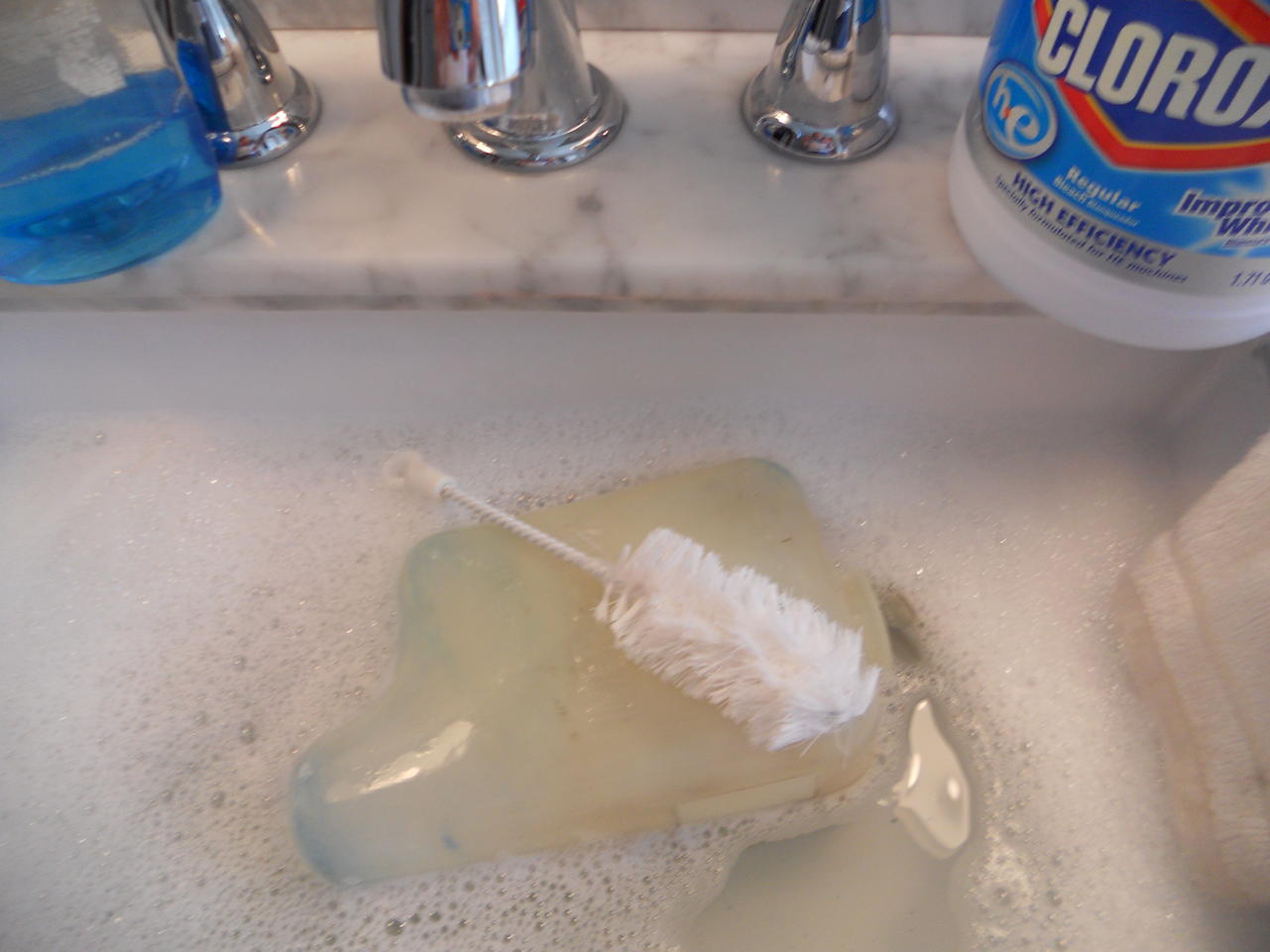

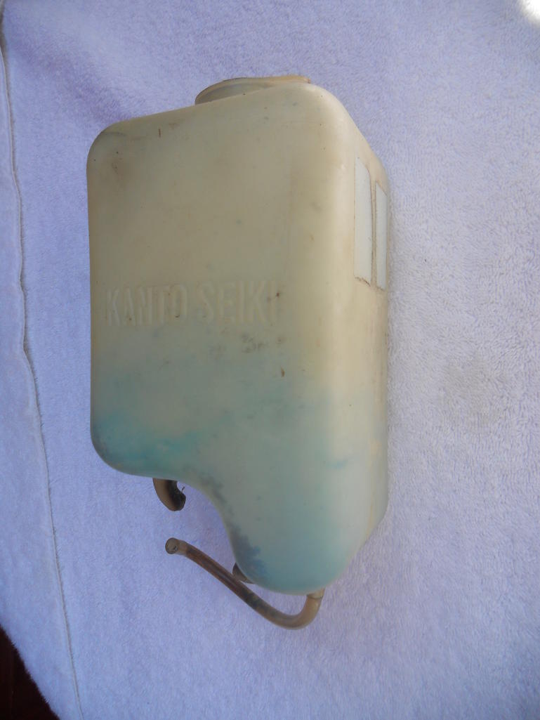

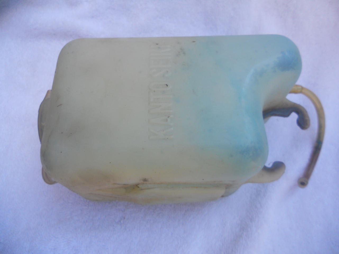

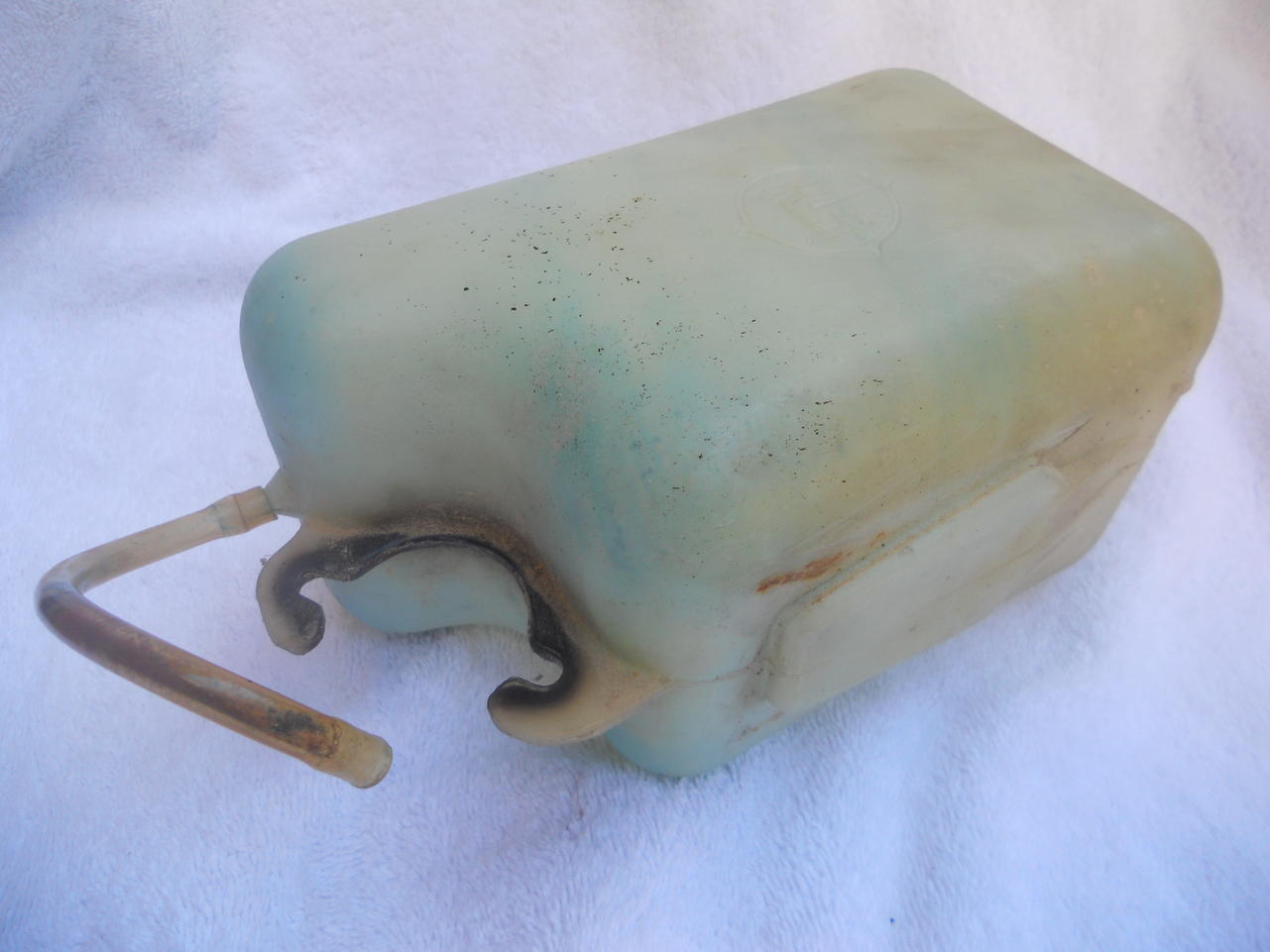

Can't justify $500.00 for a NOS washer bottle? I was reading post on the site on refreshing a washer bottle and decided to give it a try. First you have to start with a viable washer bottle.
I first cleaned the bottle using a strong soap and bleach solution. My wife loves these projects in our bathroom sink!
After a good cleaning I let it soak in the soap and bleach for a couple of hours.

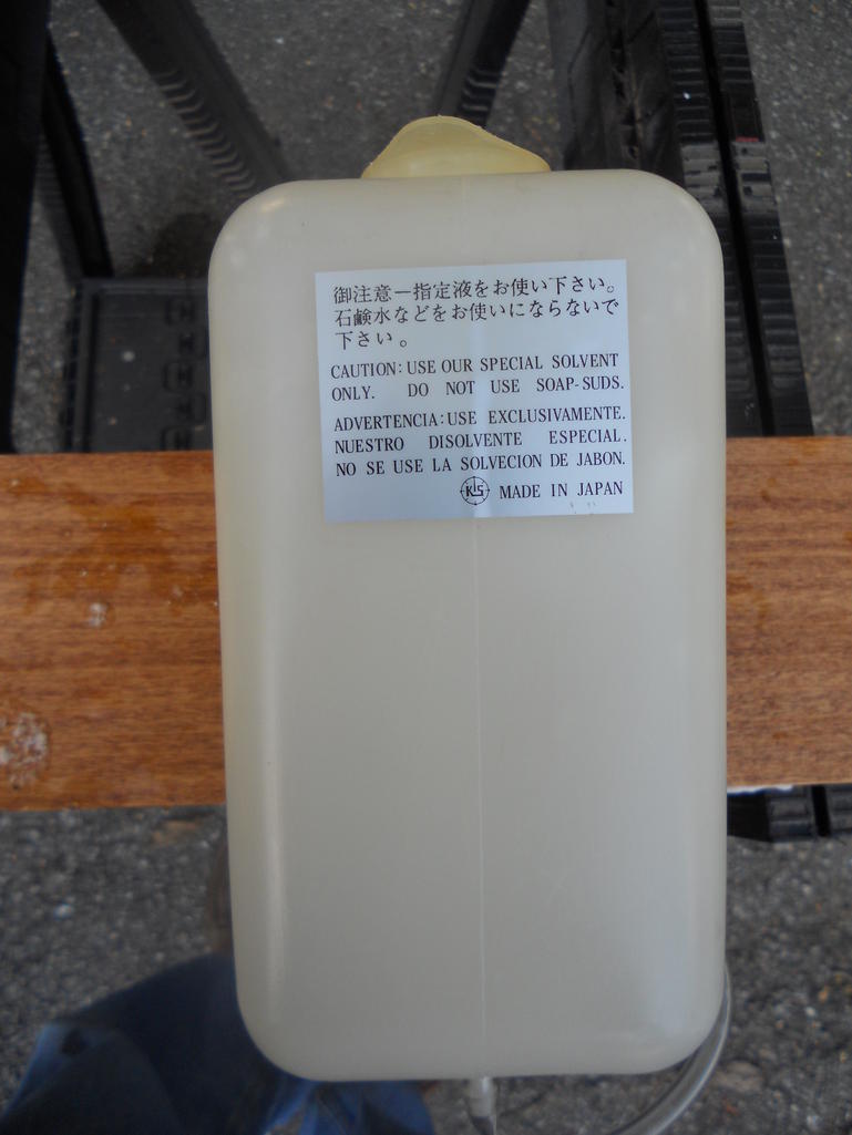

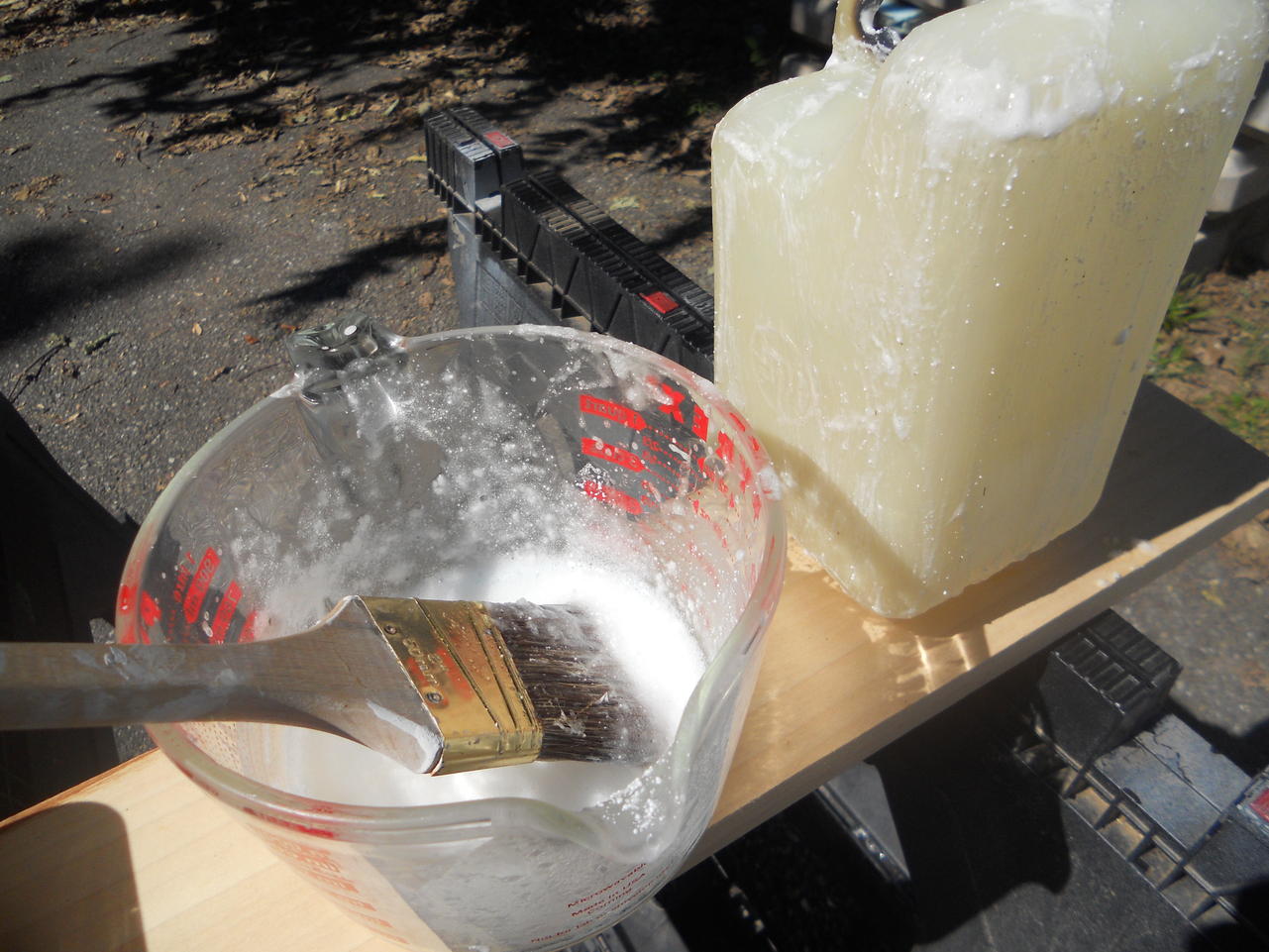

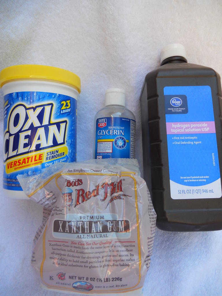

I made a solution, as mentioned in a thread on this site. The solution is made up of hydrogen Peroxide, Oxi-clean, Glycerin and a little Xanthan Gum to make the solution sticky.

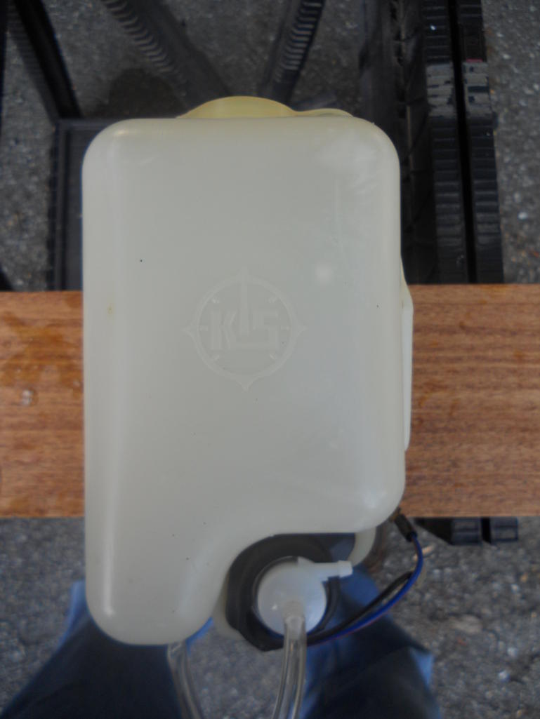

After mixing the solution I put a cap on the bottom water outlet, and poured it into the bottle. I shook it around and poured it back out. I them brushed the solution onto the exterior of the bottle. The process is reportedly activated by UV light so I put the bottle in the sun. I reapplied the mixture to the exterior from time to time and left it in the sun all day. After cleaning the bottle I made a mixture of the same products with the exception of the xanthan gum and poured it into the bottle about an inch deep when laying on it's side. I put the bottle on it's side in the sun and rotated it every half hour for about 4 hours. Then Cleaned the bottle with soap and water.

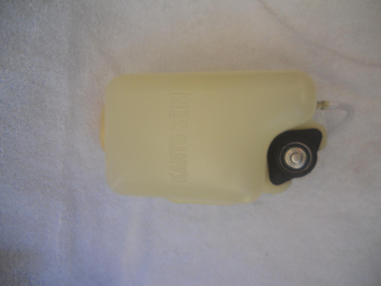

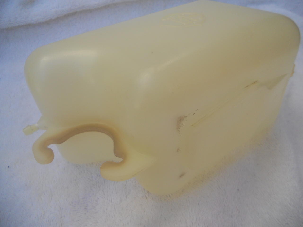

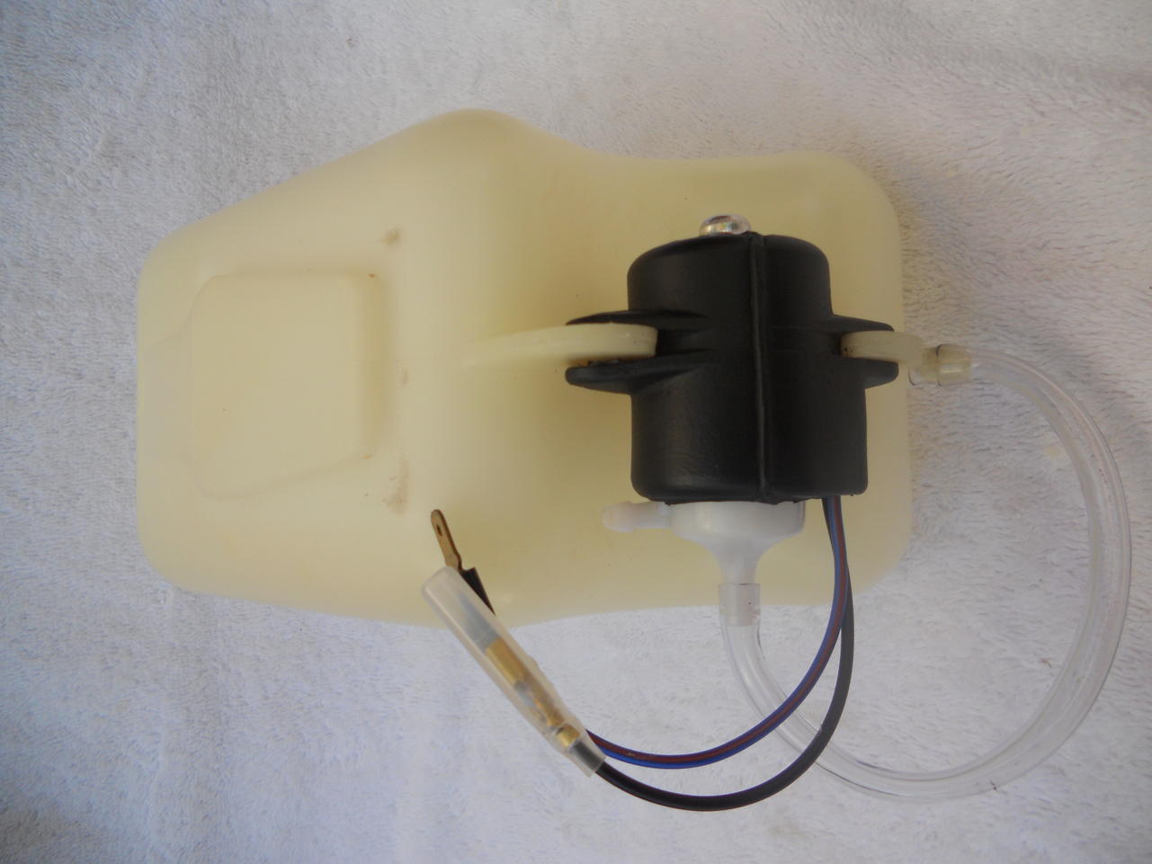

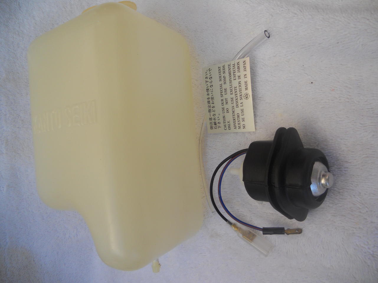

I gathered my parts for assembly. I had already removed the old washer motor from the rubber housing and cleaned and dressed the black rubber housing. I then installed the new washer motor into the old rubber housing. The other parts were a new piece of clear 1/4" washer hose and a reproduction sticker.

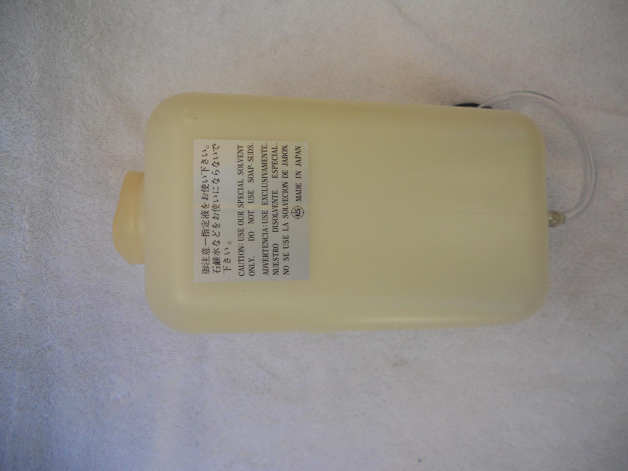

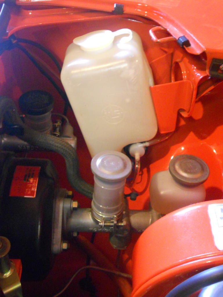

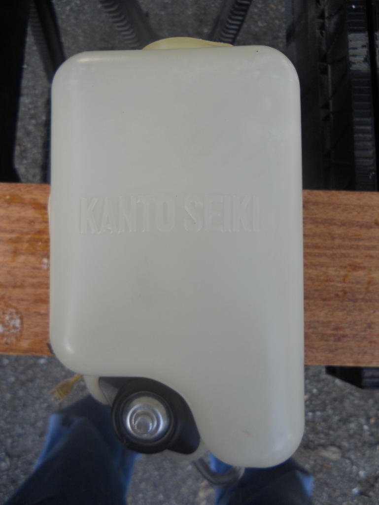

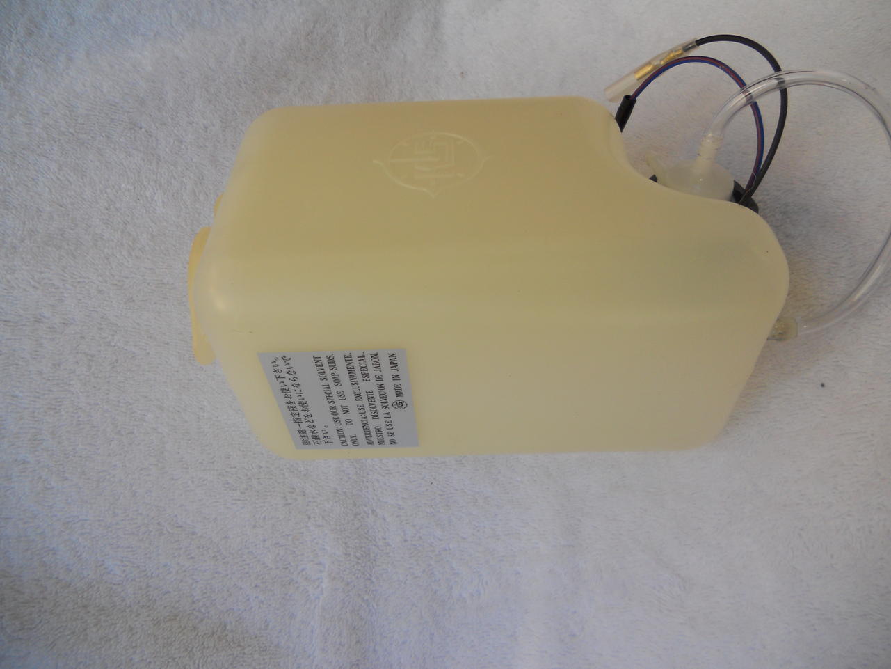

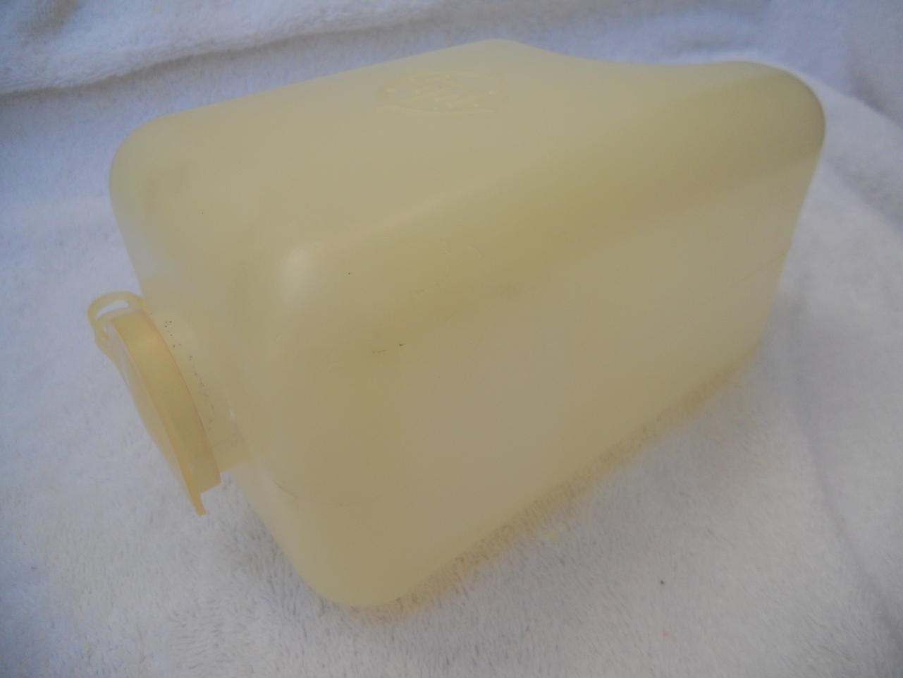

I assembled the bottle and although not NOS it did turn out very presentable and is a vast improvement on the 40 year old washer bottle.;)
The finished bottle is not as yellow as it looks in the photos. I will try and get some better photos tomorrow in better light.:ermm:

Dan, you are correct Banzai Motorworks is selling reproductions for $195.00. That is where the reproduction label and new washer motor came from for my refresh project. I have one of his reproduction washer bottles as well. I have to say that it is nice to have the reproduction available, and I was one of the first to buy one, but I prefer the refreshed bottle. The reason being that with all the effort of an accurate reproduction the plastic in the reproduction is of a different appearance. It is less translucent and has a rough texture. In the spirit of full disclosure, I refreshed a bottle, I purchased a reproduction, and being on the quest for the best my car can be I have just purchased a NOS bottle and forked out the big bucks in the end. But the refresh or the reproduction are viable options. JLP
I am disappointed with the evening photos of the completed bottle. It looks much cleaner and better than the photos reflect.:ermm:I will take some photos tomorrow in better light and although not NOS you will be impressed with the results.:cool:
