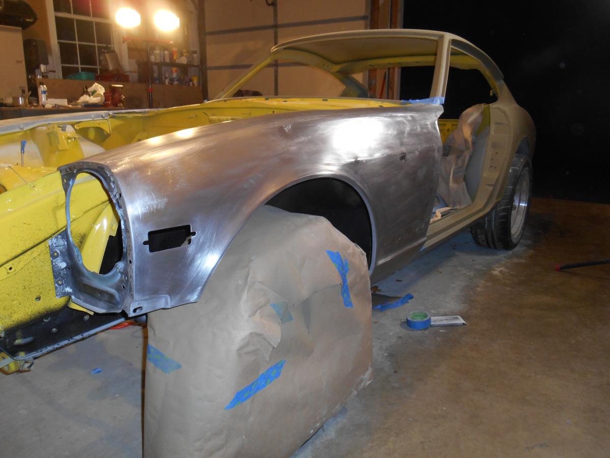

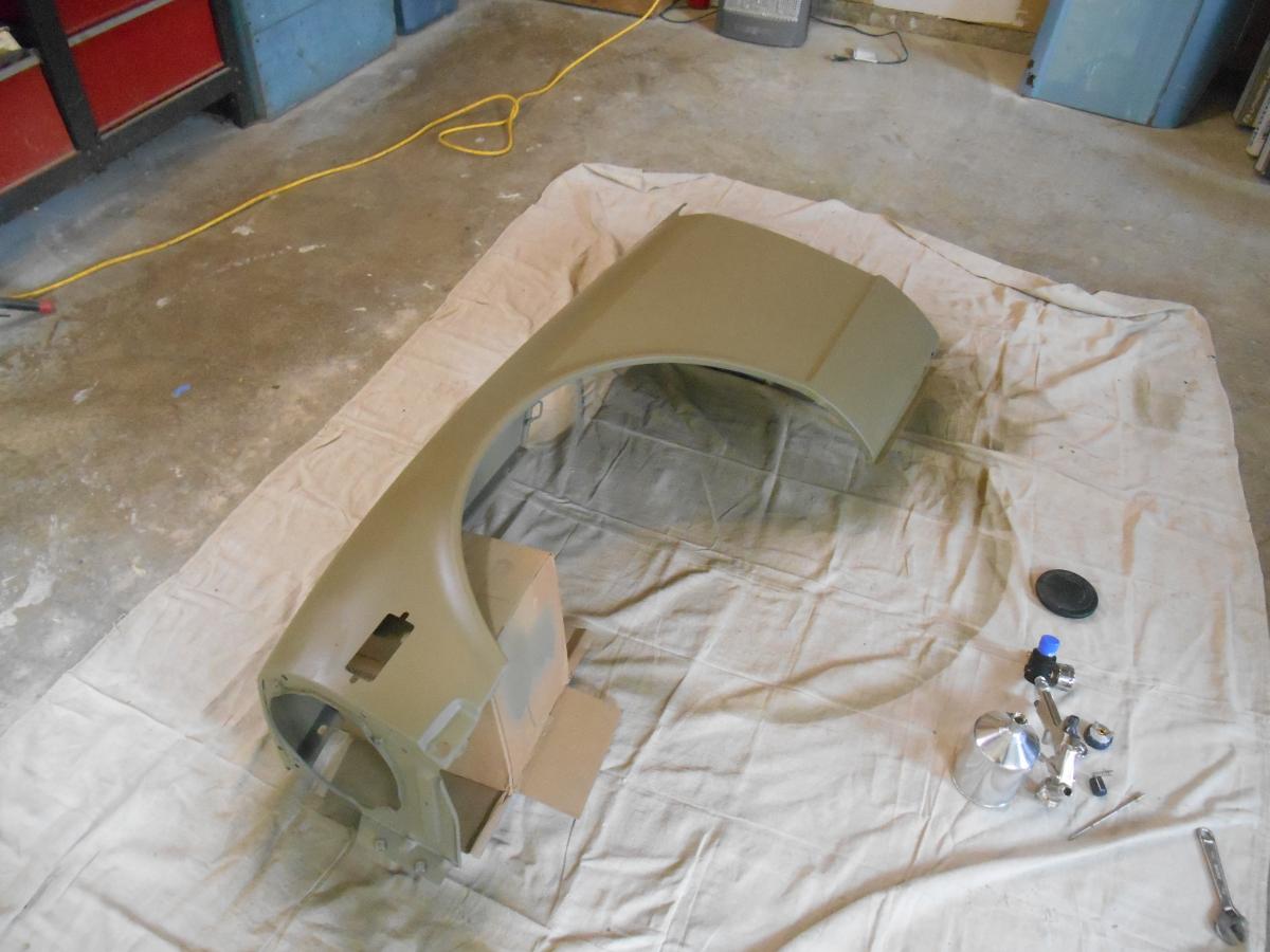

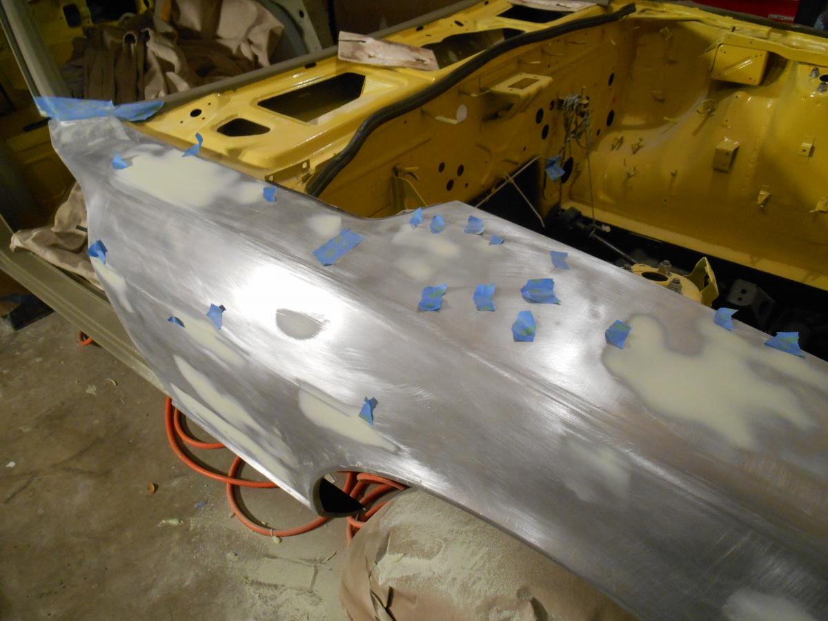

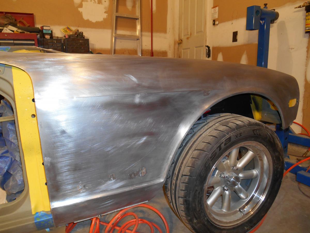

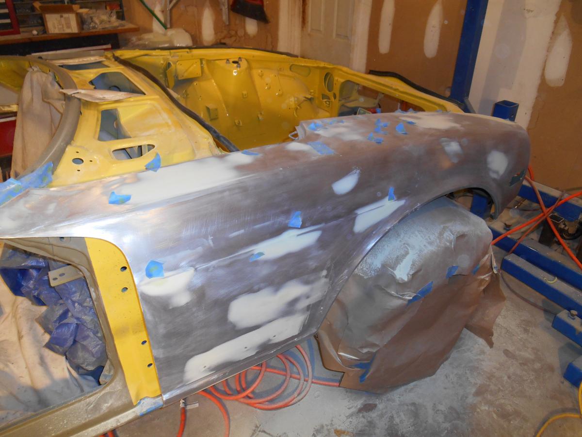

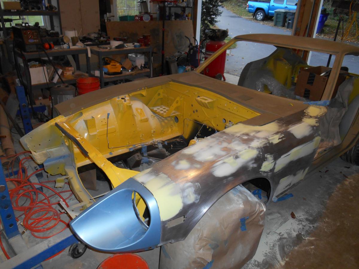

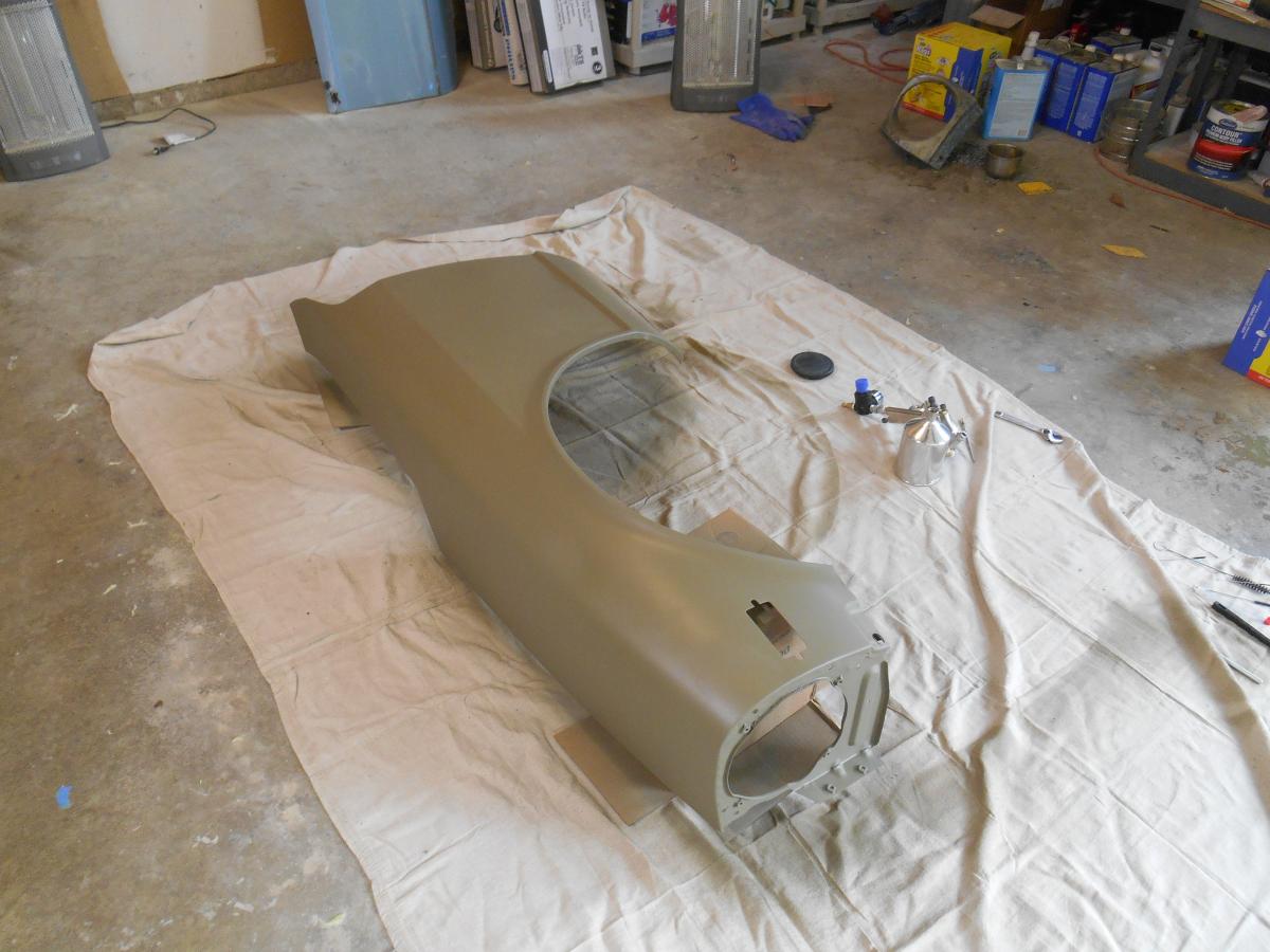

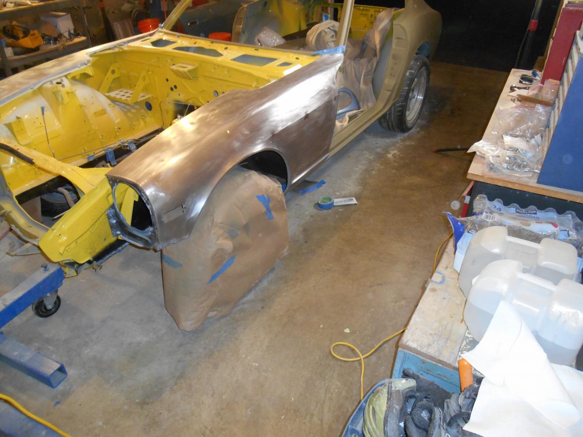

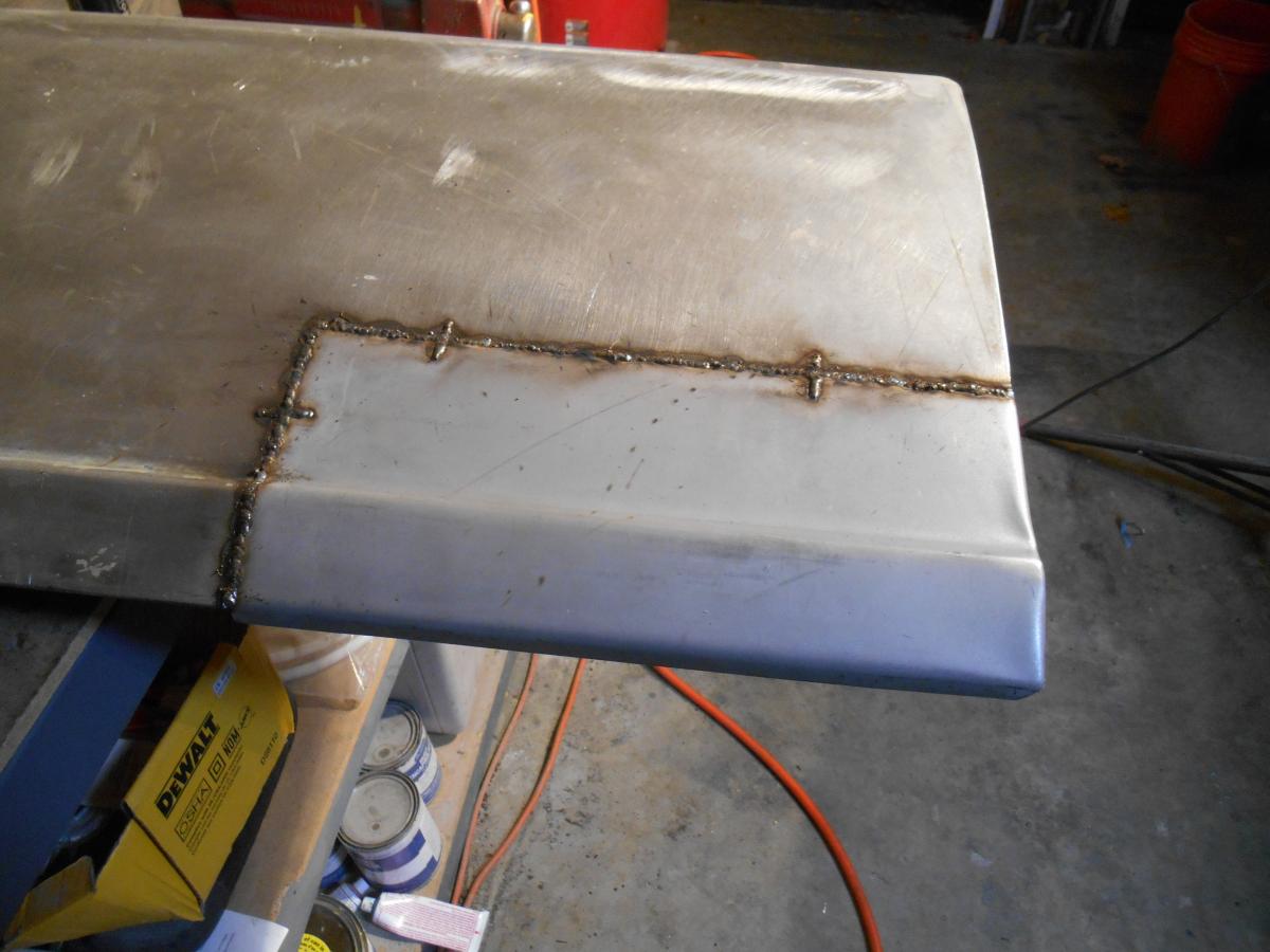

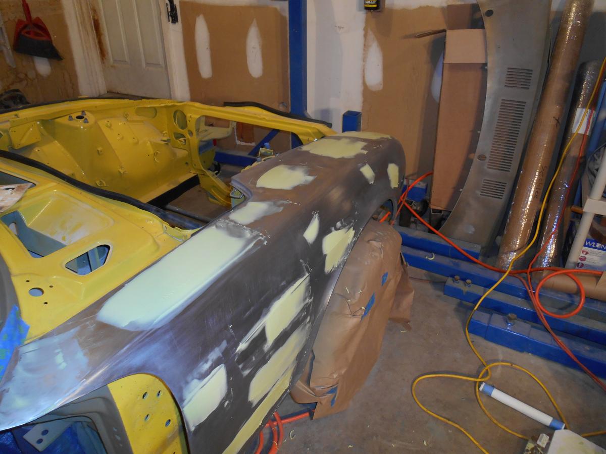

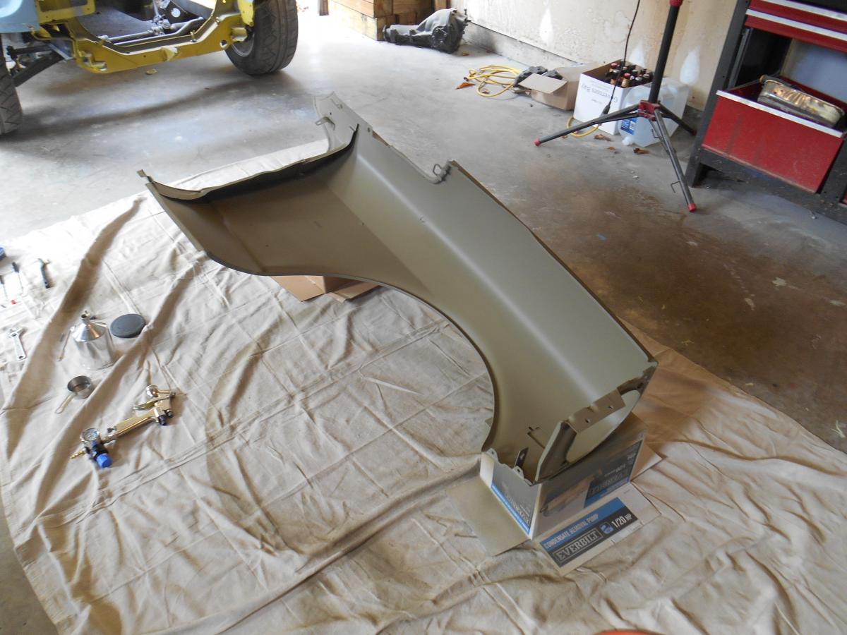

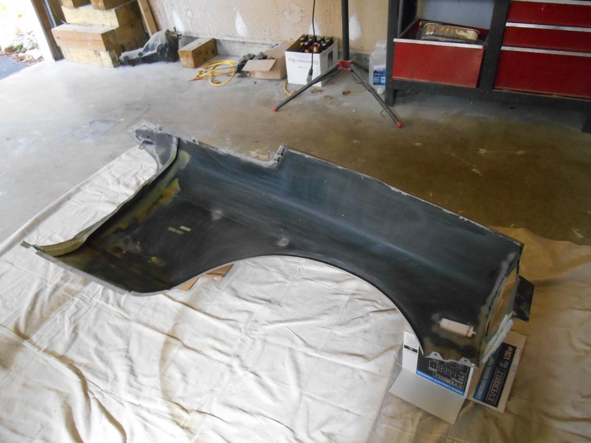

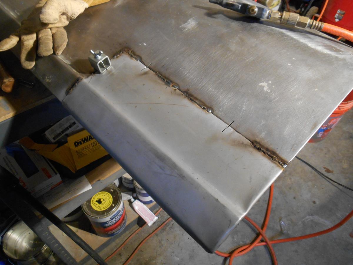

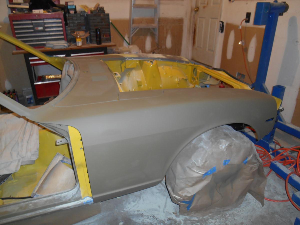

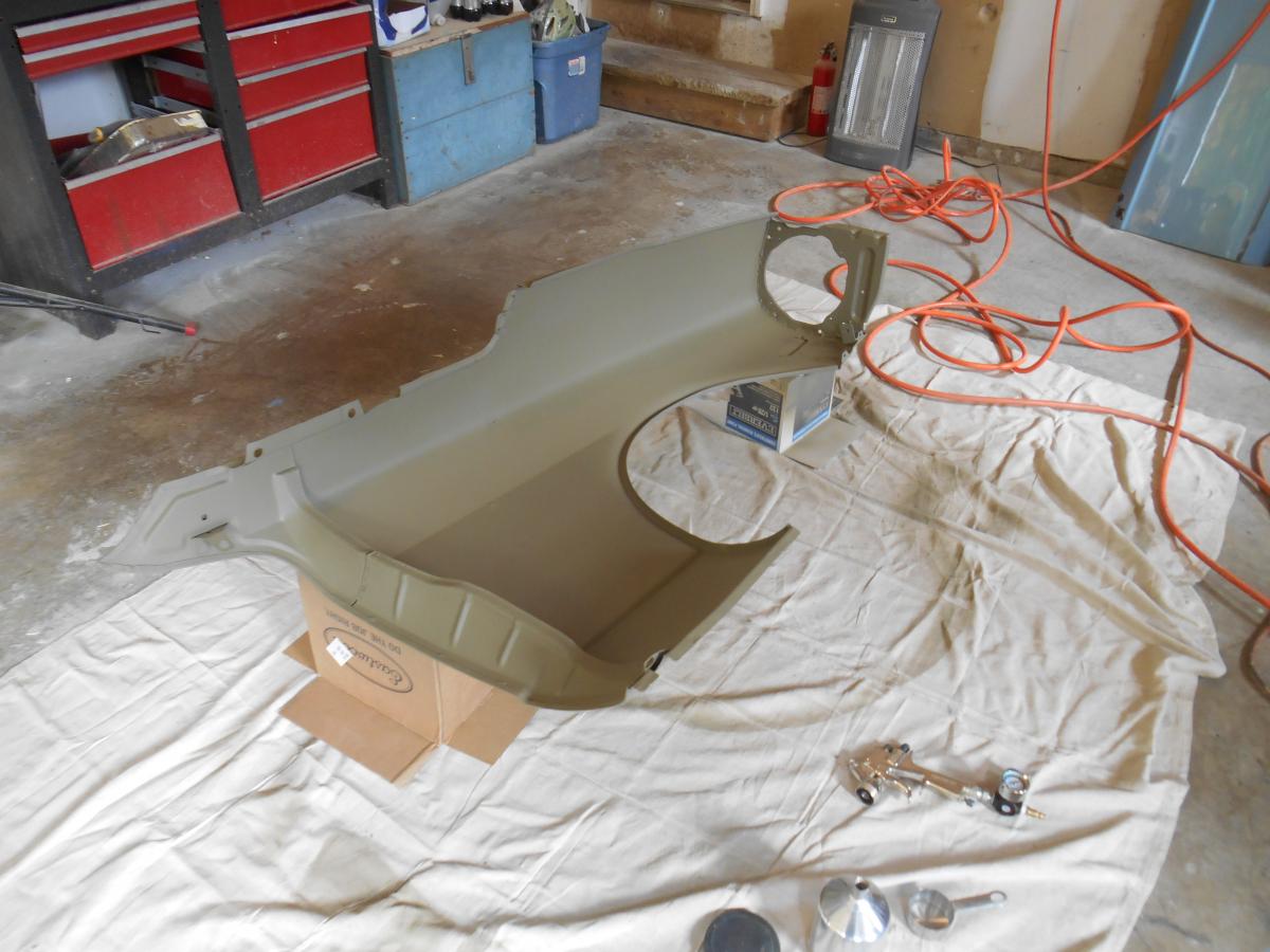

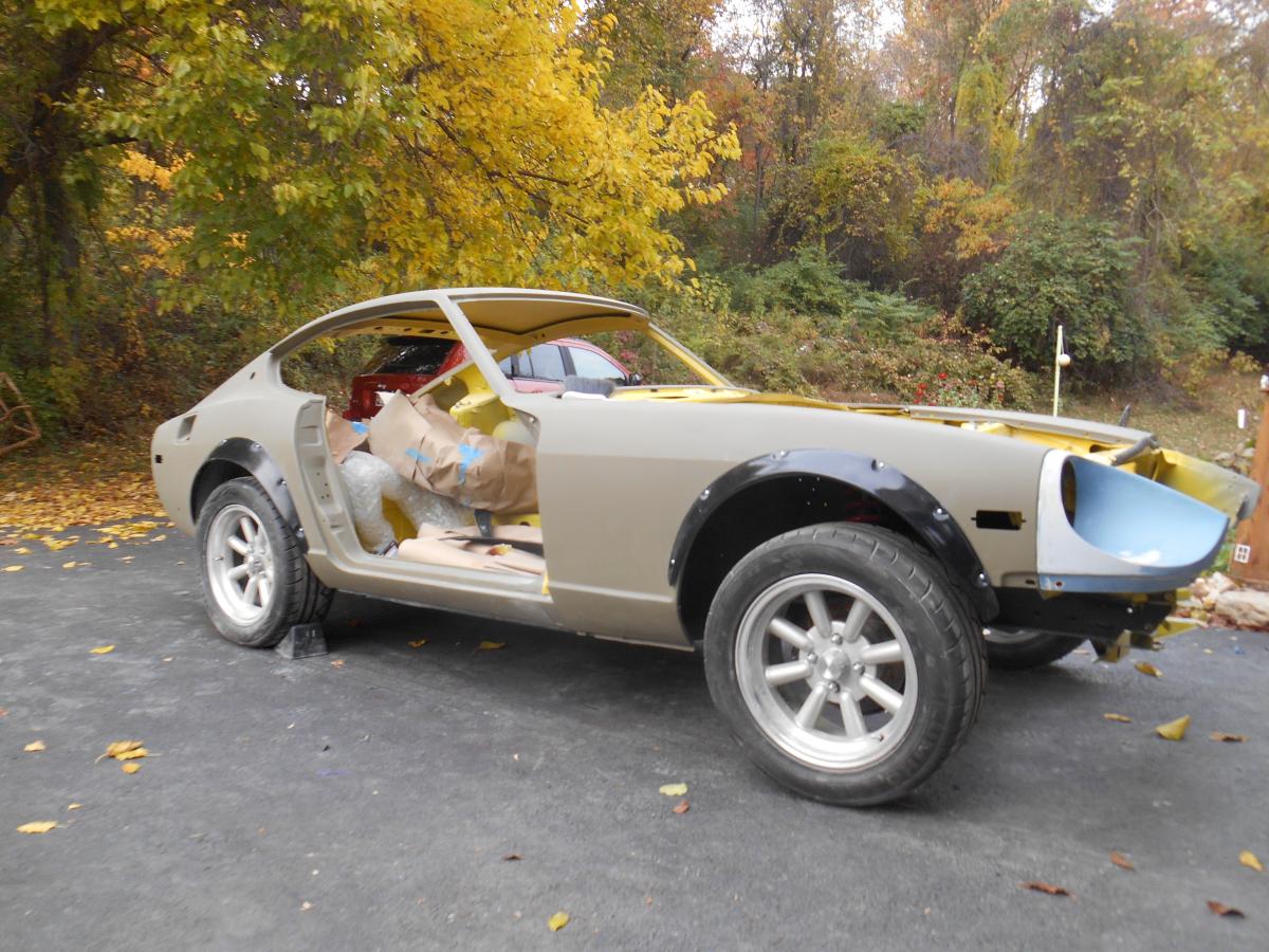

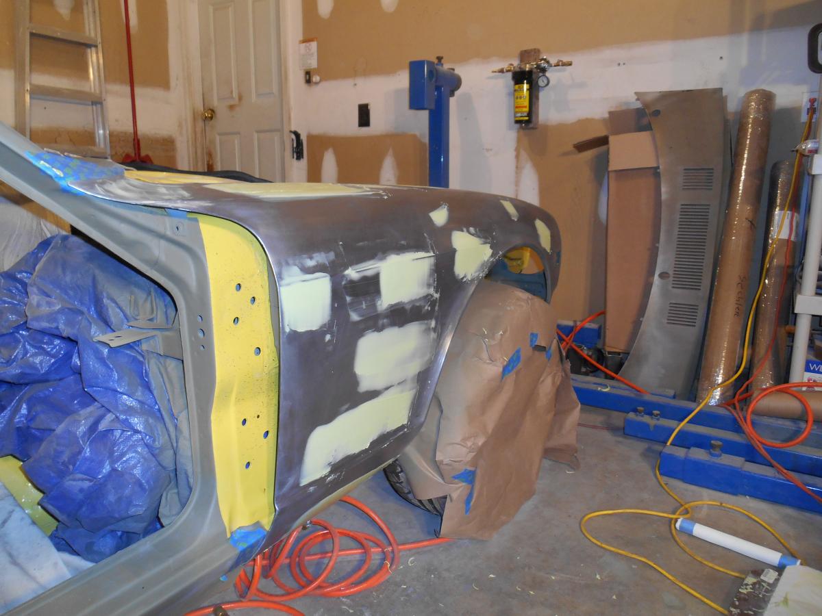

Anyway, here are some pictures of front fender work.  Both front fenders were in very good condition and required very little help except taking off the ugly dealer trim strips and welding the holes closed.
post-22075-0-26265000-1448845558_thumb.jpost-22075-0-16093900-1448845564_thumb.jpost-22075-0-30061700-1448845570_thumb.jpost-22075-0-17340800-1448845576_thumb.jpost-22075-0-27786200-1448845582_thumb.jpost-22075-0-41929200-1448845588_thumb.jpost-22075-0-47081800-1448845594_thumb.jpost-22075-0-39641800-1448845600_thumb.jpost-22075-0-56327100-1448845606_thumb.jpost-22075-0-62070400-1448845612_thumb.jpost-22075-0-72974100-1448845627_thumb.jpost-22075-0-89487100-1448845633_thumb.jpost-22075-0-02636400-1448845640_thumb.jpost-22075-0-19599700-1448845646_thumb.j

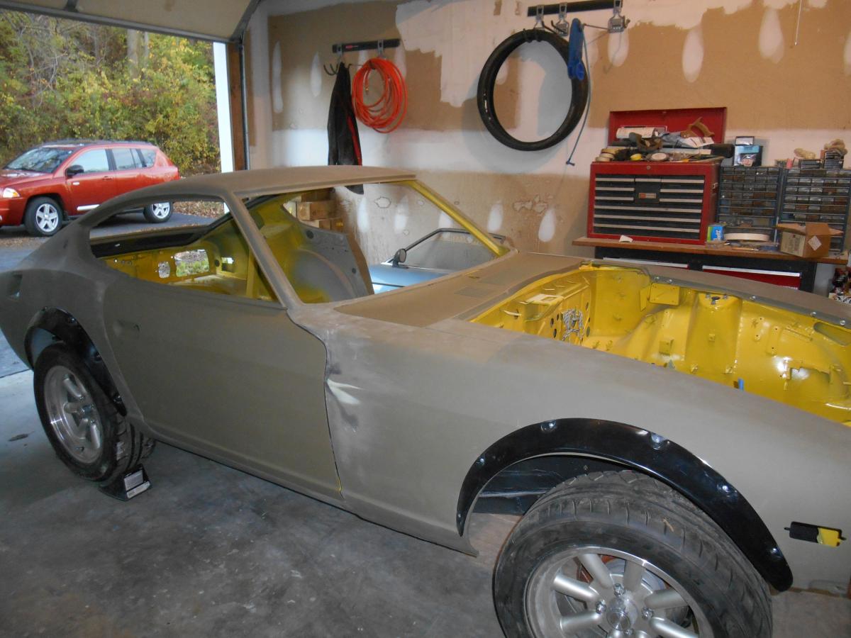

Here's the finished product.  Don't worry about the flare.  It's on wrong and I have corrected the problem.
post-22075-0-31086700-1448845652_thumb.j

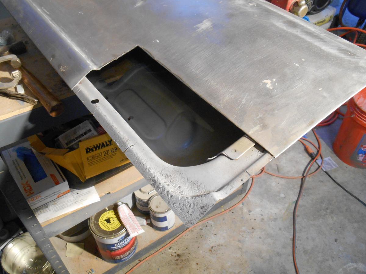

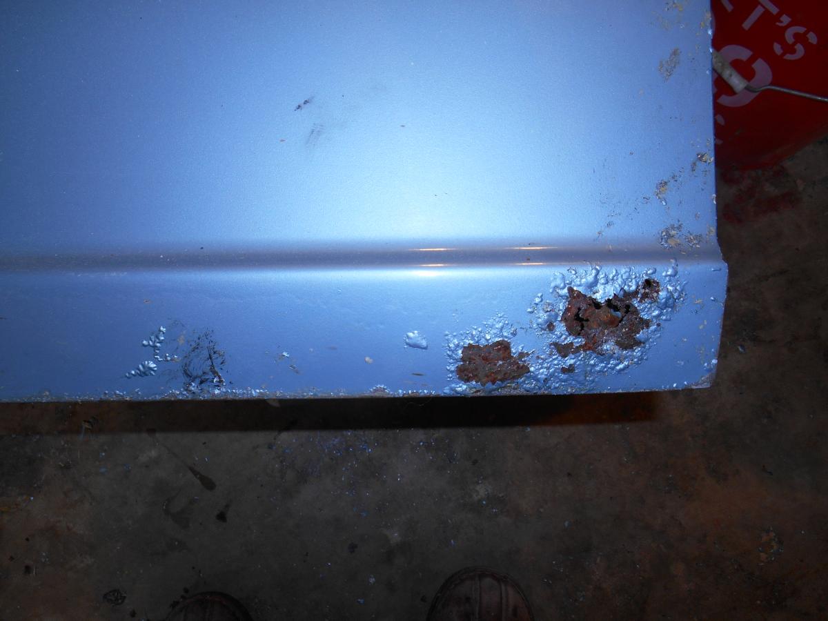

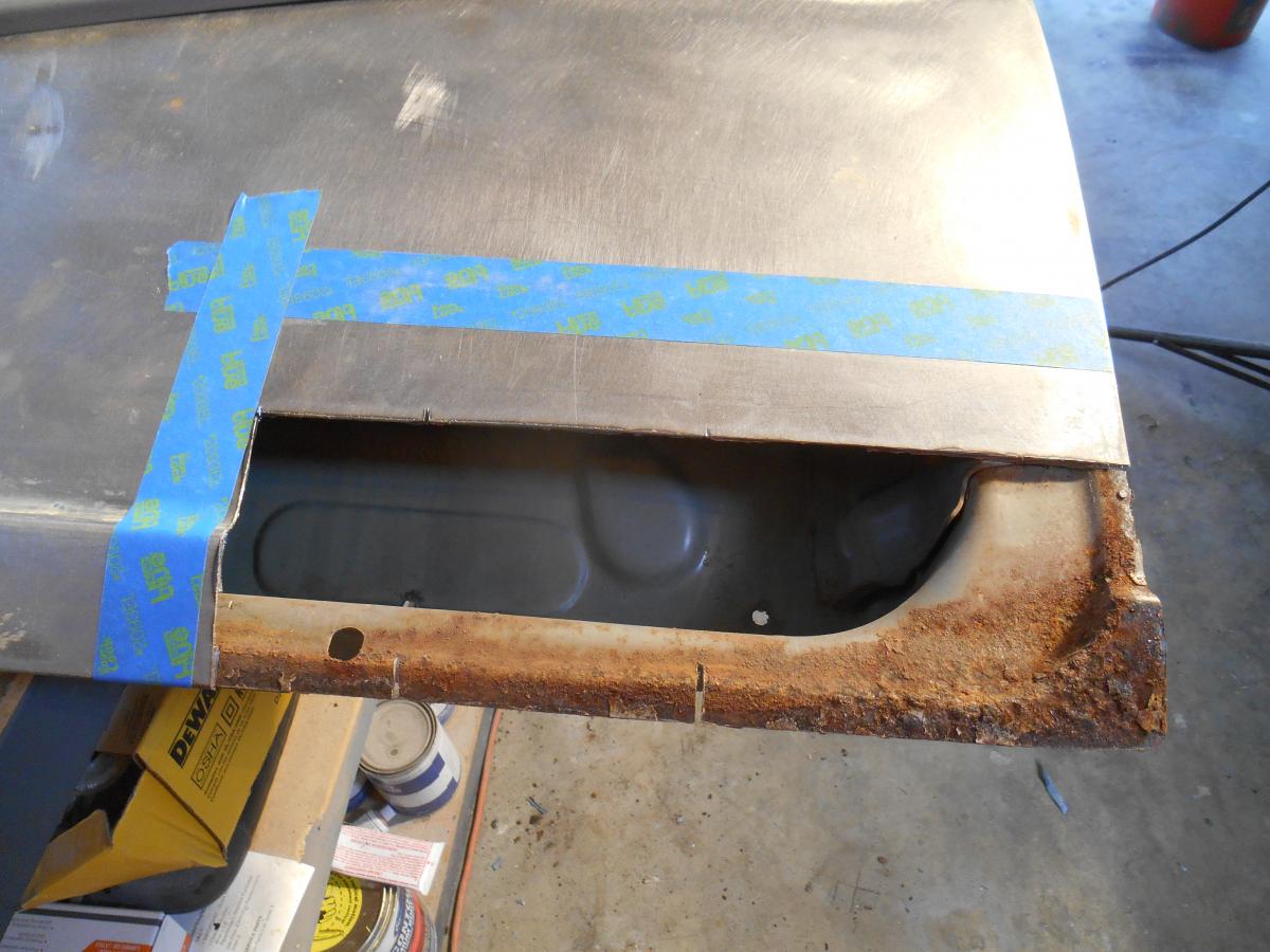

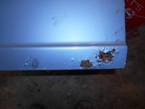

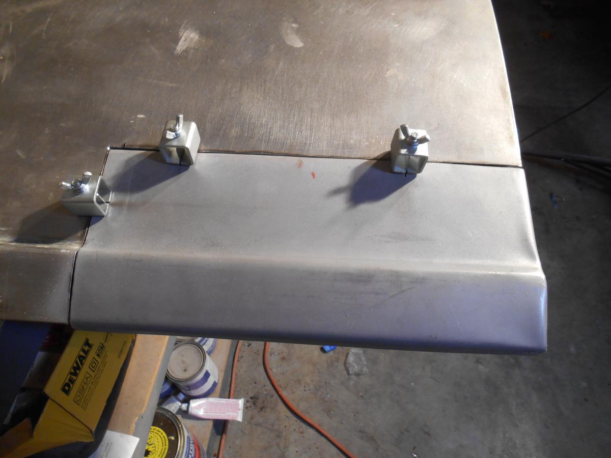

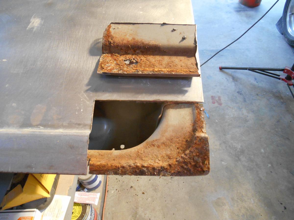

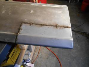

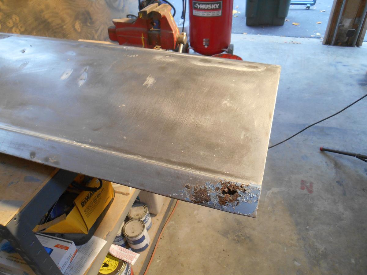

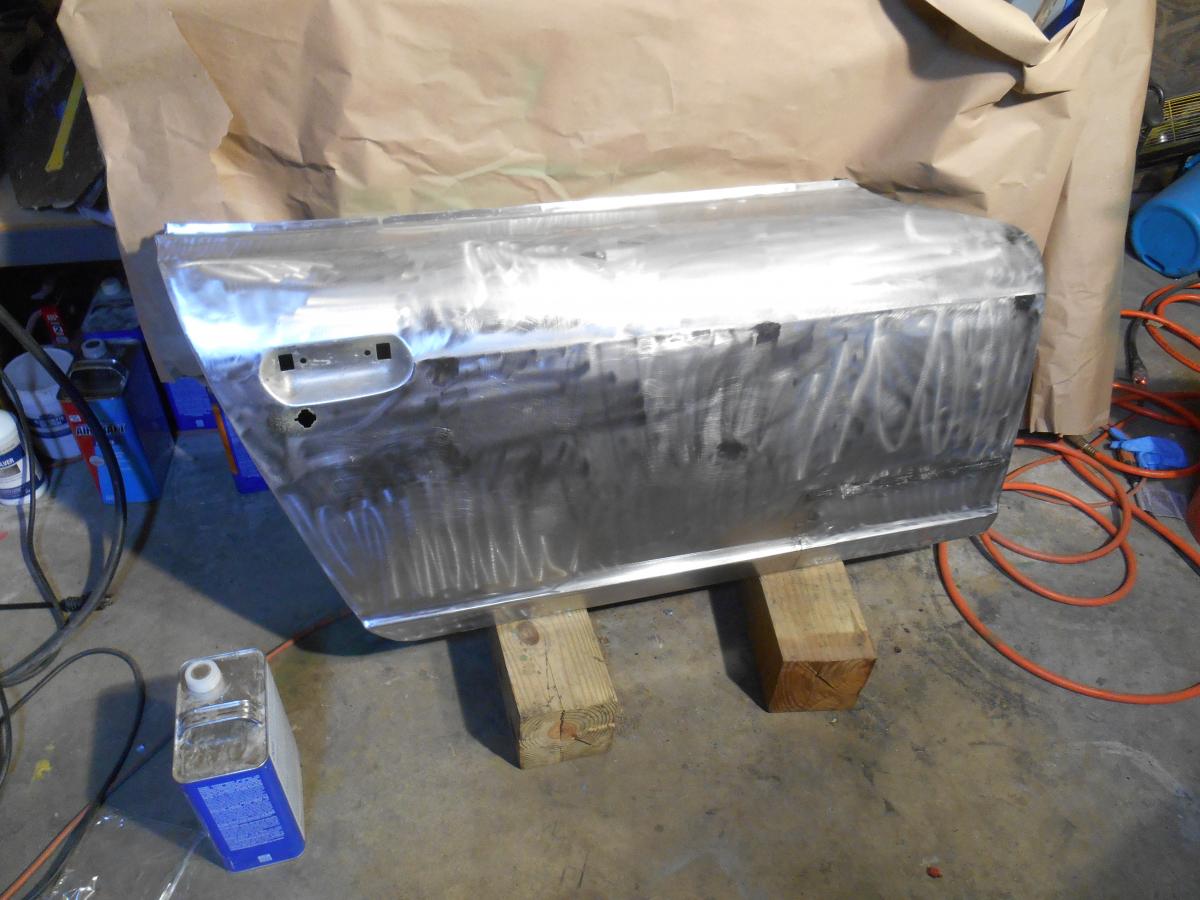

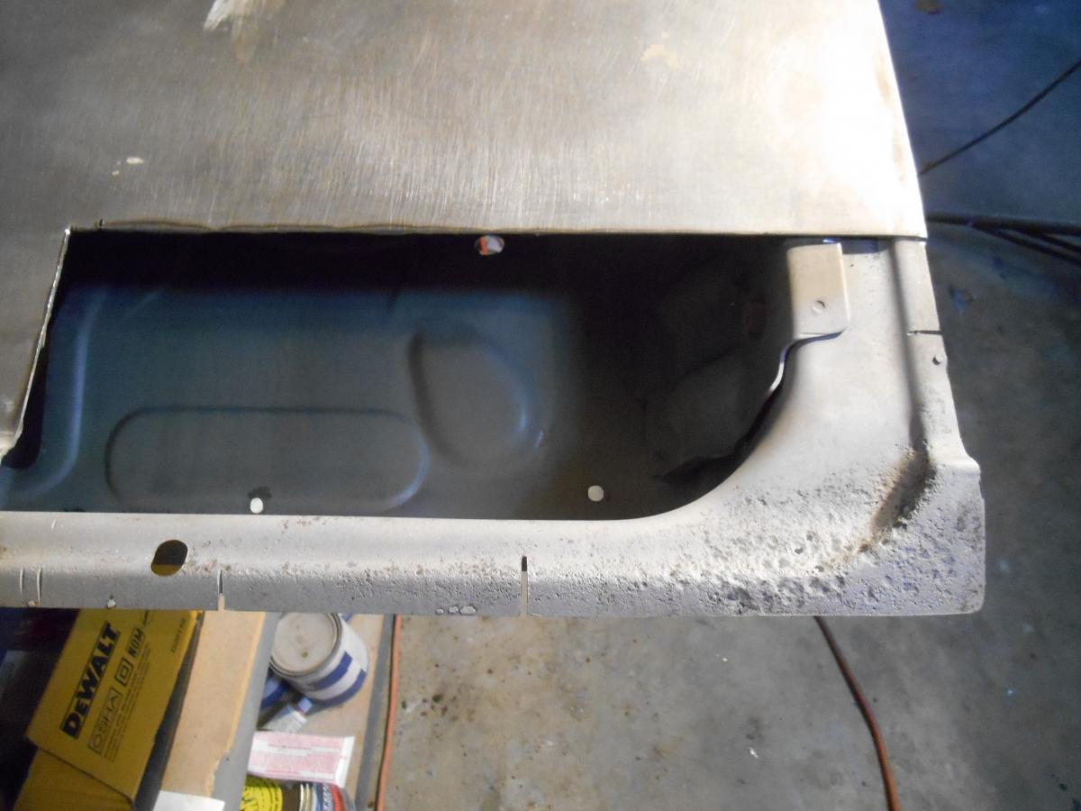

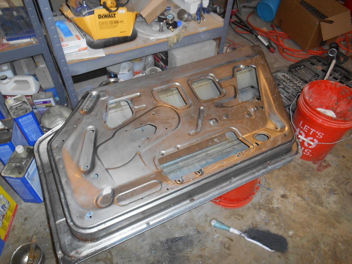

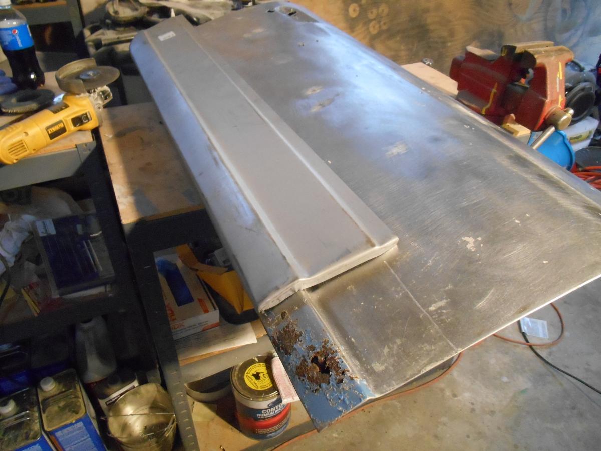

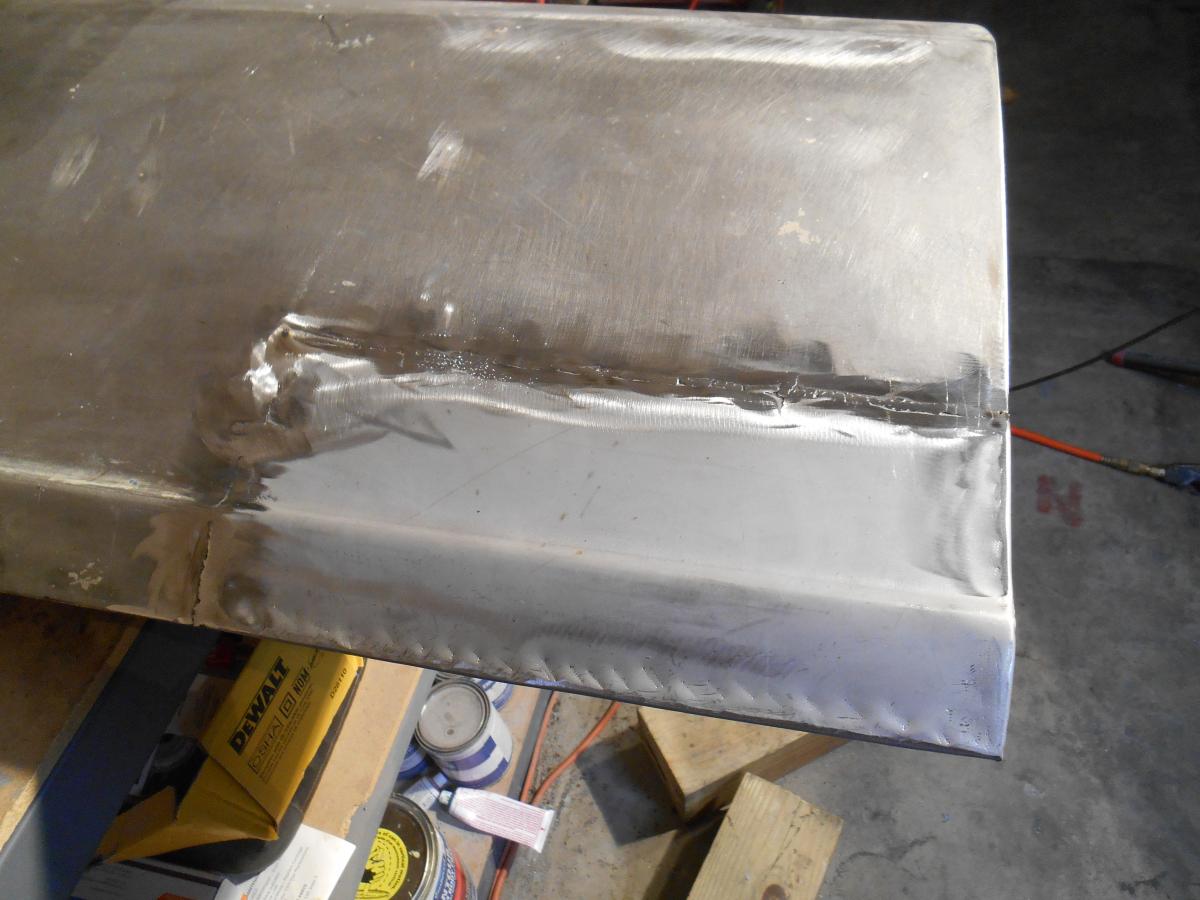

One more post for today.  This is a rust repair on the passenger door.  I have started to slip and didn't take as many pictures as I meant to.  I used a lot of filler before I primed the door.  Nothing too thick just a lot of fill, sand, fill sand, until I felt like I have covered most of the door.  That one was a little rough.  By contrast the driver's door which I am working on now is almost perfect.
post-22075-0-84889200-1448846104_thumb.jpost-22075-0-00151100-1448846111_thumb.jpost-22075-0-20551700-1448846117_thumb.jpost-22075-0-29280500-1448846123_thumb.jpost-22075-0-43113700-1448846129_thumb.jpost-22075-0-67479900-1448846135_thumb.jpost-22075-0-79488700-1448846141_thumb.jpost-22075-0-86478600-1448846147_thumb.jpost-22075-0-03545200-1448846154_thumb.jpost-22075-0-07666400-1448846160_thumb.jpost-22075-0-19808800-1448846175_thumb.jpost-22075-0-31969900-1448846181_thumb.jpost-22075-0-51253600-1448846187_thumb.jpost-22075-0-58837300-1448846193_thumb.j
You made a good patch on the door. Did you use a dolly and hammer to roll the seam? Also on repairs like that you can take some Eastwood frame rail sealer and shoot it down in the inside of the door. It is very thin and will run down into that seal to help prevent rust and stop the rust in the remainder of the seam from spreading.
Yes, I used a dolly and hammer to roll the seam but I did kind of a sloppy job.
...I've gone through about 10 cans of the Eastwood frame sealer.  I've sprayed it inside everything including the doors (after welding).
